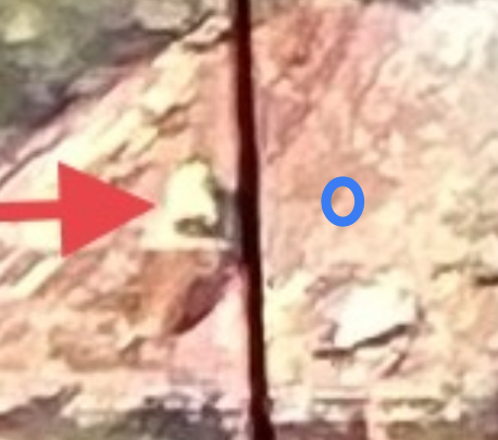

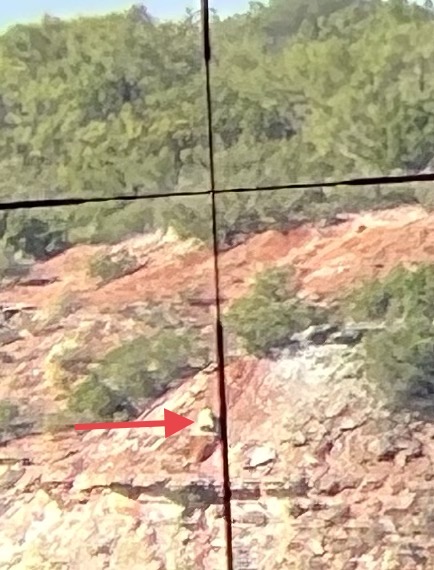

Testing this SPR model feasibility with Leupold VX5HD 2-10x42 duplex reticle.
Had this menacing rock at 905yds. 19.46Tx12.96W” Elevation I was shooting water line all 20rnds, but wind correction was put into inches and I bracketed the rock width in my head and made the wind holds, blue circle represents the typical wind hold at the time. So I thought it a better to have some wind hashes. Lol Enter the Credo.
