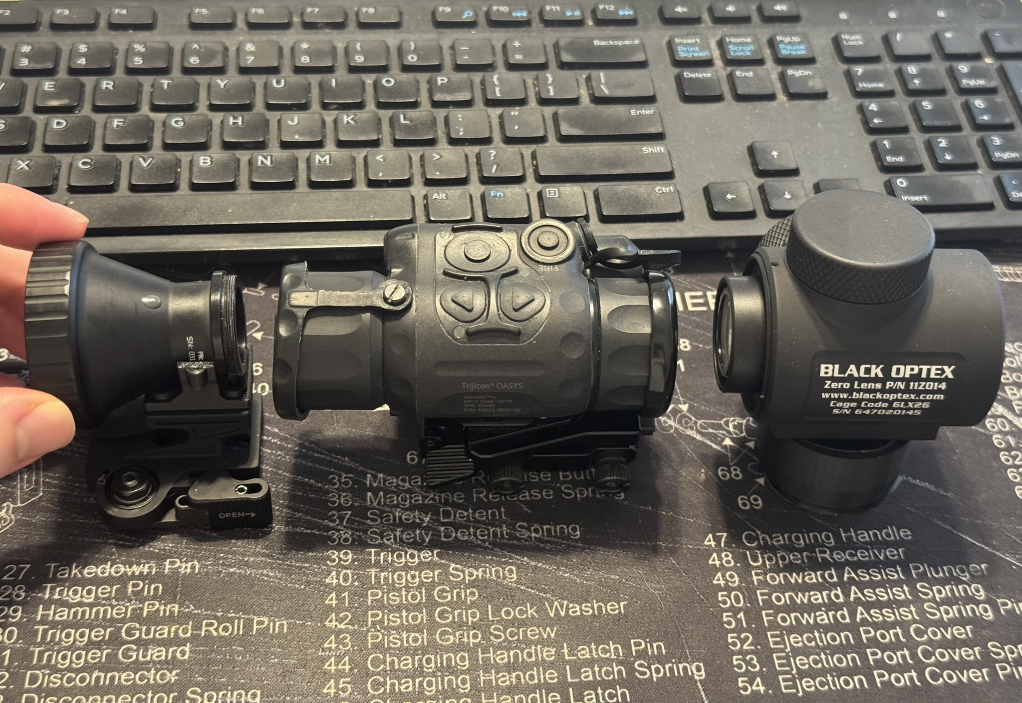

BurtG GOLDEN TICKET HOLDER Full Member Minuteman Nov 9, 2022 7,911 25,495 Northeast Today at 4:31 PM #2 Today at 4:31 PM #2 So you put a magnifier device in front of a skeet L and a way to zero it behind it ?

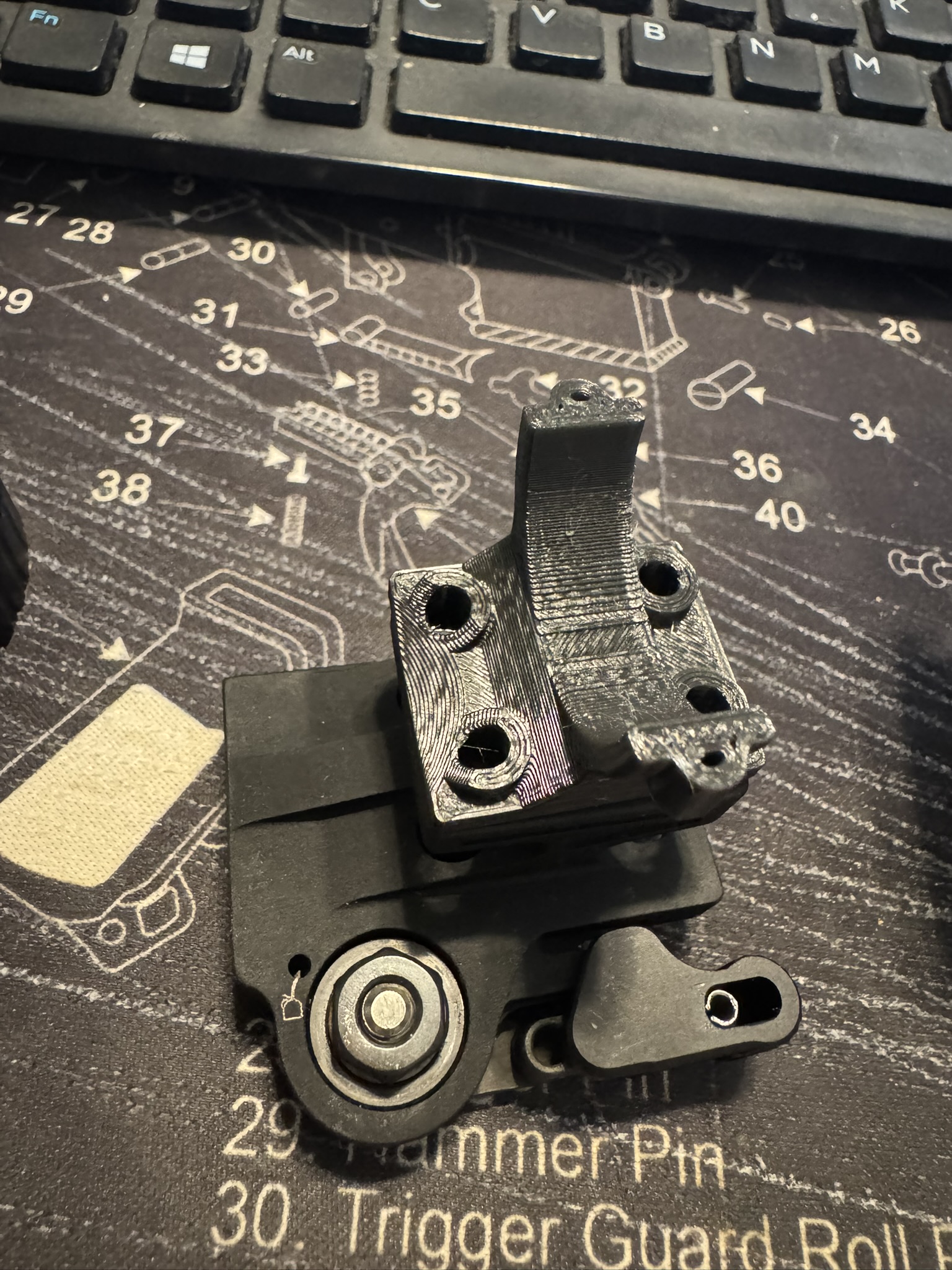

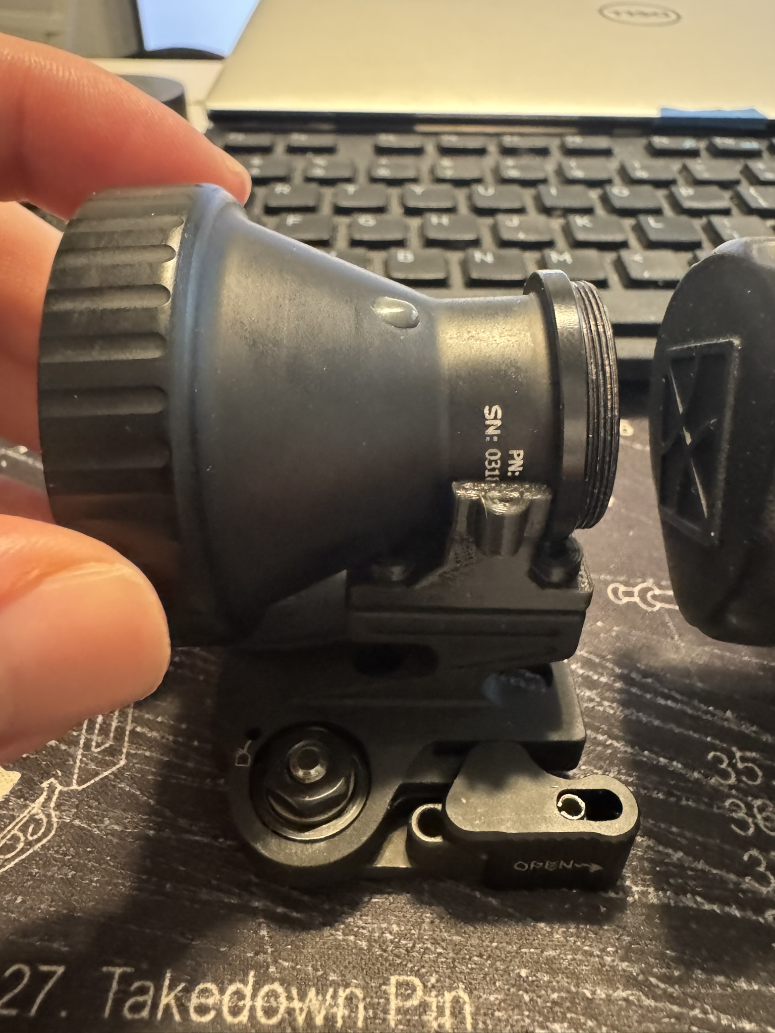

E EWS6 Sergeant of the Hide Full Member Minuteman Jan 27, 2019 290 257 Today at 4:52 PM #3 Today at 4:52 PM #3 its the mtm 3x magnifier. the black optex was made for a pvs14 but it has 3x demag and adjustments for collimation to correct for the magnifier. end result is net 1x like the utc so you can use a reticle or tracir Reactions: BurtG
