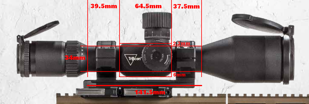

Does anybody have any experience in selecting a mount for this boat anchor?
Not sure which Spuhr (among others) mount's compatible...
I do have a 34mm Bobro cantilevered quick - detach mount which fits it fine, but I'm looking for a more permanent fixture.
Also, in looking at a couple mounts, the regular Spuhr mounts won't fit as the saddle is a hair too long. The AI factory mounts and obviously individual rings will work just fine.

Spuhr SP-4803B
"This Spuhr scope mount was specifically designed for applications where a wider ring gap is required to accommodate scopes with larger/longer erector housings. Examples included the US Optics TPAL and Nightforce BEAST."

Did get to message Hakan himself on this a looong time ago…
…there are no Spuhr mounts compatible with this scope.
