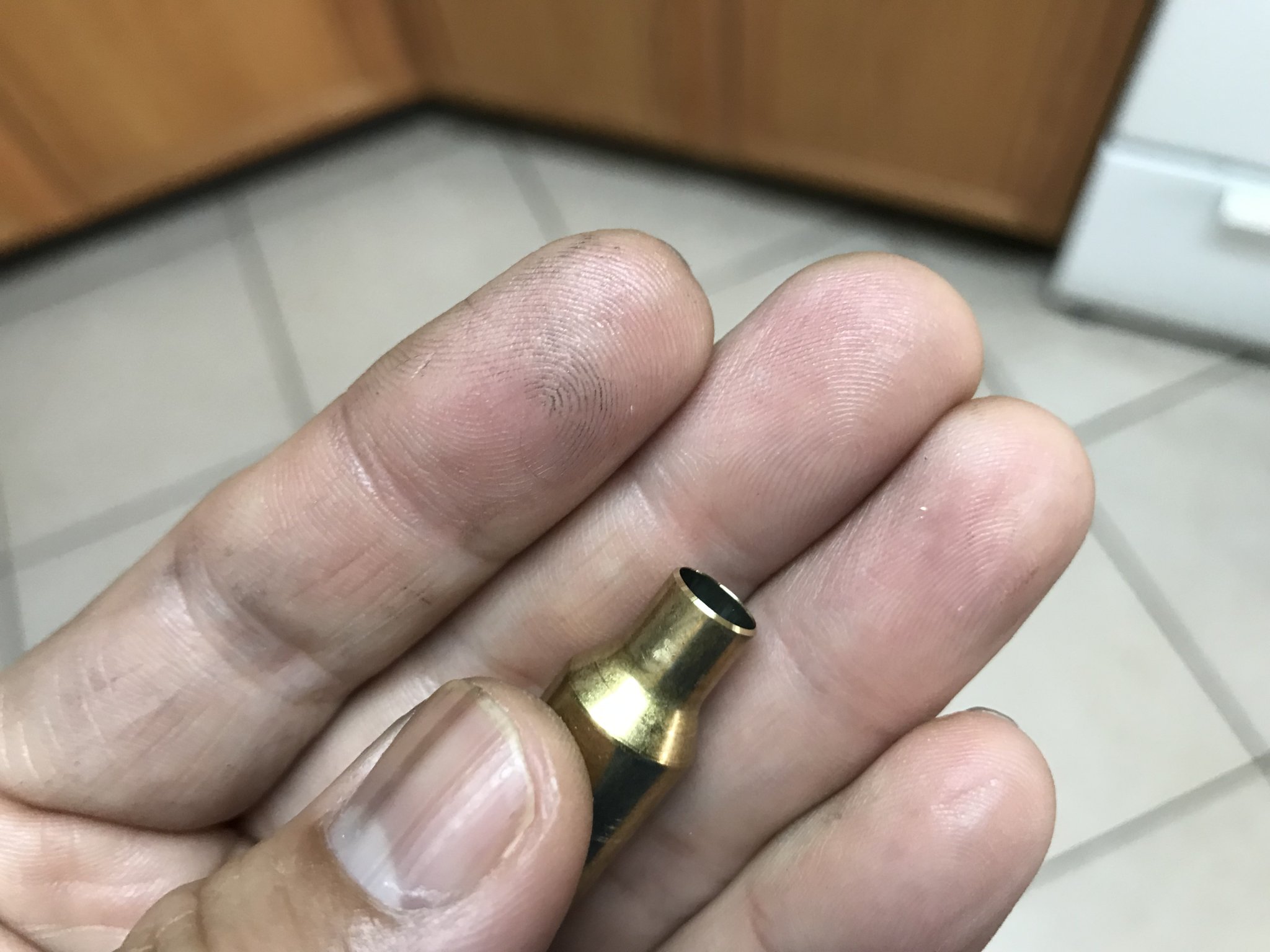

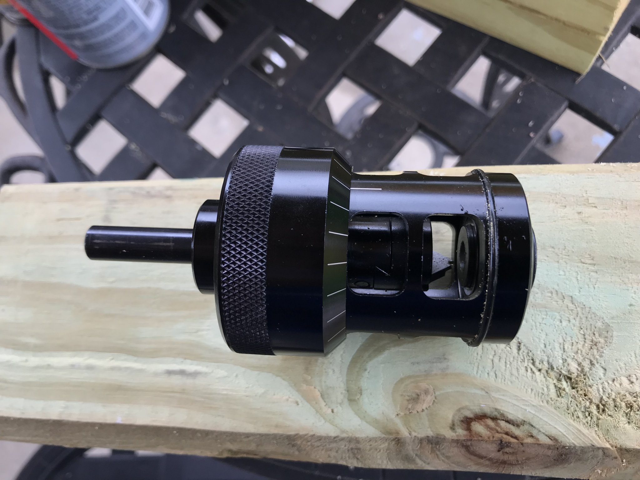

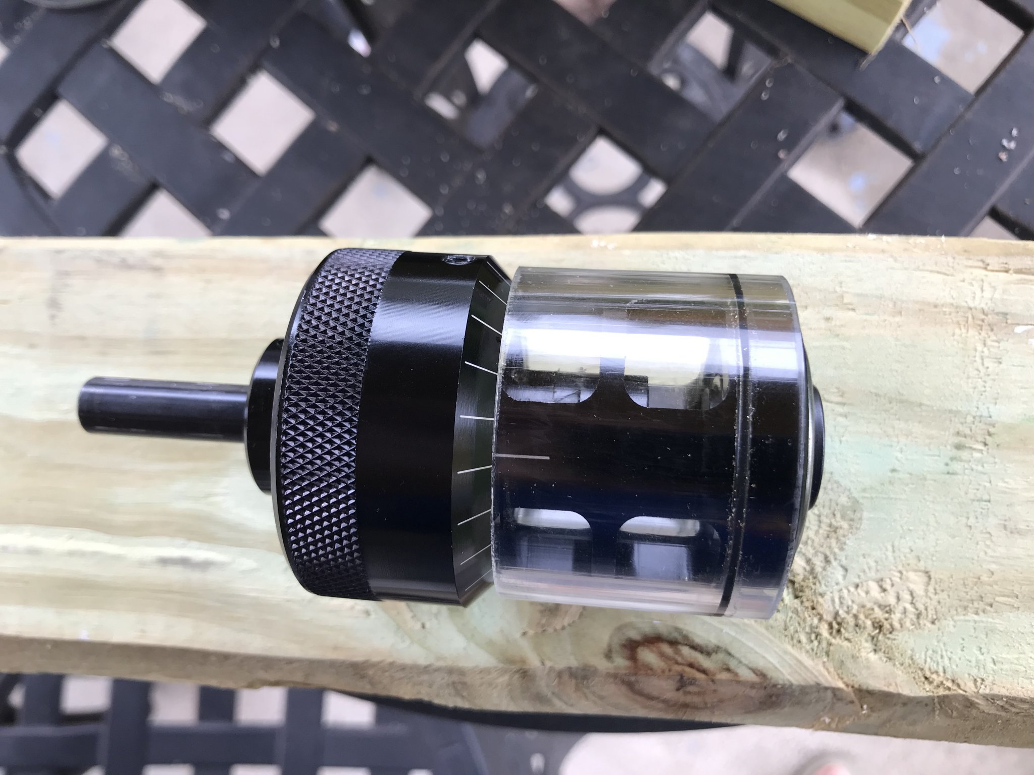

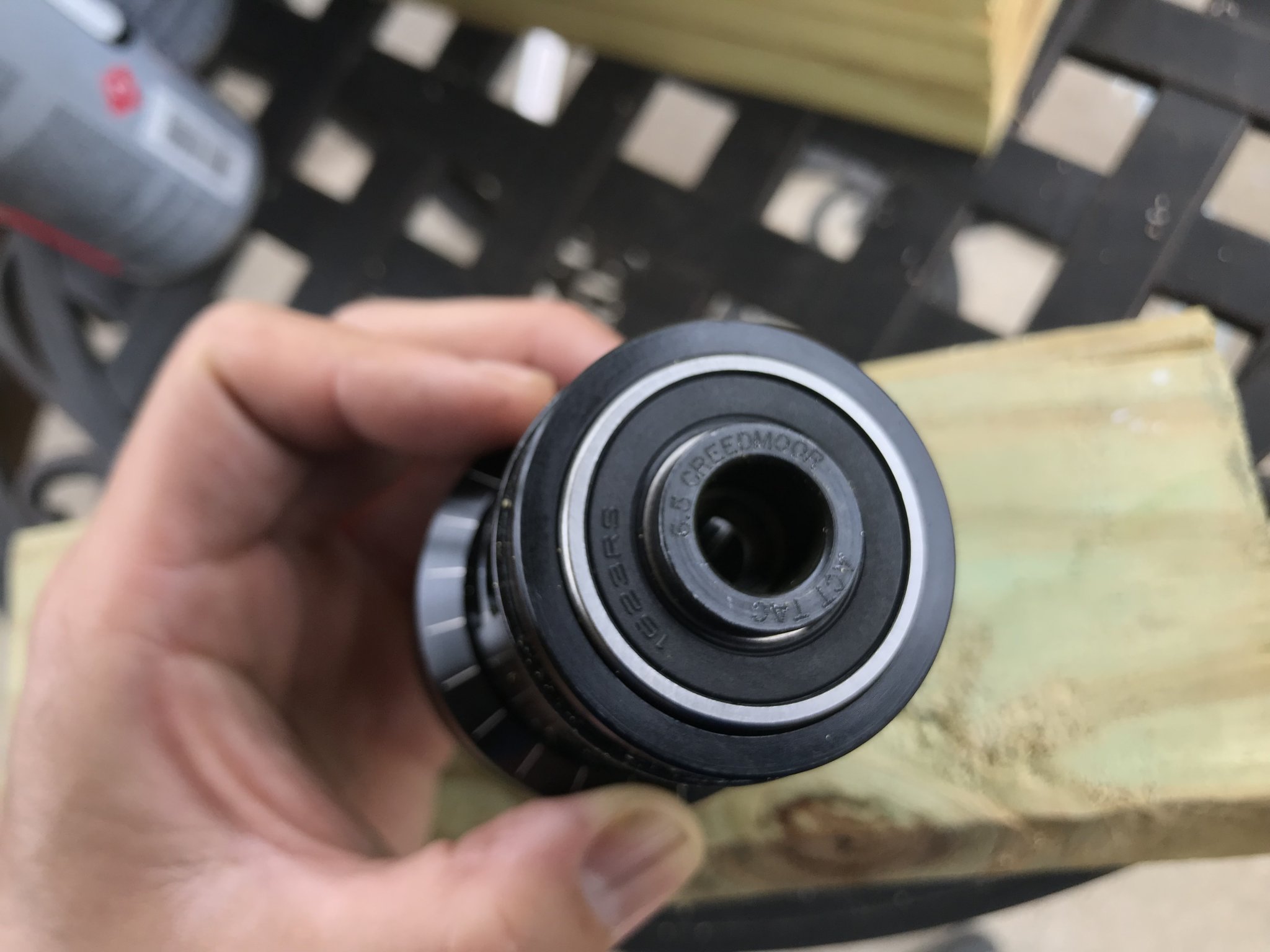

Picked up a Trim-It II from Brownells for their return policy just in case it didn’t work out. I read the reviews and they were almost split. Some didn’t like it and some never had issues. Anyway I was tired of hand trimming.
Got the trimmer in yesterday and it took a little time to set up. So far so good. My target length for 6.5 Creedmoor brass is 1.915” and I set up the trimmer to just about that length to the best of my abilities.
Here are the measurements with 8 pieces of resized Hornady brass trimmed back to back with the Trim-It II using a hand drill. Just FYI the shank is 3/8” so it can be coupled to a bench grinder with the right adapter.
1.9155
1.9160
1.9160
1.9155
1.9150
1.9150
1.9150
1.9145
So I would say it’s not bad and works so far. I don’t weight sort my brass or do anything else special. Just resize and trim. The deburr is nice and the chamfer on the inside isn’t bad at all.
