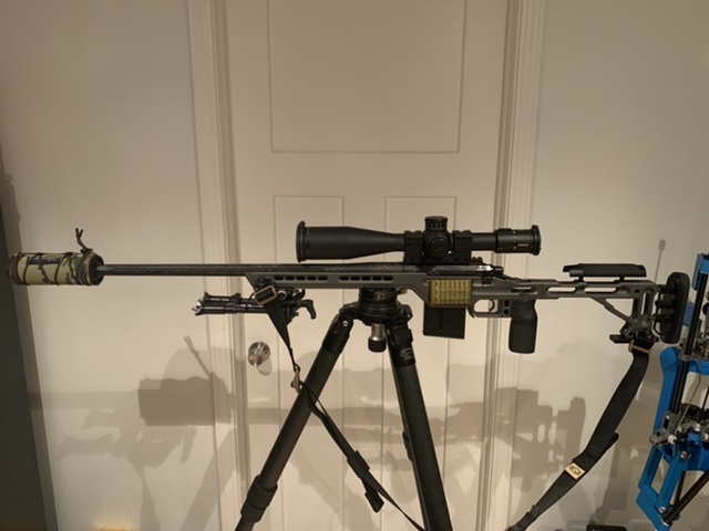

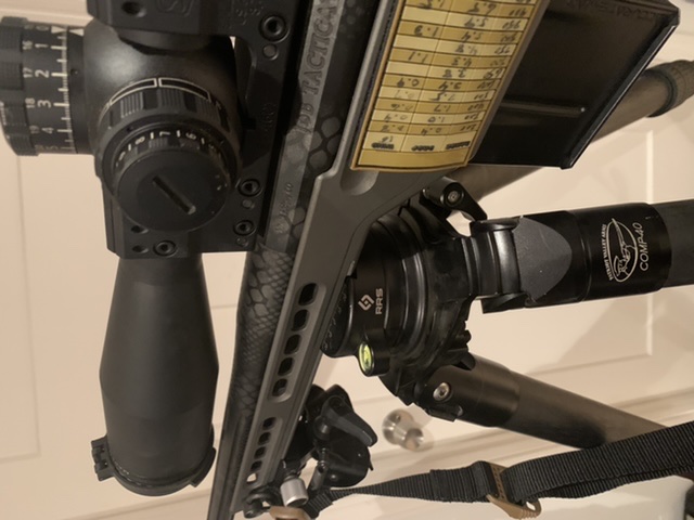

I have the PVA-40 w/ a RRS TA-3 leveling base. It works very well for me
edit to add pics
Another recommendation for the TA-3 leveling base. Greatly lowers your center of gravity to alleviate any "floppiness" on top of the tripod. You are limited to 30 degrees of total leveling, however. Anything more than that, and you will have to adjust the legs to compensate. I've never found a situation that necessitated more than 30 degrees, but YMMV.

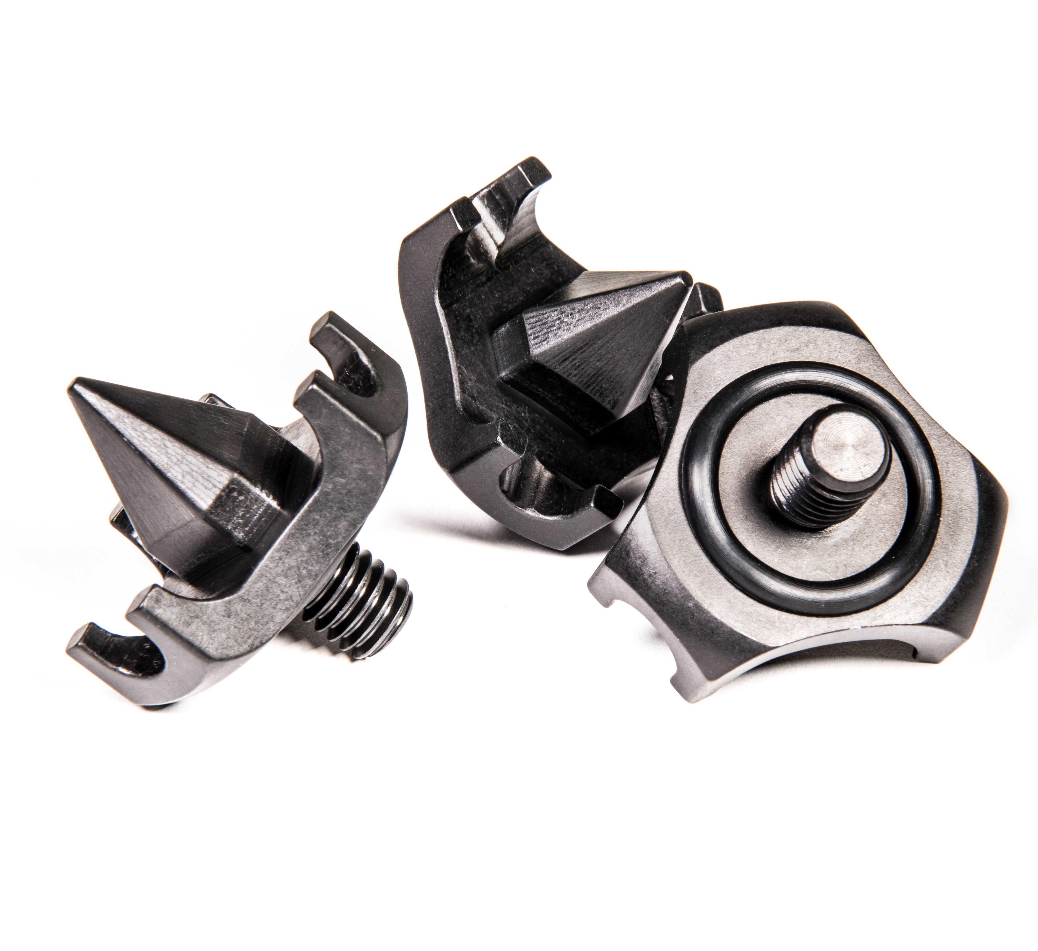

I should also mention the 406bullets claw feet are for RRS but work on the PVA-40 as they both have the same thread pattern. Also, it appears 406 bullets has changed their URL they are now Old Balls Inc -

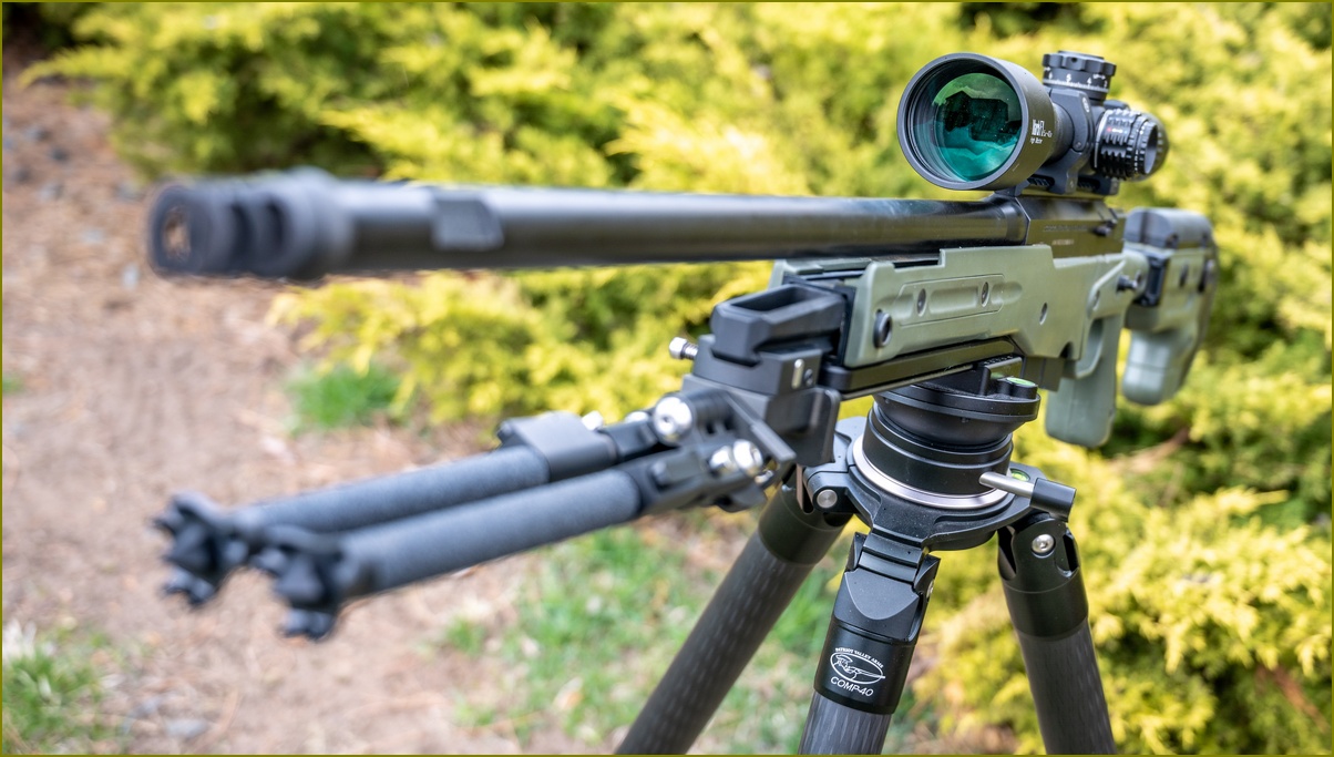

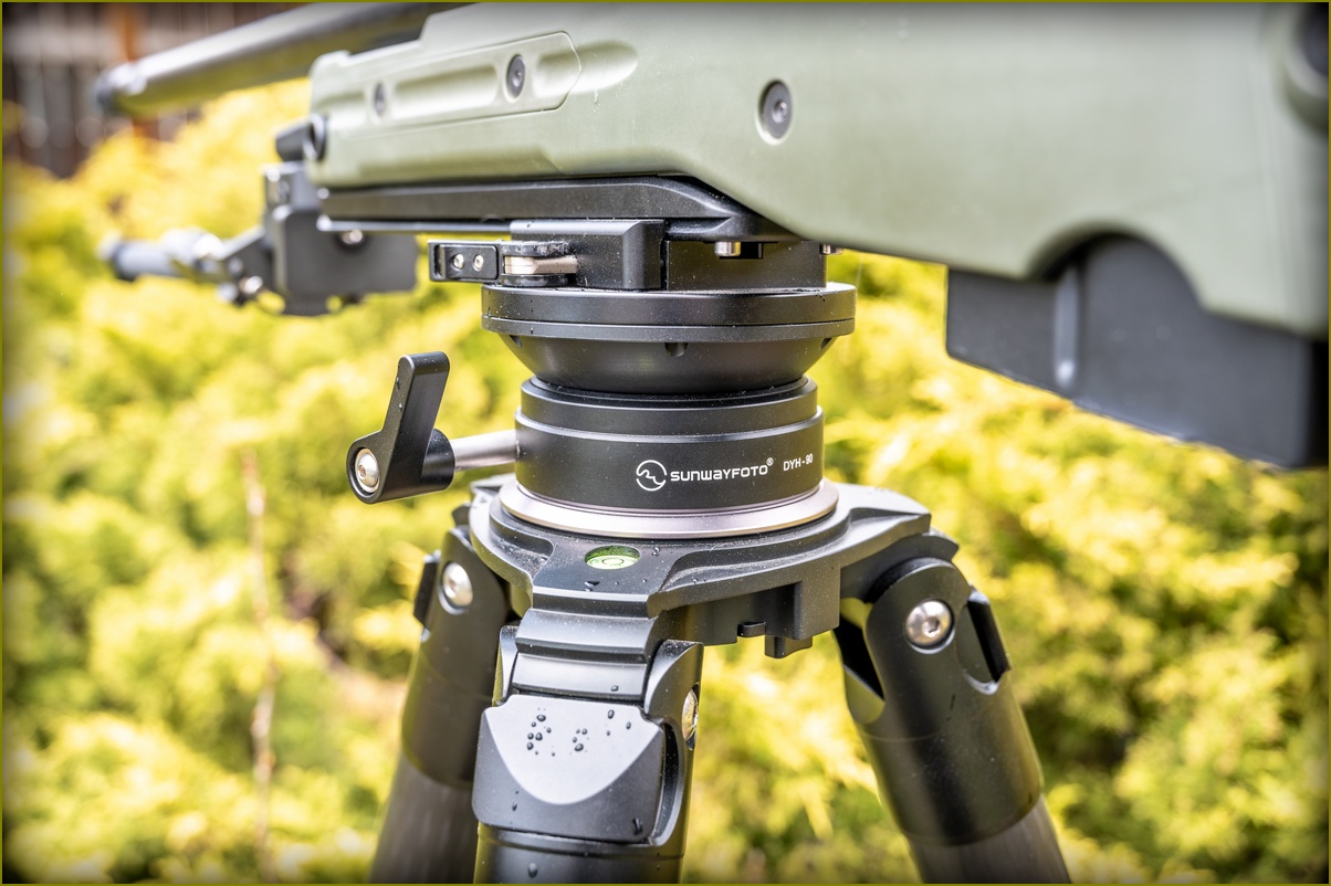

The Sunwayfoto I purchased from Fred at Bison Tactical, a Hide sponsor @Fred @ Bison Tactical - he is great to work with, very knowledgeable in the sport
Here's some eye candy
