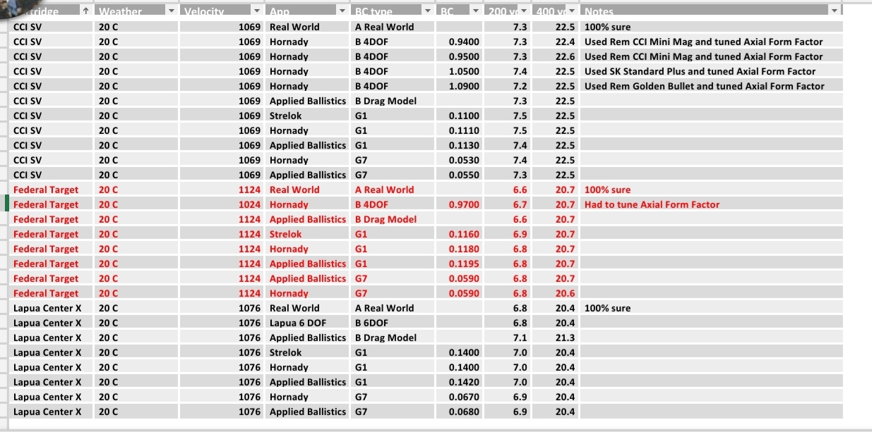

I tried kestrel with ab, ab mobile, strelok pro, and hornady 4dof. All were off and could get every yardage lined up. What I ended up doing was using ab mobile i have a profile for 0-100y and a 100-300y profile. Thats the only way I could get the dope across the board to line up perfectly. Doing this worked great yesterday..took 4th at a match and cleaned a stage out to 300y on prairie dog size targets

My predicted DOPE from ColdBore @ 200 yards is given as 8.6 Mils and my true DOPE is ~8.8 Mils. I can't ask for better correlation from a projected result.

Did you check your velocity in the cold? I find center x is very temp sensitive. That could be the issue.
Custom drag models are generally better the G1 or G7 BUT they will not always work. The Applied Ballistics Lapua Center X CD in only good till 200 on the ammo I have and the Lapua app is good (I've only tested to 400) for the SK line as well. Note this is with my lots of ammo. This has also been the case with one of my fellow competitors.
If you are using bc based calculations typically you will have more accurate results with G7 over G1 if you are trying to true data out to 250+.
Unless you’re strapped for cash, the easy button is upgrade and use the dsf function.
You can basically just take 6 distances and tell the software what your curve is vs trying to manipulate it to match.
