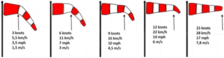

What to do when you can’t see splash? I was gathering dope today for my 16” Ar 15 zeroed at 100 yards shooting M193. I was using the geo ballistics app to get try dope and it’s math was accurate at 2-400yrds. When the wind wasn’t blowing I was consistently getting centered hits out to 400. There was an on and off 12mph wind all day. The wind holds geo ballistics was giving were accurate at 300 yards. My problem is, using their wind holds at 400 I was not making hits. The range is in Louisiana and it has rained the last few days. I could not see any mud being kicked up in my misses. I don’t have a windreader so just going off the 12mph the weather app said and reading the windsock, which was a little less than completely horizontal. Besides shooting continuously until I hit the target what is the best way to go about this?

An actual windsock should be 3 Knots/3.5 MPH per section. Your actual wind was closer to 15 MPH.

It may sound handy to have a wind sock right at 400yd. But it actually has the least weighting. Wind at closer ranges counts more.
