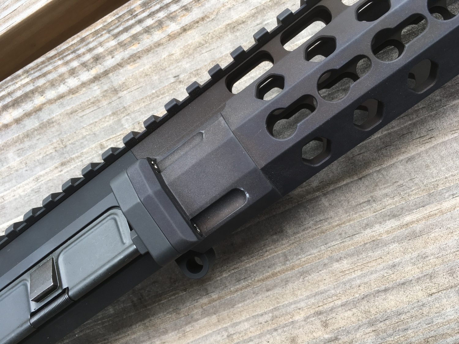

    One of them also told me the uppers like the Larue or Seekins that support the handguard separately are not needed either ?

    No not free float, a HG that removes pressure from the barrel nut. Like these:

    I personally would not bother, but I will say this the heavier billet uppers that use a proprietary barrel nut and handguard that bolts directly to the upper do seem to shoot more consistent than a typical forged upper. Especially cold bore.
    Truth. Why I like the POF design.
