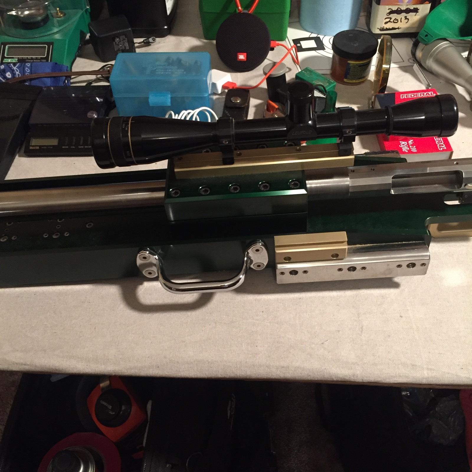

This is coming from Mark here and myself. Mark has tuners on his BR bag guns but no tuners on his rail guns. Most guys don't run tuners on the rail guns because of the weight of the barrel/rail gun the tuner would have to be so big and heavy is the issue.
A rail gun isn't necessarily more accurate than a bag/bench gun. Due to the weight of the rail gun and how they track your taking more and more of the human element out of the equation. It will help you for the longer strings of fire as well. In the unlimited class your shooting 10 shot groups where with the bench/bag guns your shooting 5 shot groups.
A tuner is best described this way (this is coming from Mark and I agree with him)... a tuner will not make the barrel shoot any better accuracy wise. That's in the barrel itself. A tuner will help by putting a weight on the end of the barrel give you a wider tune window as conditions change thru out the day. Some guys once they find that sweet spot on the tuner will lock it up. If something changes then they go back to the tweaking the load. Larry Baggett called it a dampener. It gives you a longer dewell time at the top and bottom of the vibratory whip of the barrel.
Below is Marks target he set the unlimited class world record for 10 shots at a 100 yards. The record still stands now since he fired it like 5 or 6 years ago.
Below is his rail gun.
So again I feel and I've said this before... a good barrel is a good barrel. You don't get around that. A crappy barrel is a crappy barrel. A tuner won't make the crappy barrel a better performer. So the vast majority of the time I'm against a tuner. Why? One less thing for me to mess around with. That's my opinion.
Later, Frank

Mark starts tighten the bolts on the barrel block to 40 inch pounds. He will go up in increments of 5 until he gets his smallest groups for vertical. Then he stops. He has gone up to 70 inch pounds but doesn't like going that high.
They've noticed on a 1.450" o.d. barrel in 6mm.....you get to 100 inch pounds or just before on that torque setting on the bolts and you start distorting the bore of the barrel!
