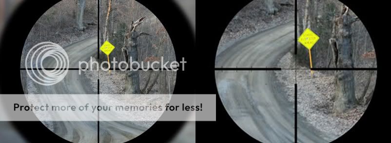

FOV simulation on 5x, no tunneling on the left (76 mrad FOV), tunneling on the right (53 mrad FOV). It's up to the individual whether this is a "non issue". If you don't dial below 7-8x, it certainly is, since you are not using the affected magnification range. If you need a good overview of the surroundings of your target, it very well may be an issue. After all, more FOV is the primary reason for using lower magnification in the first place.

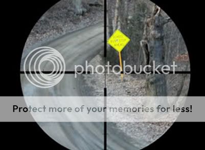

Here's an actual picture of a P4F at 5x
Re: Tunneling on 5-25 SB
Your image shows a FOV of ~55 mrad as far as I can tell. Published specs are subject to slight variations, and if the specs they are publishing are a little conservative in this respect, good on them.
The last time we went "round and round" on this, you posted the same picture and I told you that it only serves to cover up the actual effect of tunneling rather than show it. By taking a picture and cropping away the edges, you create the same image you would get at ~7,5x (only with slightly lower resolution, which is lost in web presentation anyway because of the low res of the camera/image).
What you are doing is this:
Cropping away the black "tunnel" part of the image and enlarging the cropped portion relative to what an image of a scope with bigger FOV would look like, completely removing any clues as to what the tunneling looks like.
Now a comparable image without tunneling would look like this:
Side by side:
Doesn't quite match when it comes to perceived magnification, does it?
These images are not comparable due to different cropping and different reproduction scale. This is why I did the original side by side, because that is the best way to really show what is going on, short of having the scopes in front of one's eyes.
Yes, there is more to a scope than tunneling or no tunneling, but this thread is about tunneling, and I thus think it is reasonable to show what tunneling looks like rather than purposefully <span style="font-style: italic">not</span> showing what it looks like.

David I didn't crop anything. I am, admitingly in many posts, not very good at taking pics through the scope. Yes there may be more black around the edges but the picture of what you can see is more important than more black.
No problem EH. I have been using an S&B 5-25 since 2006 so I have plenty of time behind the scope sending thousands of rounds down range. You won't feel handicapped by the tunneling from 7x down to 5x.

<div class="ubbcode-block"><div class="ubbcode-header">Originally Posted By: David S.</div><div class="ubbcode-body">FOV simulation on 5x, no tunneling on the left (76 mrad FOV), tunneling on the right (53 mrad FOV). It's up to the individual whether this is a "non issue". If you don't dial below 7-8x, it certainly is, since you are not using the affected magnification range. If you need a good overview of the surroundings of your target, it very well may be an issue. After all, more FOV is the primary reason for using lower magnification in the first place.
</div></div>
Wow, quite a difference.
I don't think that the effects of tunneling at low power can so easily dismissed as a 'non issue', given the noticeably larger, more useable & appealing field of view.
If a shooter never dials down that low, then it IS a non-issue. But for others who do, the difference is very relevant...
As was stated, shooters will decide that for themselves, but I'll take all the FOV at low power I can get. I'm not a big match shooter, but it doesn't take one to realize the advantage of having a wide field of view for acquiring & engaging close in or moving targets...
If one were to consider these two photos in a honest "blind taste test" poll, I can't see many shooters picking the cropped FOV as preferable, in & of itself? Obviously, there's more to the equation in deciding on a high end scope purchase than this comparison. But those photos are certainly worthy of consideration...
Thanks for the apples to apples comparison photos, David S.

<div class="ubbcode-block"><div class="ubbcode-header">Originally Posted By: knockemdown</div><div class="ubbcode-body">Thanks for the apples to apples comparison photos, David S.</div></div>
I will say again that these are not <span style="font-style: italic">photos</span> taken through the scope, this is a CAD/Photoshop job. It does show what is going on though, and if I had both scopes at hand I could probably take pictures to the same effect with some coniderable effort concerning camera positioning/alignment behind the ocular.
I know some people who don't like the result may like to point out that these are not "real" images so they don't show "the truth", but those people would probably also dispute the difference in overall length between scopes if they were only given CAD models. FOV is a cold hard fact and it can be measured and displayed just like length, weight and adjustment range of a scope can be measured and displayed comparatively.
I encourage anyone who isn't happy with these images to make a video like this one that shows the view through the scope while zooming from 25x to 5x with a fixed camera position behind the ocular.
<div class="ubbcode-block"><div class="ubbcode-header">Originally Posted By: EventHorizon</div><div class="ubbcode-body">David - is the scope on the right in your first post a S&B 5-25?</div></div>
See above statement, but yes, the pictured FOV on the right does represent the published value for that scope.

<div class="ubbcode-block"><div class="ubbcode-header">Originally Posted By: David S.</div><div class="ubbcode-body">FOV <span style="font-weight: bold">simulation on 5x</span>
</div></div>
Knockemdown those aren't photos but simulations. Mine was a photo but with the black around the actual sight picture not there. Not done intentionally but just the way the picture was.
Event, yes he was.
Understood, Rob & thanks to both you & David for clarifying. This was the 1st time I'd seen these images...
Ok, so they are not actual photos, but they are accurately representative of the measured difference in FOV between the two scopes on 5X?

<div class="ubbcode-block"><div class="ubbcode-header">Originally Posted By: knockemdown</div><div class="ubbcode-body">Understood, Rob & thanks to both you & David for clarifying. This was the 1st time I'd seen these images...
Ok, so they are not actual photos, but they are accurately representative of the measured difference in FOV between the two scopes on 5X?</div></div>
Well, they show one scope with a 76 mrad FOV and one with a 53 mrad FOV pointed at the same target at the same magnification. That is as good a representation of what the view through those scopes looks like as you will get on the internet.

Considering that, as long as the FOV values are accurately represented, it would seem that David's 'simulated' images offer a fair visual comparison to those who don't have two $3K scopes laying around...
Whether or not the tunneling effect & FOV difference (~23mrad almost 7 feet @ 100yds) between the scopes is considered a "problem" remains subjective to the shooter. That point could be argued back & forth ad-nauseum, but the measured FOV values speak for themselves...
