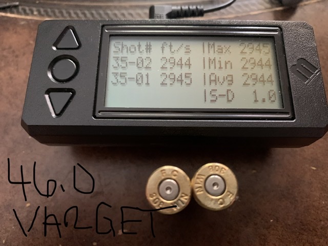

I start load development with a chronograph. I find a load with low SD numbers then I adjust seating depth to tighten up the group.
