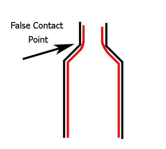

It's not an issue with the gauge being "calibrated". The issue is that your fired brass might be contacting the inside of the gauge somewhere else besides the shoulder. I personally doubt that you've got 21 thou of headspace on the chamber vs factory brass. That would be a major screw up.

Not necessarily and, as Sheldon described, with the wilson gauge you have no idea of telling.
The wilson is a elementary pass/fail. It doesnt tell you how much of what and/or where the issue is. You might not have .021 of stretch, it might only be .004 but some other dimension such as the base diameter could be causing the case to bottom out before its actually get fully into the gauge leaving all of that extra handing out the end. With that sort of tool you dont know, you are missing all of the other data necessary to accurately judge.
Thanks. Factory ammo gauges perfectly. If the gauge was off, I am thinking that the factory ammo would gauge off as well.
Not really an issue with either the gauge being off or the factory ammo being off. More of a potential issue of the shape of the brass coming out of the chamber not matching the shape of the case gauge giving you false readings. Here's a picture to explain the potential scenario.

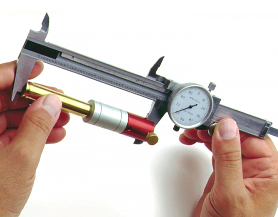

We like the hornady and sinclair comparators around these parts.
7055660
But the empty 9mm case will do in a pinch as well. Replace the silver and red part in that image with the 9mm case and you will have a makeshift .380 datum and you will have a way to compare the shoulder lengths from new>fired>sized with no other potential interference.
7055661
Reactions: Snuby642

You may get the same number you already have now with the gauge!
Its just nice to be able to know definitively that your measurement is what it shows and not due to some unseen interference. The gauges are worth the price for the confidence it instills in my measurements.
Also, take note that the numbers provided by the gauges arent absolute numbers, they very well might not match up to the saami spec charts or your neighbors measurements with their tool.
They are relative measurements, they apply to your set up only.
They have a chamfer on the inside edge so that the metal doesnt bite into the case and that leads to a bit of variance.
But they will allow you to directly relate your virgin, fired and sized cases to one another. Hence they are called "comparators" and not "gauges"
Edit: this post walks you though how the numbers youll get arent absolute but shows you how to justify them to absolute if you feel so inclined.

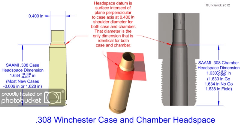

Thanks. Here is how I am measuring the headspace.
- I use a L.E. Wilson Case Gage with the Case Gage Depth Micrometer on a fired case.
- I believe this will tell me how much headspace above maximum (or below minimum) SAAMI spec of the fired case
As I understand it, headspace on the 6.5 Creedmoor, a bottleneck cartridge, is the distance from the face of the bolt to the datum line on the shoulder of the cartridge (at 0.400” diameter). The Wilson case gauge uses this datum line.
Pointed out was that the Wilson gauge may not be letting the cartridge fully sit against the datum point, so actually I may be getting a false, overly long reading. Perhaps this is where the Hornady comparator will be superior, as it looks like there would be no interference on the body or shoulder of the case.
Does that sound right? Or I am misunderstanding something?
