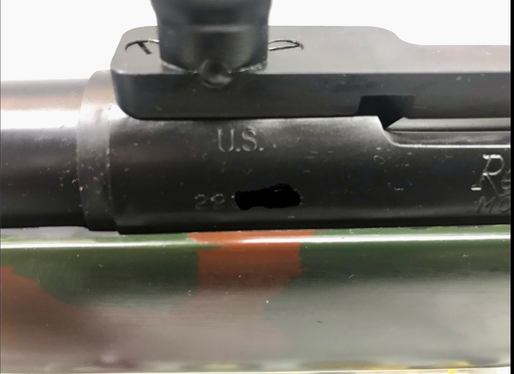

@Frank Green that US stamp seems a bit high to me? I know neatness and uniformity for these markings were not the most consistent back in the day, but aren’t they normally lower or more centered vertically between the serial number and the bottom edge of the scope base?
See one of my GAP stamped M40A1 actions:

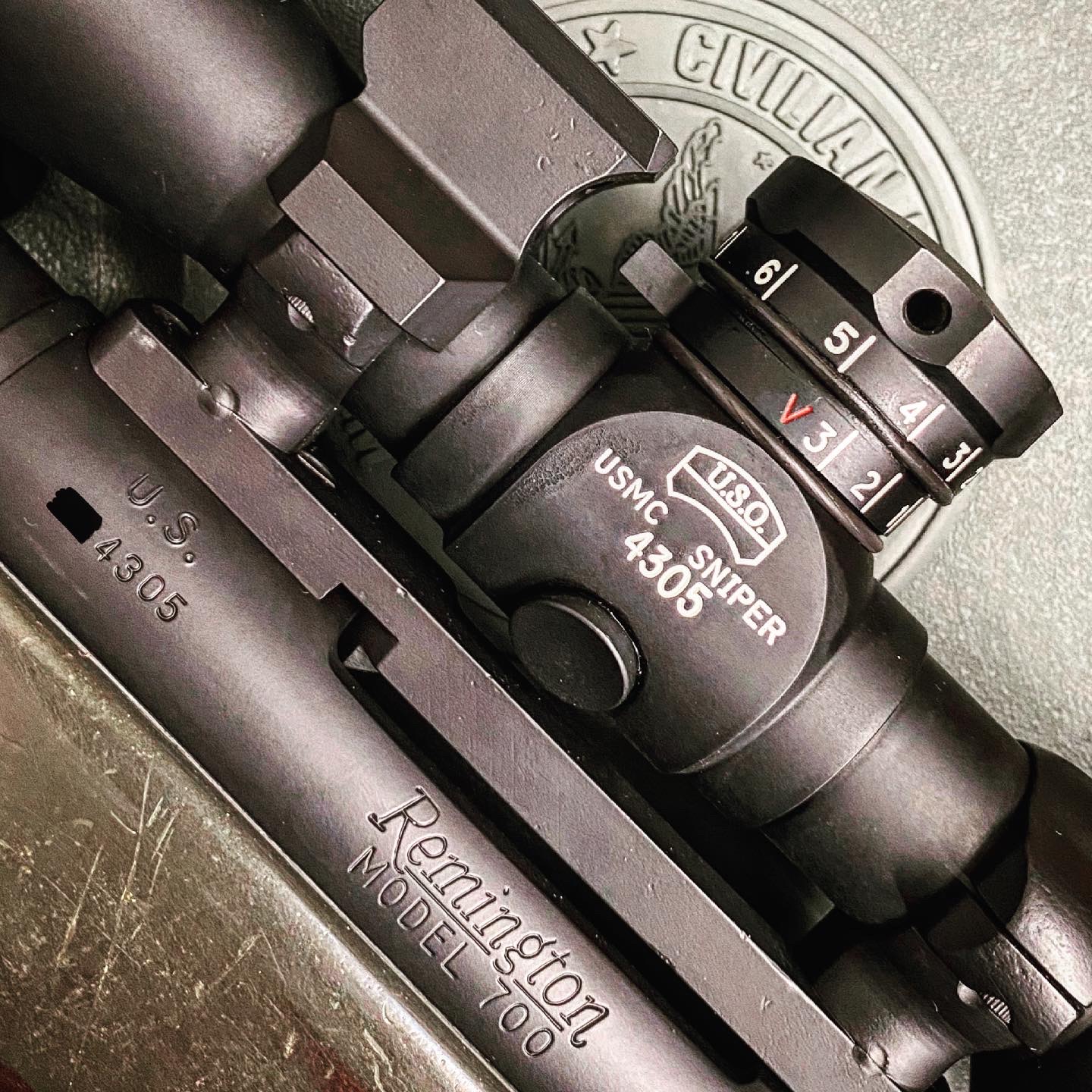

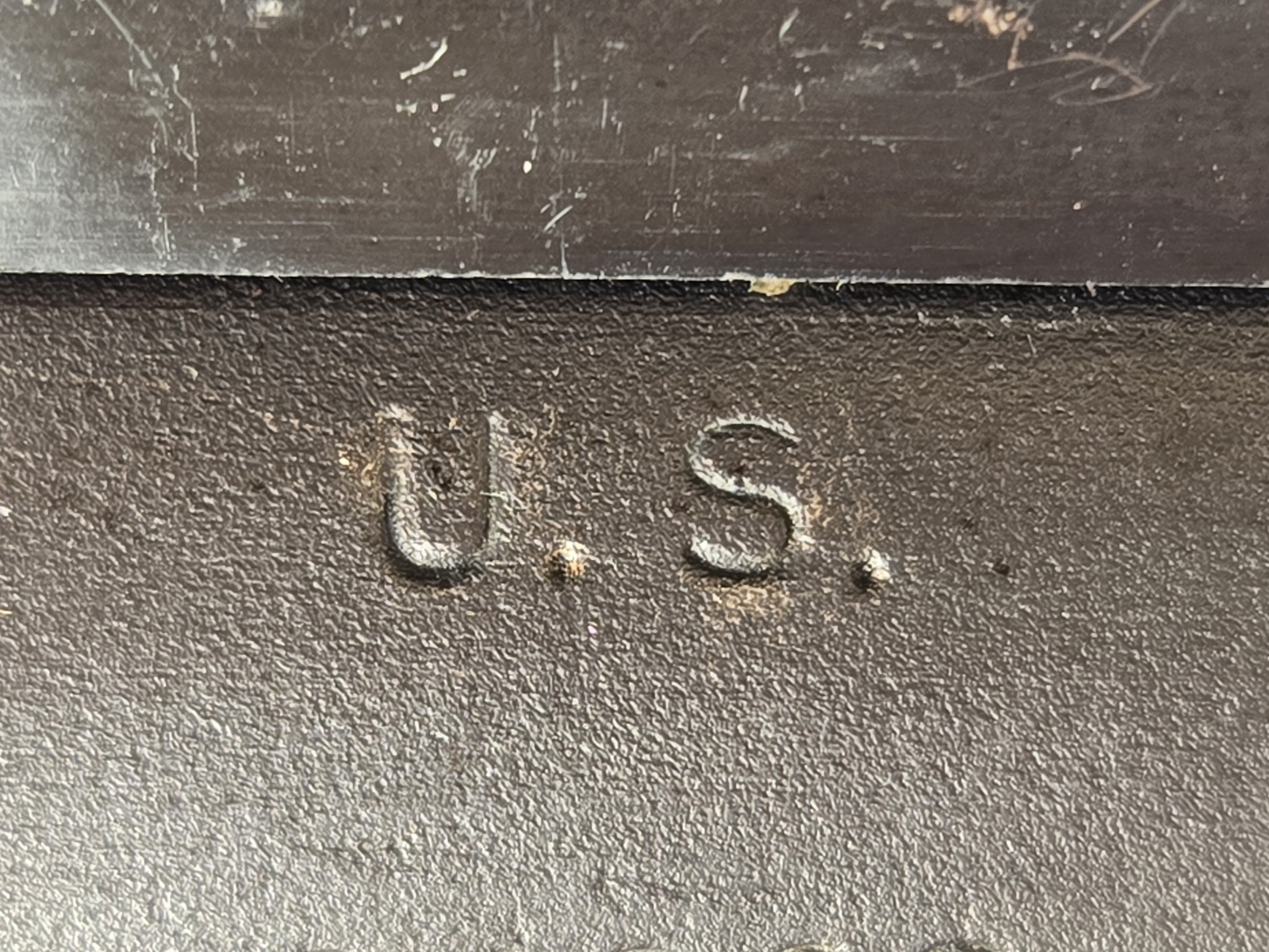

I found a local gunsmith who did laser engravings and I provided all the measurements and this is what we came up. The only catch, he accidentally didn't save the file. :( So it's gone. If we did it again, we would unfortunately be starting from scratch.
This pic was right after it was sandblasted and the receiver was still in the white. I then parked it and painted it to match M40A1 parts. I don't have a pic of it done but it turned out really nice.
Top rifle is a legit M40 stamp.

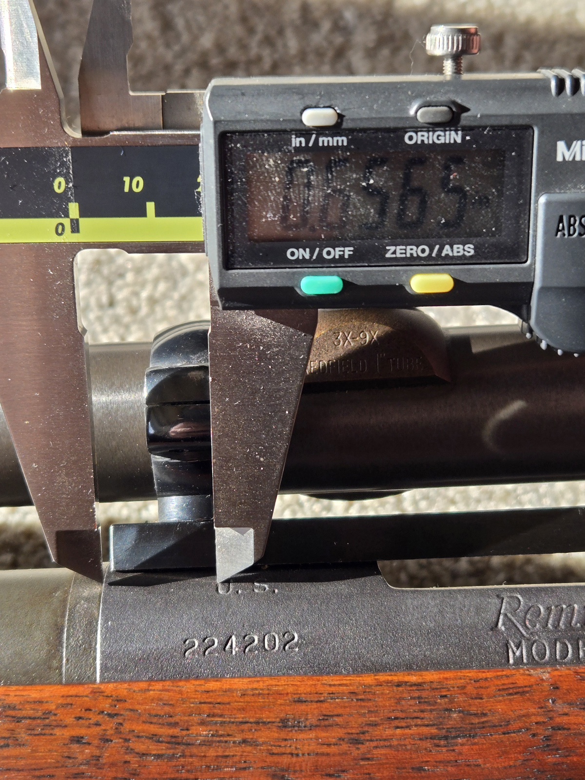

The US stamp on your rifle is too low.

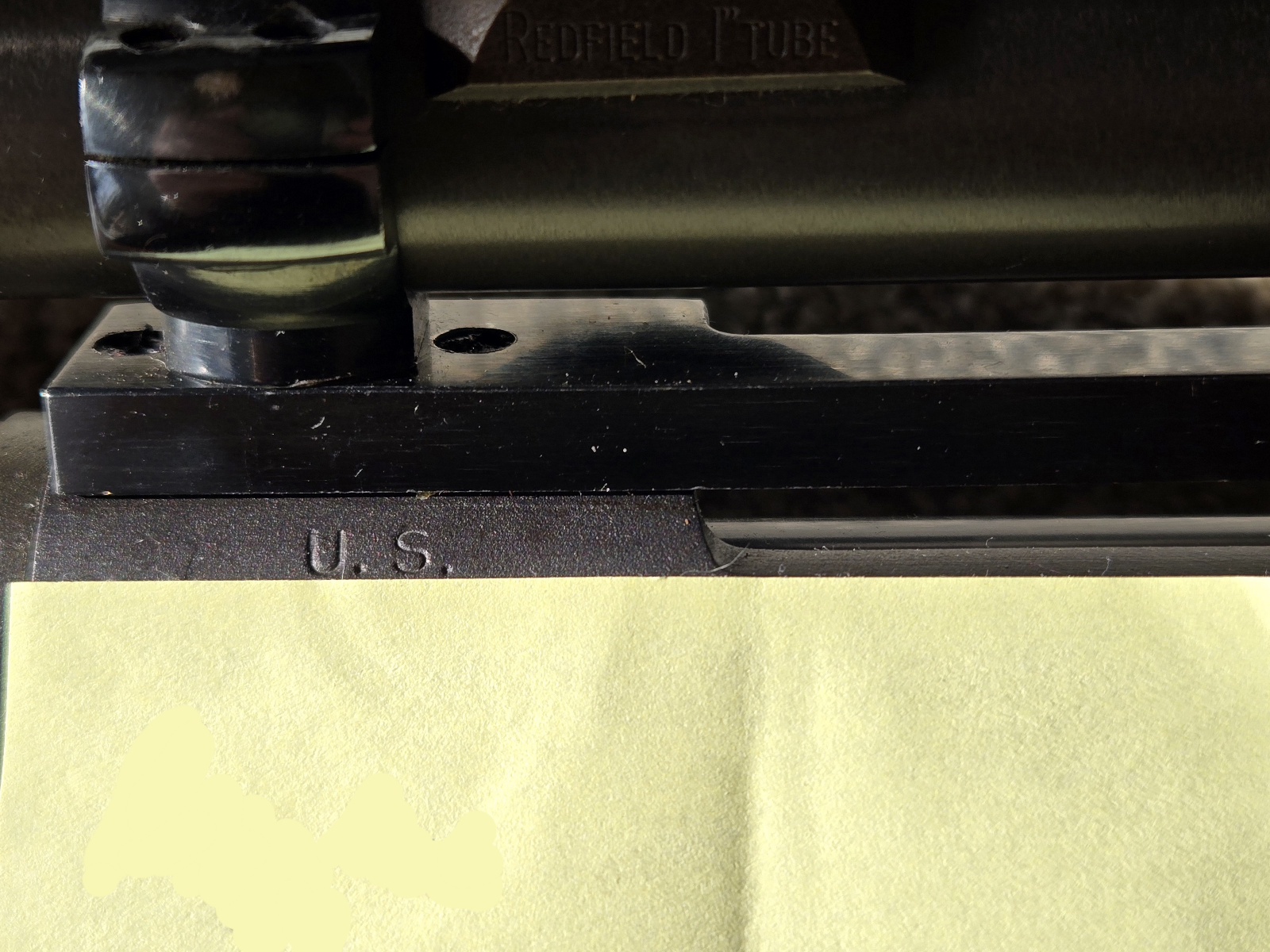

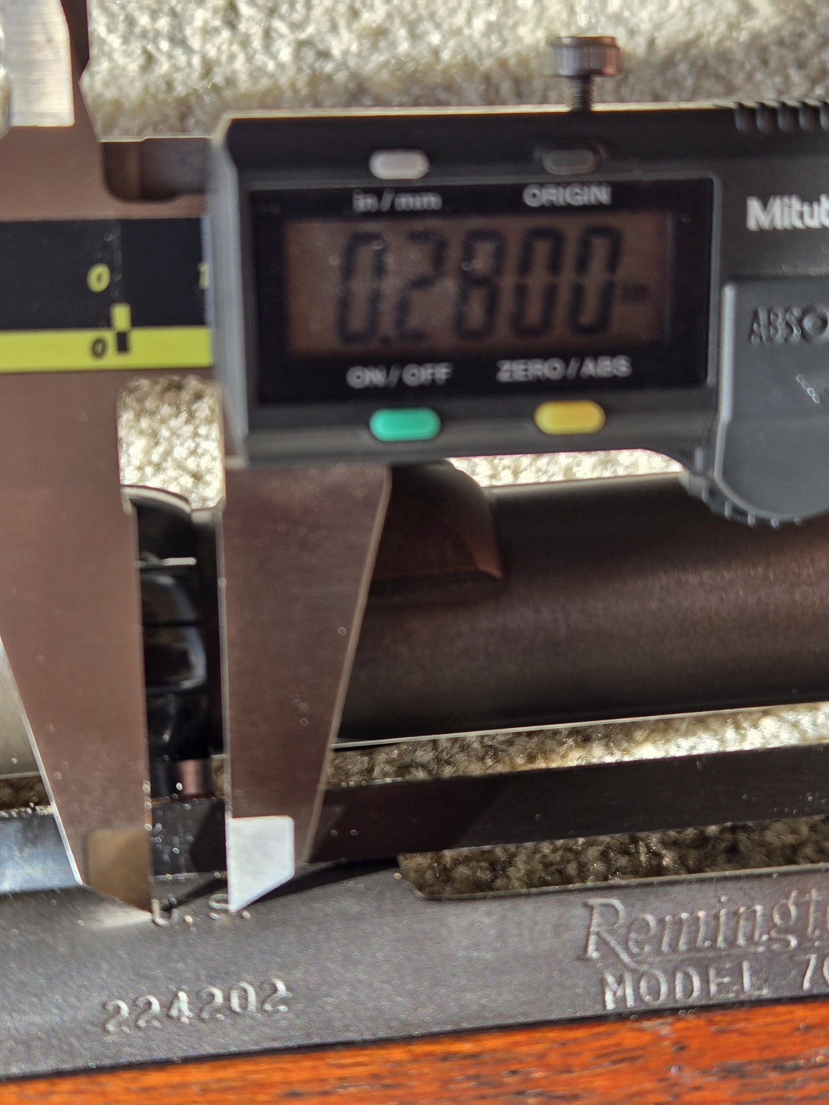

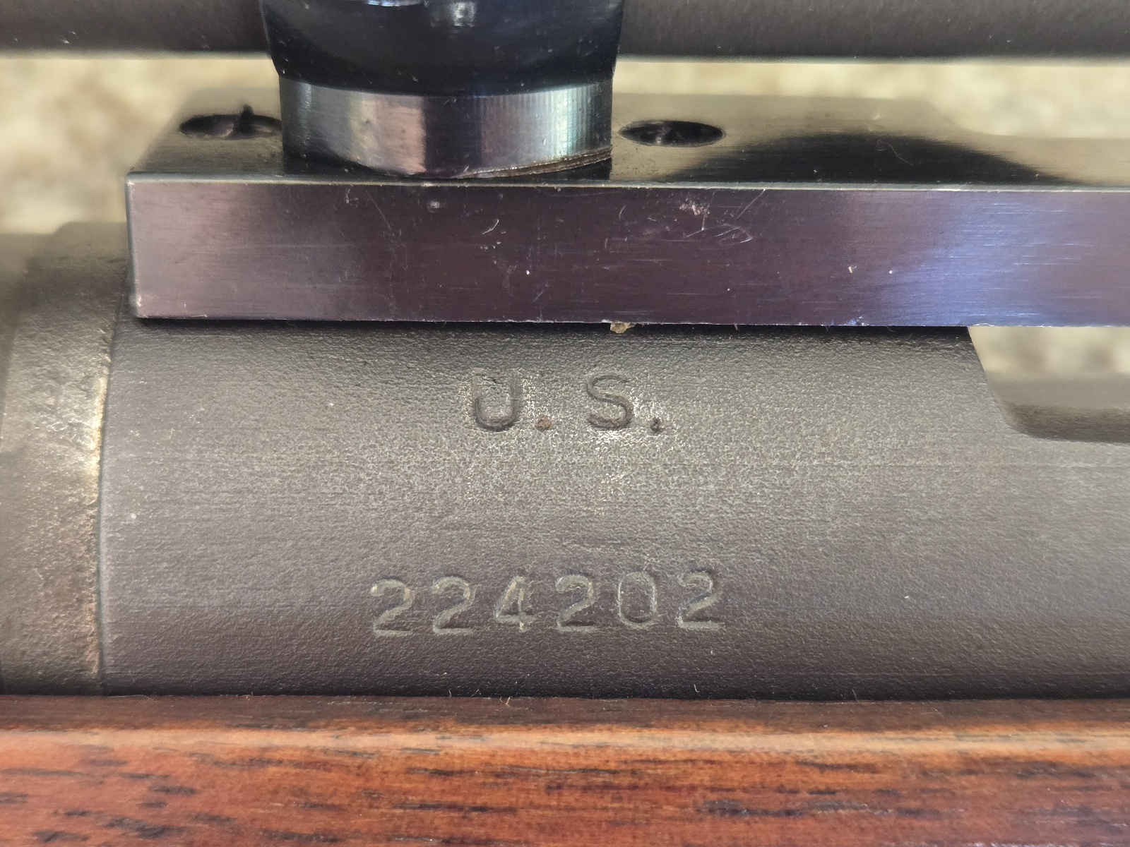

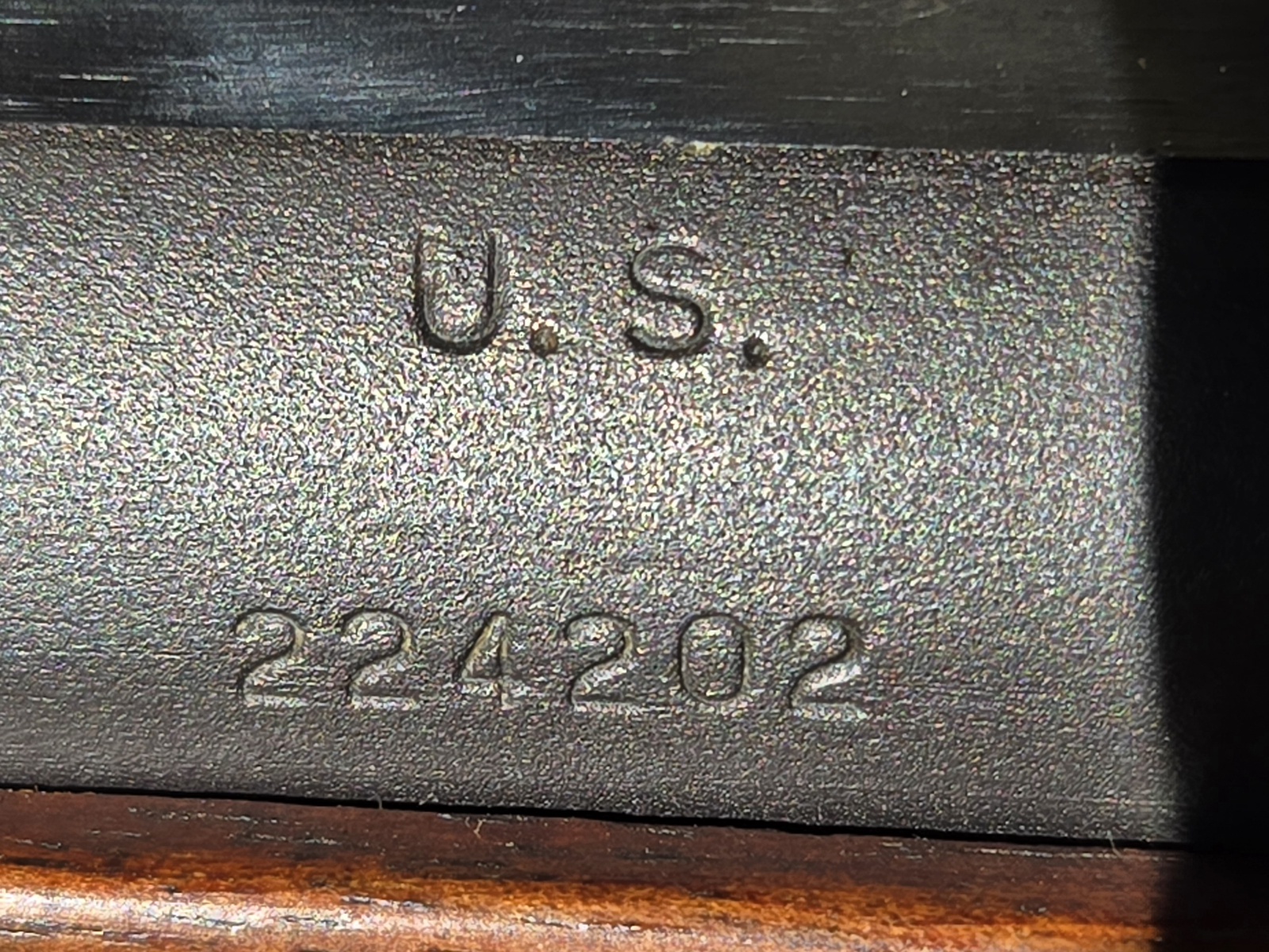

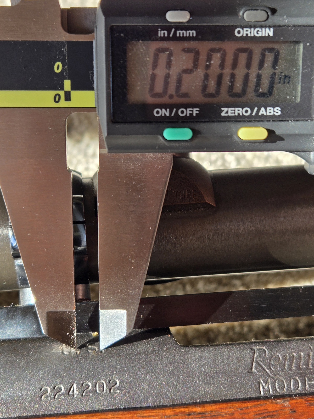

I took these photos earlier this year. Hopefully my measurements are close to the actual spacing. The information in this post is only for the 6-digit serial number M40's! The 7-digit M40's and the early M24's have different US location/spacing/size dimensions.
Original 6-digit USMC M40:
Correct US location sits on the same plane as the edge of the port on the left side of the receiver. Use a piece of paper to make a line from the edge of the port and the US mark will sit on top of the piece of paper:

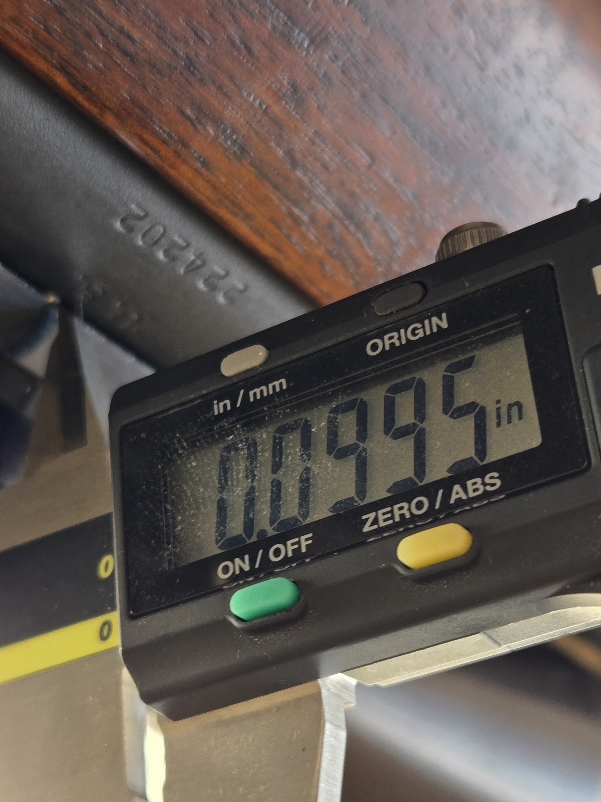

Bottom of US to top of the serial number:
20230307_002917-jpg.8091001

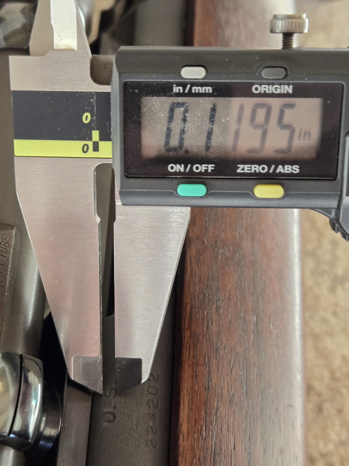

Front of the receiver to the left edge of the U:
Left edge to right edge of the U:
Height of the S:
Period to period spacing:
Left edge of U to right edge of S:
Bottom of scope base to top of the S:
