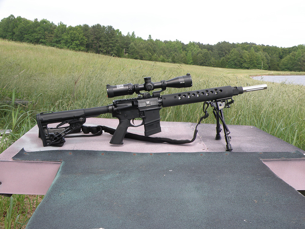

I have a Colt LE 6920 M4 that I installed a Geissele SSA-E trigger. Then I ordered a (223/5.56) 18" upper with a 1 in 7" twist and had it full length fluted. White Oak Armament built the whole upper and I had it in my hands in 4 months. I put a Bushnell AR / 223 scope with 4.5-18x40mm zoom on top. I loaded Sierra 69 gr. HPBT Game Kings for a ladder test. The first time I shot it was with my reloaded Sierra 65. gr. SPHPs I used for deer hunting. I wanted to sight it in and foul the barrel before the ladder test. Here is a picture of the hunting 65 gr. 5 shot group. The first 5 shots with the 69 gr. BTHP Game Kings was smaller then this group.
White Oak Armament
WOA is noted for their accuracy and service. I bet mine would be a great prairie dog gun out to 600 plus yds.
It weighs exactly 11 pounds as you see it with a loaded 20 round magazine.
