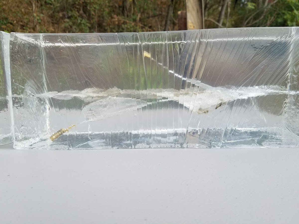

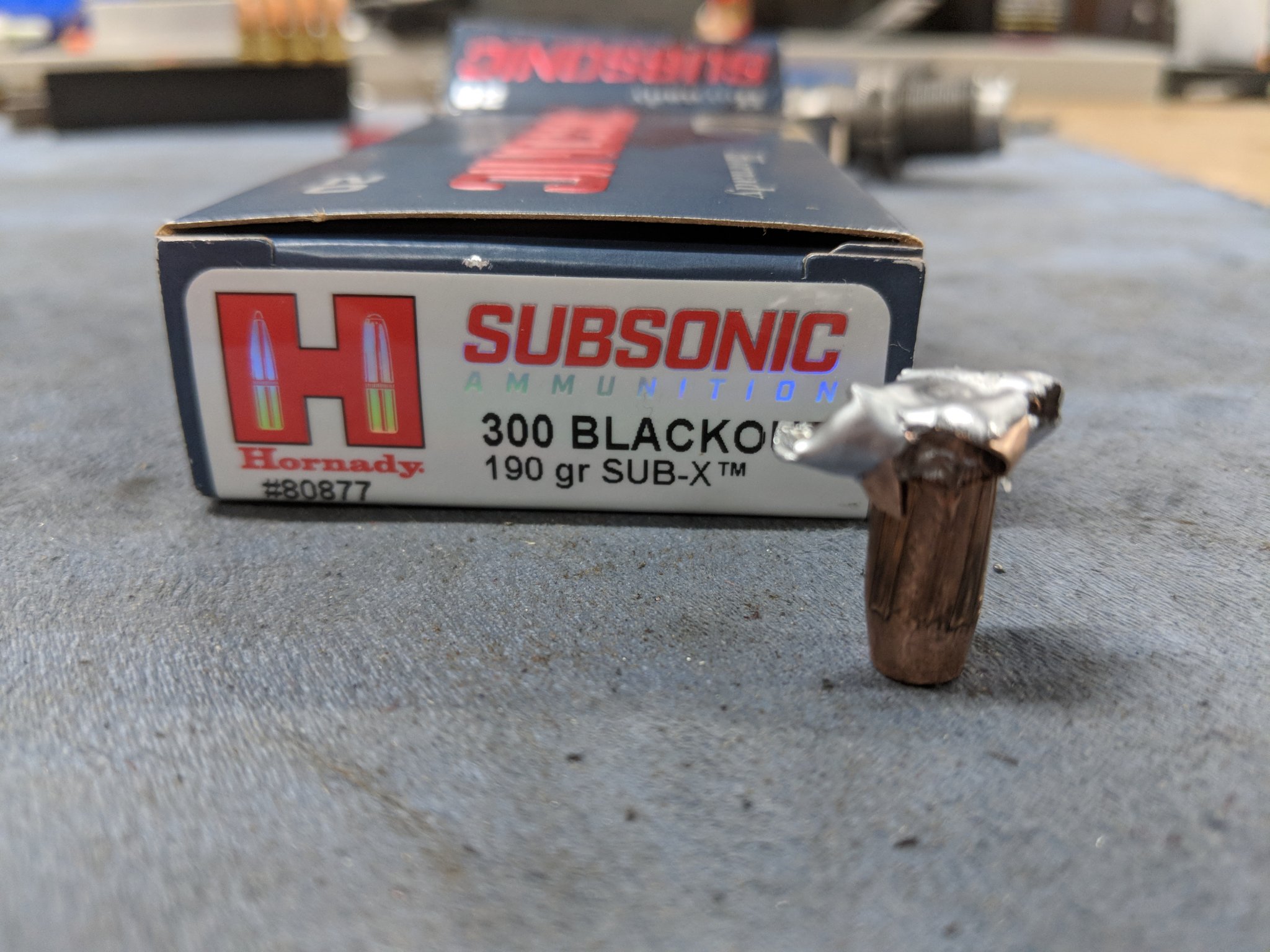

Here's some of the testing I've done with factory Hornady 190 Sub-X and Lehigh 174 CF
174 Lehigh Defense Controlled Fracturing at around 950 fps in clear ballistic gel
Recovered Hornady 190 Sub-X pulled and loaded to 780 fps, and still in the gel.
