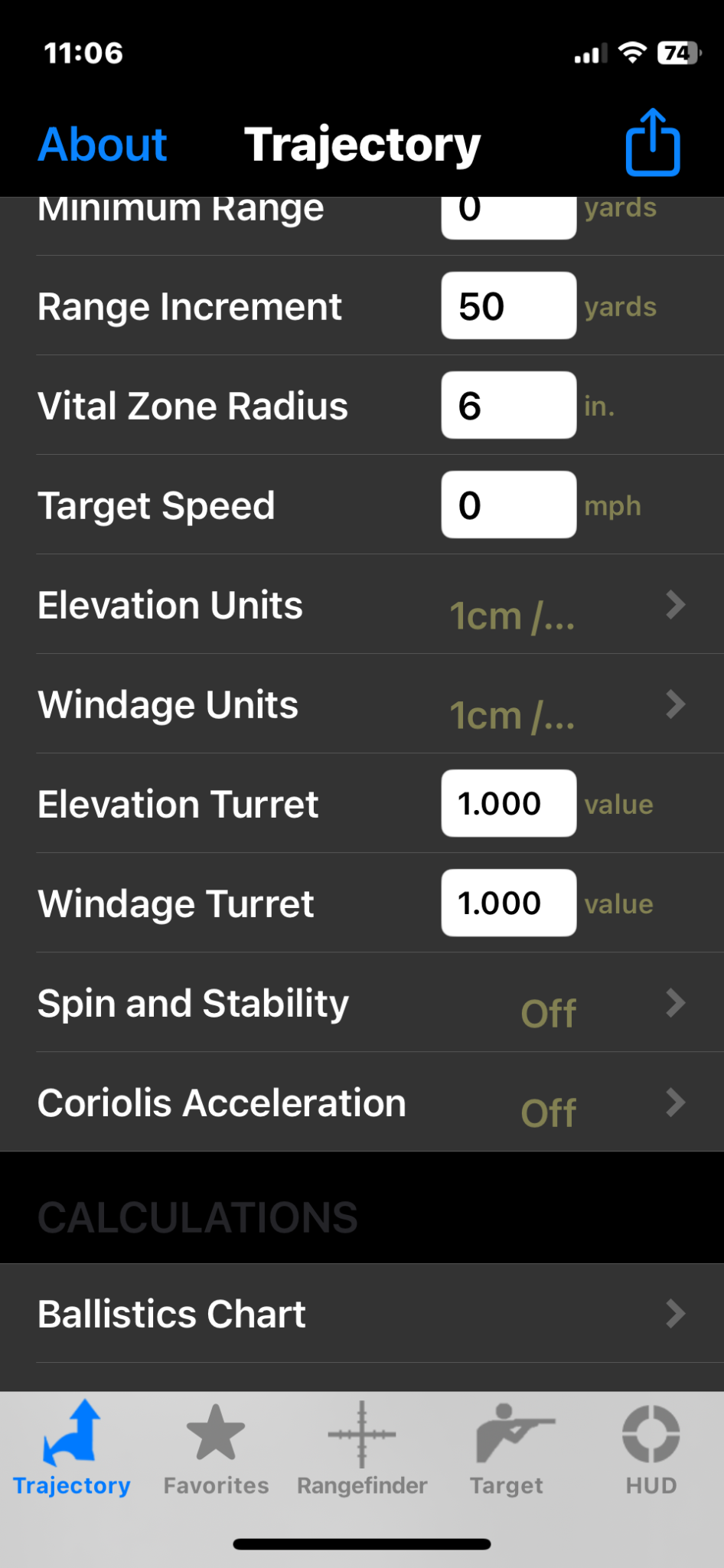

The calculations in most calculators, like the one shown, includes the 1.047 factor between inch and MOA.
Do I need to change this from 1.000 to 1.047 because on my calculator it gives me my drop in inches and then I can select the second column and I’ve got it set to 1 centimeter/100m you can see it in the picture above.

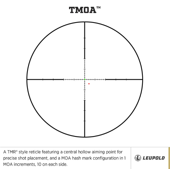

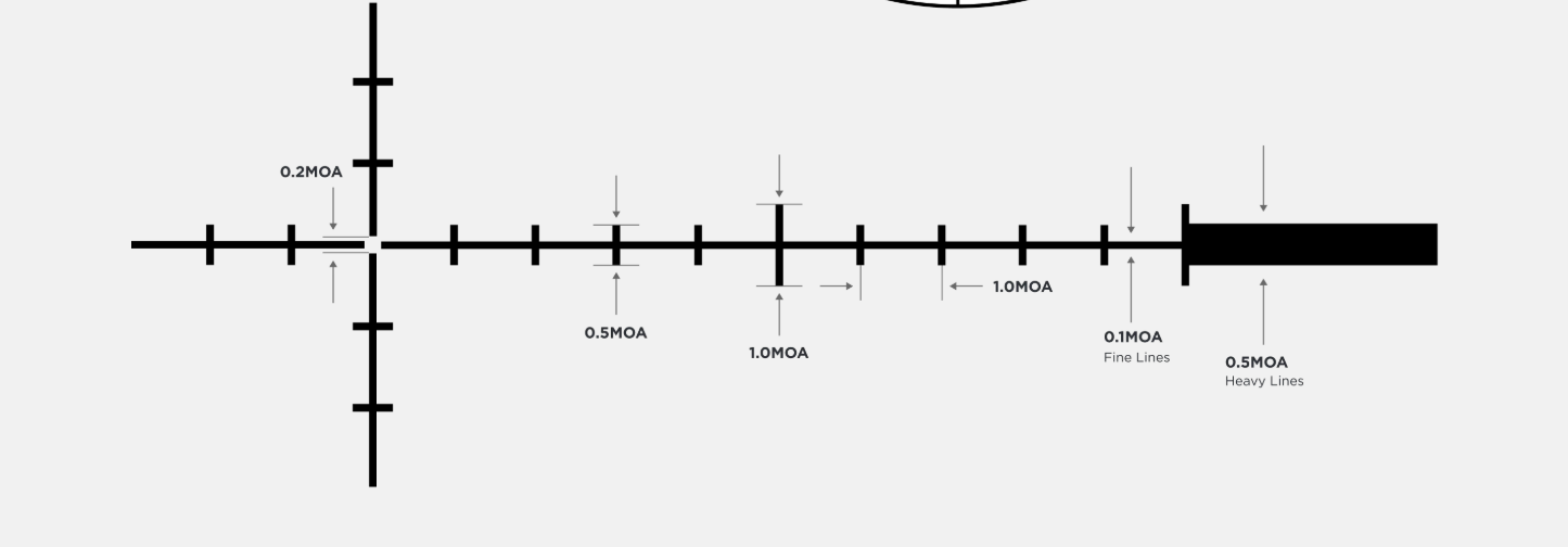

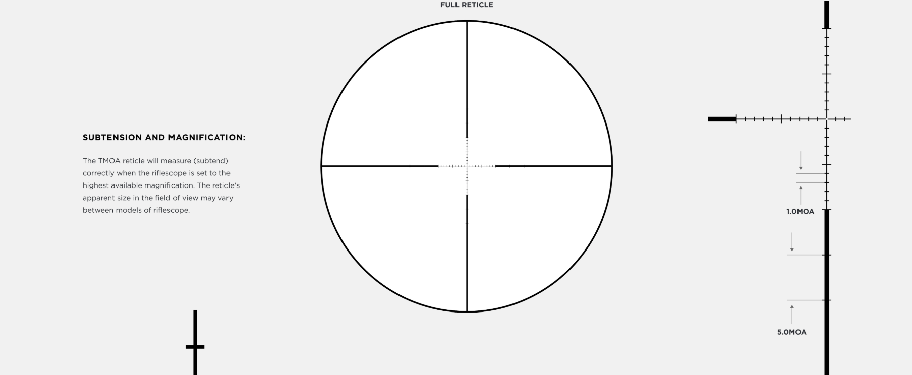

Although it may not be a ruler in your scope, per se, it can be used as a ruler quite easily. I pulled the below screenshot off the Leupold website and it shows what the subtensions are.
Your scope has the TMOA reticle according to that link you sent. If you can measure the distance between your Point of Aim (POA) and Point of Impact (POI) with your reticle, you have a rough and dirty way to measure what your corrections will be provided all other variables are ruled out.
For example, the reticle below shows a green dot for the POA and a red dot for the POI. Looking at that, you can measure the distance (in MOA) from POA to POI and, from that, know your correction needs to be roughly U2.0 MOA, L2.0MOA. Instead of thinking in clicks and inches, read the markings on the elevation/windage turrets and make the corresponding corrections in MOA like @Rob01 had mentioned, keep everything speaking the same language. The same applies for your situation between the 200yd shot with a 100yd zero. Anyway, I'm not sure if this provided any clarity but feel free to do with these ramblings as you see fit.

Well, it's not a traditional "ruler" in inches, but your reticle is technically a ruler, just measured in MOA (or MILs if you use MILs)... So, in a way, yeah, you do have a ruler in your scope. That's what advanced modern stadia reticles are used for...To measure.

Also, for scopes with a basic duplex reticle, you can probably find out the spacing between the thick lines on the reticle, and use that to measure. Just remember that it will only work at full magnification with a second focal plane scope.
