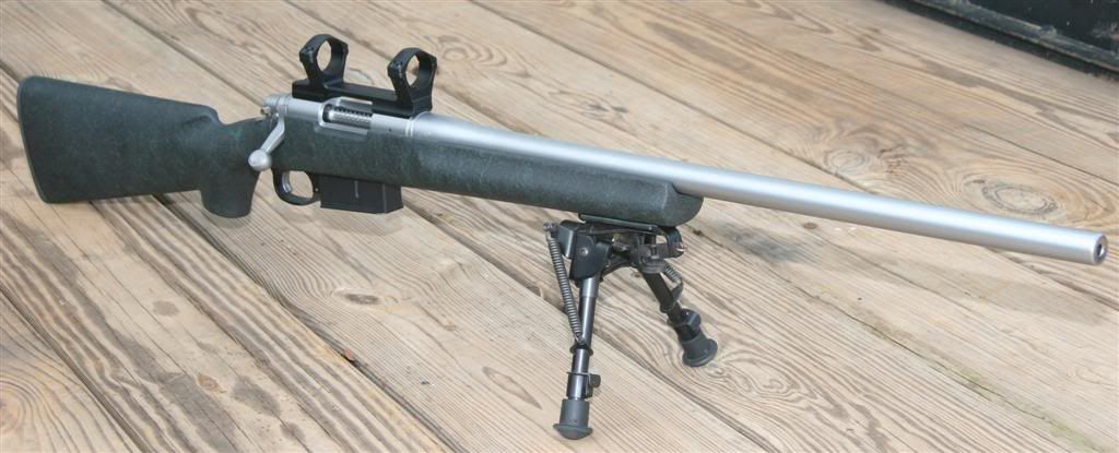

I'm taking my SA 5R to American Precision Arms for the following:
Timney Trigger
New Trigger Guard w/5 rd drop mag
Proper Bedding of the barrel
Are there any other MINOR things I should have done while it's there. I would hate to get it back and discover if only I had done this or that.
Thanks for your suggestions

I and if you ask several smith's you might get the same answer, I think it is unnecessary to true the action unless you are getting a new barrel.
Re: Upgrading my totally stock 5R
Maybe consider lapping the lugs and a oversized bolt knob. If youve ever thought about a muzzlebrake or suppressor, now would be the time to get it threaded since he will have it anyway.
Honeslty, you should just ask Jared what he would recommend since he will have your rig and can give it a once over for ya.
Well you can't paysomeone to add experiencebehind it for you. Don't do shit to that action until you've shot that barrel out. Bed it, recrown barrel, adjust trigger. Btw what areayou in mr h?

put it in a McMillan A-5

I agree with this. There are so many factory guns out there that will outshoot most shooters, including your 5r. I personally wouldn't do anything to a perfectly good shooting gun until I had spent enough money on ammo to memorize my dope, holds, and have a strong wind calling ability.

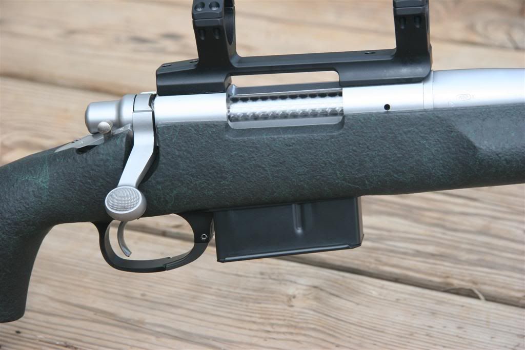

<div class="ubbcode-block"><div class="ubbcode-header">Originally Posted By: OOH</div><div class="ubbcode-body">what DBM did you put on it? </div></div>
Badger? HS Precision drop in style? I'm interested given I have an identical rifle.
Thanks!
