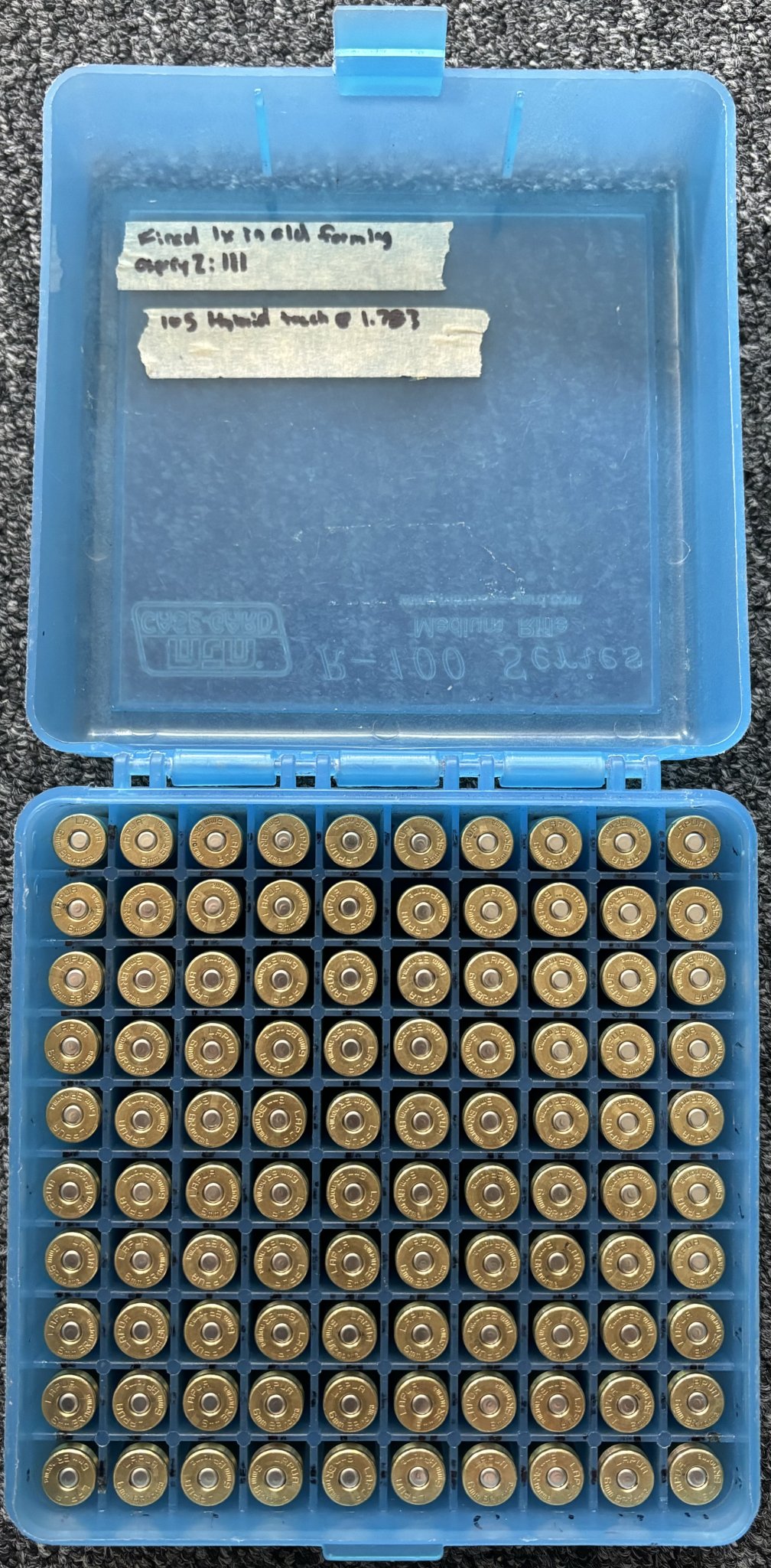

I've been using these cheap plastic one's for years and they do just fine. . . even able to place .308 cases with mouth down:
