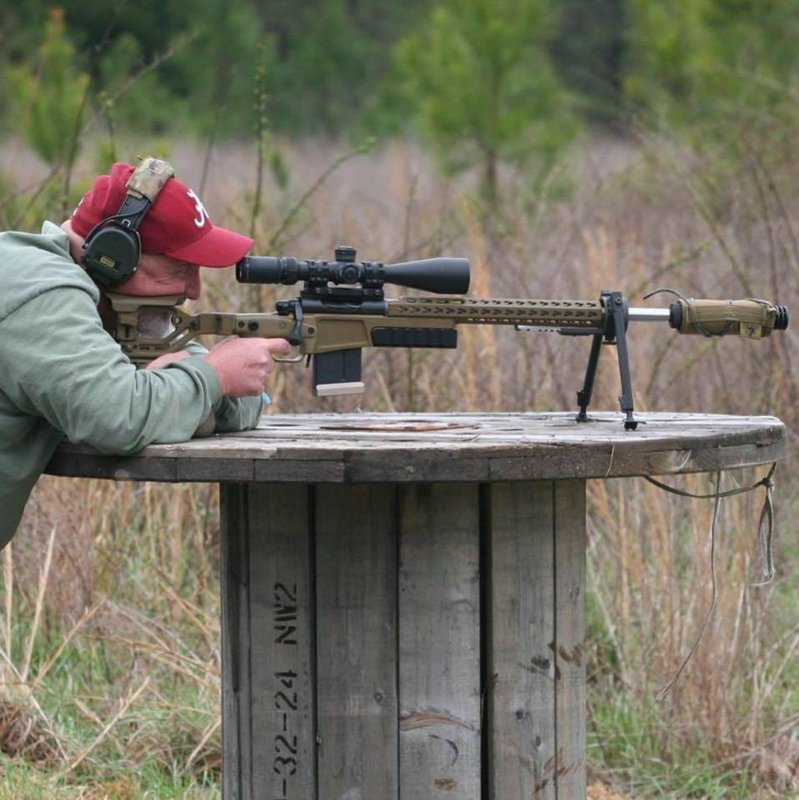

    Love my AX chassis....Vortex AMG in a Spuhr 1.18" mount.....20" .308 with an Elite Iron bipod.
