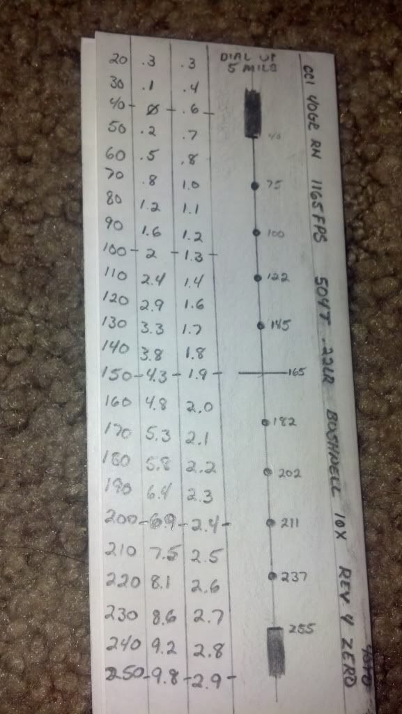

Guys,
Some folks were asking, and just using Word, and JBM "Trajectory" ballistics I set up this reticle, hard laminated it and keep it in my DOPE book. I used it on the range, and was dinging 8" targets with my Savage MK II out to 200 just using the hold overs.
There were some folks that said that the Bal Calcs were really not practical for rimfire. I disagree, especially when you are shooting a timed precision rifle match. Very easy to do, the BCs and velocities have been posted here before on this site. It was actually fun to create.
This was with a 50 yard zero...
Don't know which folks were saying that Ballistic Calcs were not practical for RF... but I'm guessing they weren't here. You'll generally need to tweak ANY computer generated calculations to your particular equipment but they give a great head start when creating your own DOPE.
As the weather and conditions change, you will notice that you will need to adjust. Sometimes as much (or possibly more) as 1/3 MIL in elevation.
Thanks for posting this, I'm sure there will be several who appreciate you giving them a graphic starting point!

Those people are those that use JBM and other calculators as a crutch and not as a tool.
Calculators need to give accurate data but it doesn't have to be spot on perfect.
The job of the shooter is learn what his particular rifle/ammo do in the given environment.
As the environment changes....the dopes change.
The human brain can easily grasp trends....I don't need to run a calculator to know today when it 4 degrees out that I will likely need 9 MOA for 100yds and once the temp gets modestly warmer I will need slightly less. And there is a point where your dopes will hardly change at all regardless the weather.
Guys who bounce around like a ping pong balls between ammos will get some marginal benefit from the calculator since they come closer to tuning for the flavor of the day.
But they still have to go back and re-zero the rifle for each new ammo. Which may be where some have problems as they will call the old zero good enough. So a flawed zero, typical muzzle velocity variation, and more than likely poor bore prep for "new" ammo can really skew results.
The guy who has his data wrote down (as he should) and sticks to that ammo hardly ever needs to go back and check. His card (combined with common sense and the occasional monthly/weekly shooting session) will be every bit as close to the guy running a calculator with a round that has muzzle velocity spread of +/- 40fps.
I would even say rimfire is easier as I have ran .125 as a ballistic coefficient, the grain weight, and muzzle velocity regardless of ammo maker or bullet type and came up with cards that were "close enough".
