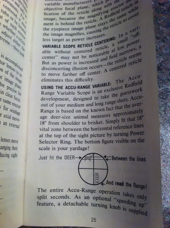

You are correct but..
Historically, the Redfield Accu-Range reticle purpose was for hunting. The 2 top lines represent 18", the approximate size of a deer.
The military heard about it, and thought I might apply to sniping since the human chest is also, approx 18".
Here is a picture of the manual that came with my original Accu-Range scope.

Man you are killing the gear queers, with truth.
Loved the ART after, we had the armor drill and tap the base for set screws. Even guys that only had a 15 minute block, could use it correctly for range, after getting them zeroed. Some places it was hard to get a good bead on the belt line and top of head, but even at that it was like they say, "Close enough for government work".
