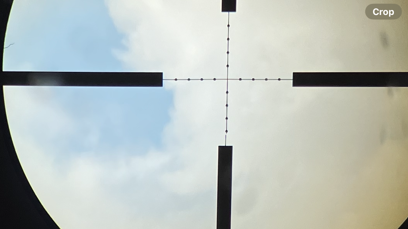

Anyone ever seen the reticle break on an USO MST-100?
I've sent an email, but since it's Sunday I know I probably won't hear back for a few days. Just curious if anyone has any firsthand experience and whether they can/will fix it?
Pic attached - it broke right below the bottom mil-dot on the lower vertical crosshair. Mounted to M40A1, 330 rounds through it, no abuse.

Who did you send an email to?
I’ve seen a bunch of the old Unertl reticles break, but not a USO reticle. And, that doesn’t look like a USO reticle to me.
Pic of the scope? Did you buy it directly from USO?
Yes, it came directly from USO, granted from like 12 years ago when they were in CA, and was unused until last year, has seen 330 rounds. SN 35xx. Still got the box and warranty paperwork.

I had a usmc unertl 10x with broken reticle, ironsite in Tulsa replaced it.
