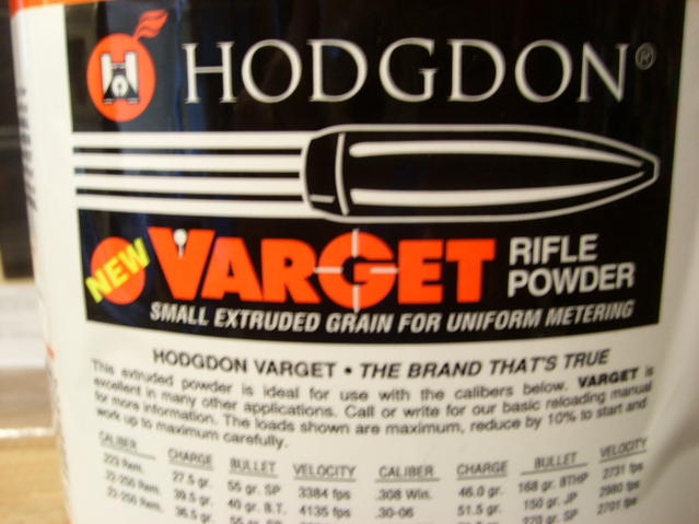

Hi guys, I just wanted to let everyone know that I just got an 8 lb jug of Varget and it is cut finer and meters extremely well. I guess Hodgdon decided to make it even better!
That would be good news. Can anyone else out there confirm this? I haven't read anything on the web or publications about this. Maybe someone can post a good close up photo of "Old" Varget and "New" Varget.

I have been looking around about for the new Varget. There is a handful of ads on Gunbroker with Varget so been looking at the photos. Only one of them shows the label with the words "Small Grain" like the one shown above. I did find a place called Lohmans that will take back orders(they say 8 weeks but ??) just not sure what you get.
