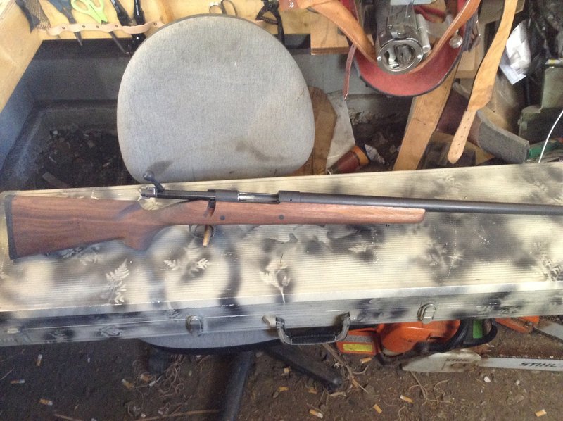

Crappy pic but here's mine on my very cluttered leather bench.

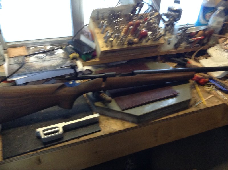

Do tell about that trigger guard on the bench
That is one I dug out of the bottom of an old box. I made it years ago for a Winchester model 70 Highpower match rifle. The rifle had an anschutz trigger assembly and needed a custom trigger guard made for it, this one inletted into the stock worked well with the trigger And it extended the internal magazine by two rounds. I made another one after this one that wasn't so blocky, although it worked perfectly it was a prototype. I was thinking about cleaning it up to use on another stock.

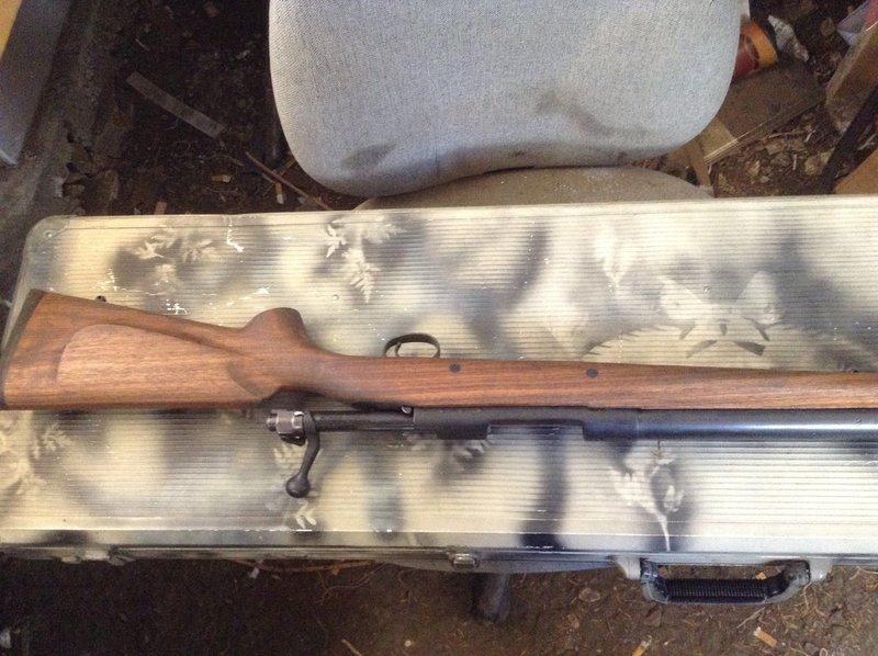

I will say a Boyd's stock ordered unfinished makes a great replica. I got mine and coated with boiled linseed oil. Came out with the perfect finish. Four of five heavy coats, dry and buff for a matte finish. Inlet was spot on and the price was great. There are two spots on mine where cross bars were installed and the wood used to cover those holes didn't match when oiled but it's close enough. Ordered with a heavy varmint barrel channel, wasn't perfect but a little work with a socket and sandpaper finished it nicely.
Beautiful rifle.

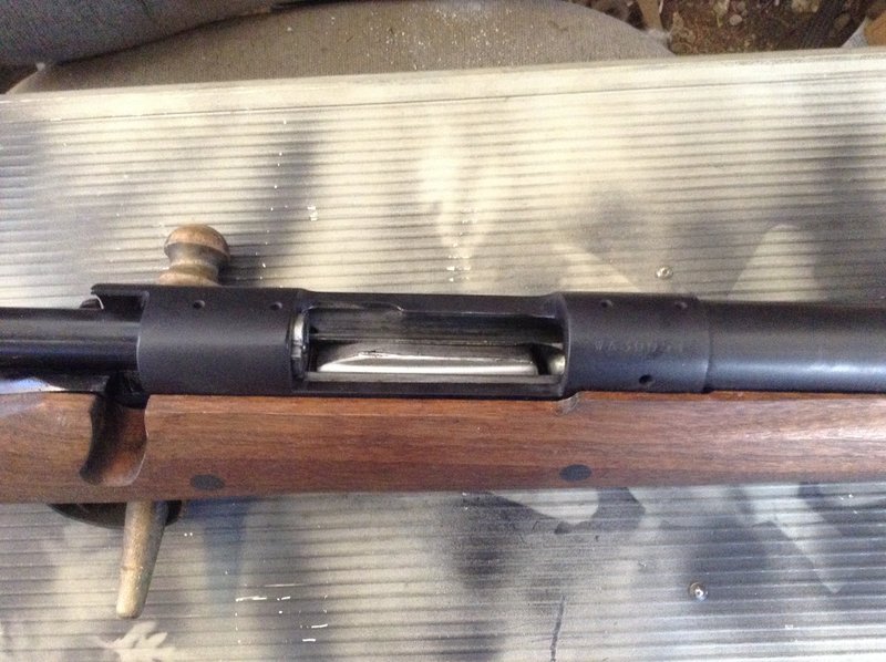

Thanks, this one isn't clip slotted as it's after 64 but it does have the NM iron sights. When the scope base is installed the clip slot will be useless anyway. I was just looking for a serviceable replica, not an exact replica. In the end it will be a shooter.

They continued to clip slot them for a while after the post 64 rifles were produced. Of course any gunsmith worth his salt could do it as well. I've had a few in the past that had a clip slot only one I ever used was for a Winchester 70 match rifle that was used across the course. The factory clip slots sort of suck anyway. All we actually used were opened up for the solid aluminum clips that were U shaped. Then we got rifles with detachable mags and Oooooo my my.
