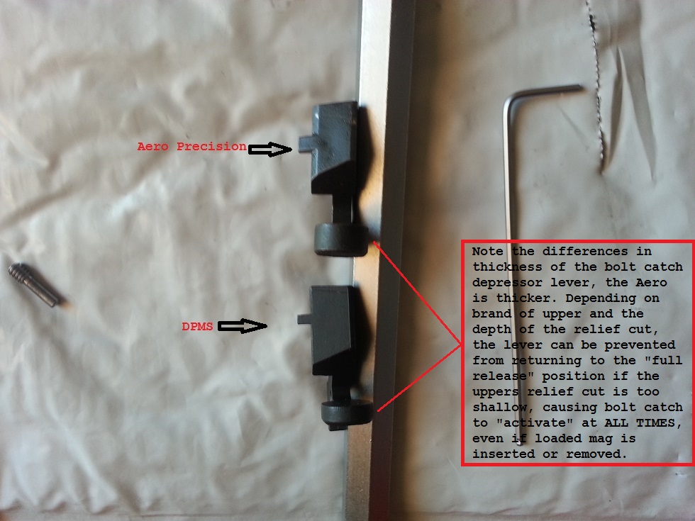

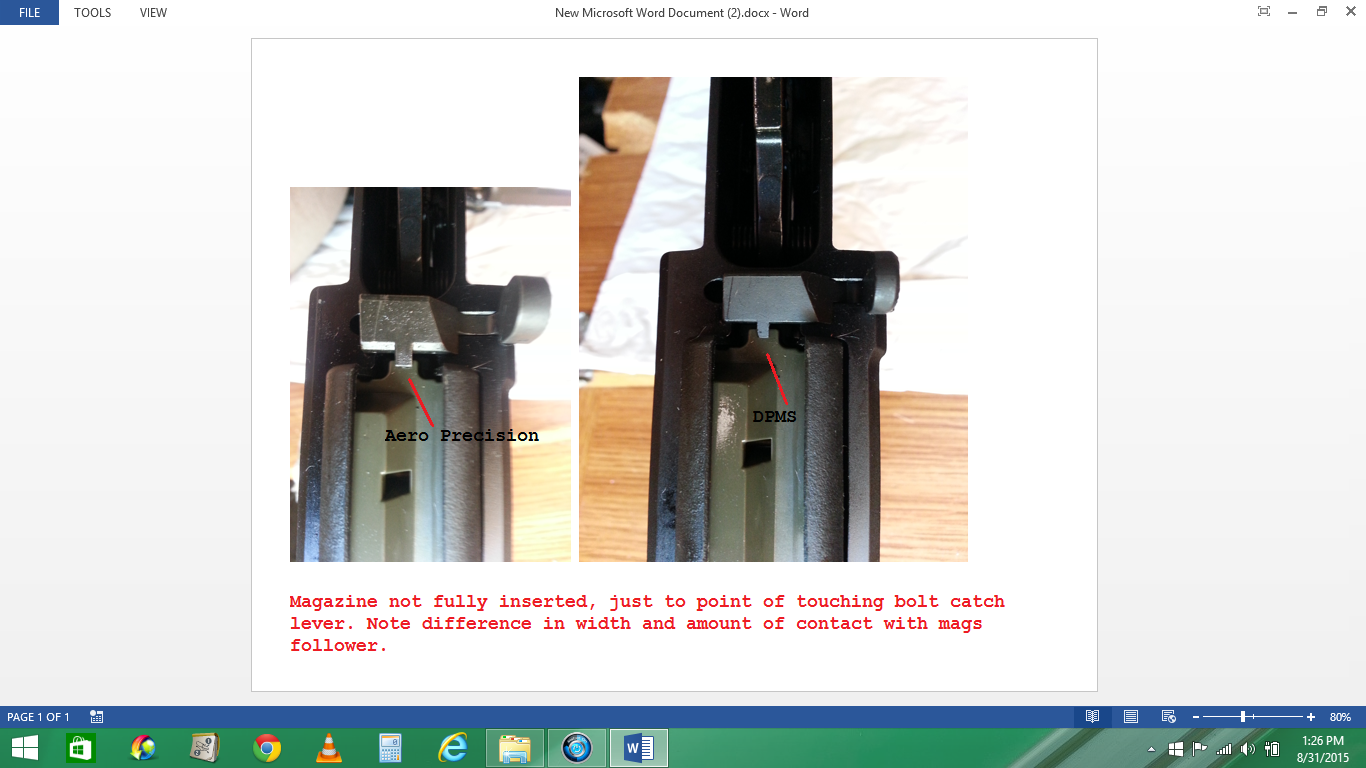

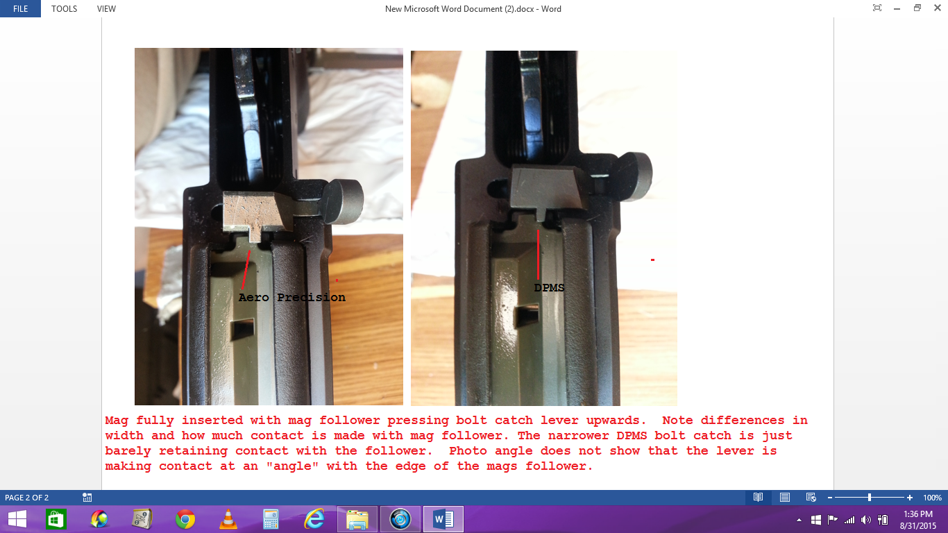

...you also didn't indicate what LPK you used, but if anything I'd also recommend you use Aero's bolt catch at a minimum, especially since you say a slight touch will release the locked back BCG, that could indicate an issue with the bolt catch's lever. Some DPMS style bolt catches had a very thin width lever to catch the bolt while the mag follower pressed it upward, they were thin enough that they barely contacted the edge of the follower (see attached pic). The bolt catch is on sale right now too, or you can just go for the whole LPK minus FCG & grip so you have spares on hand. Links to bolt catch & LPK:
