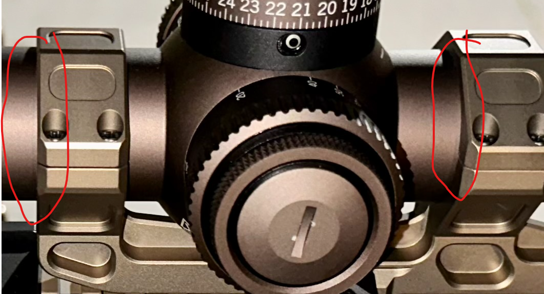

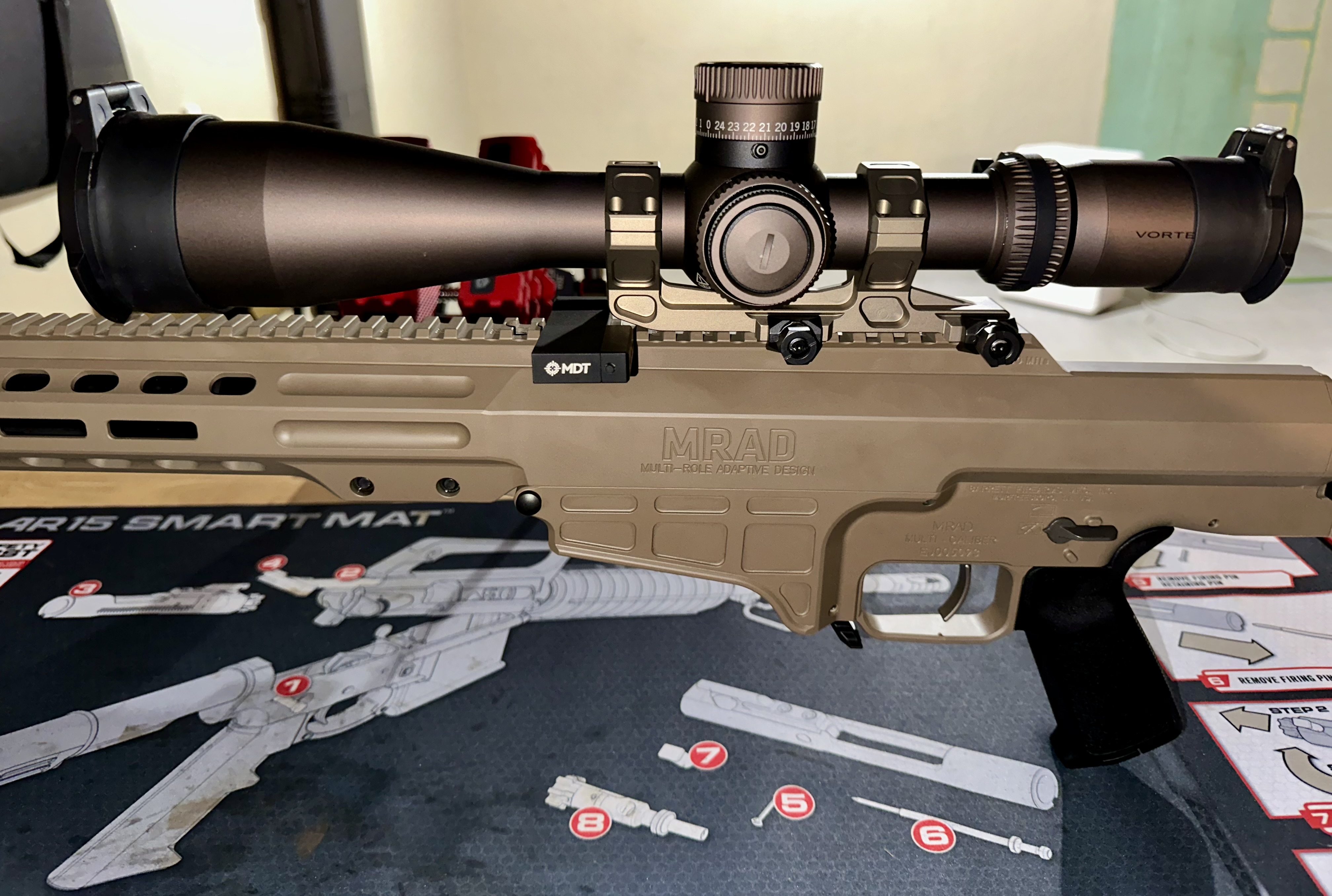

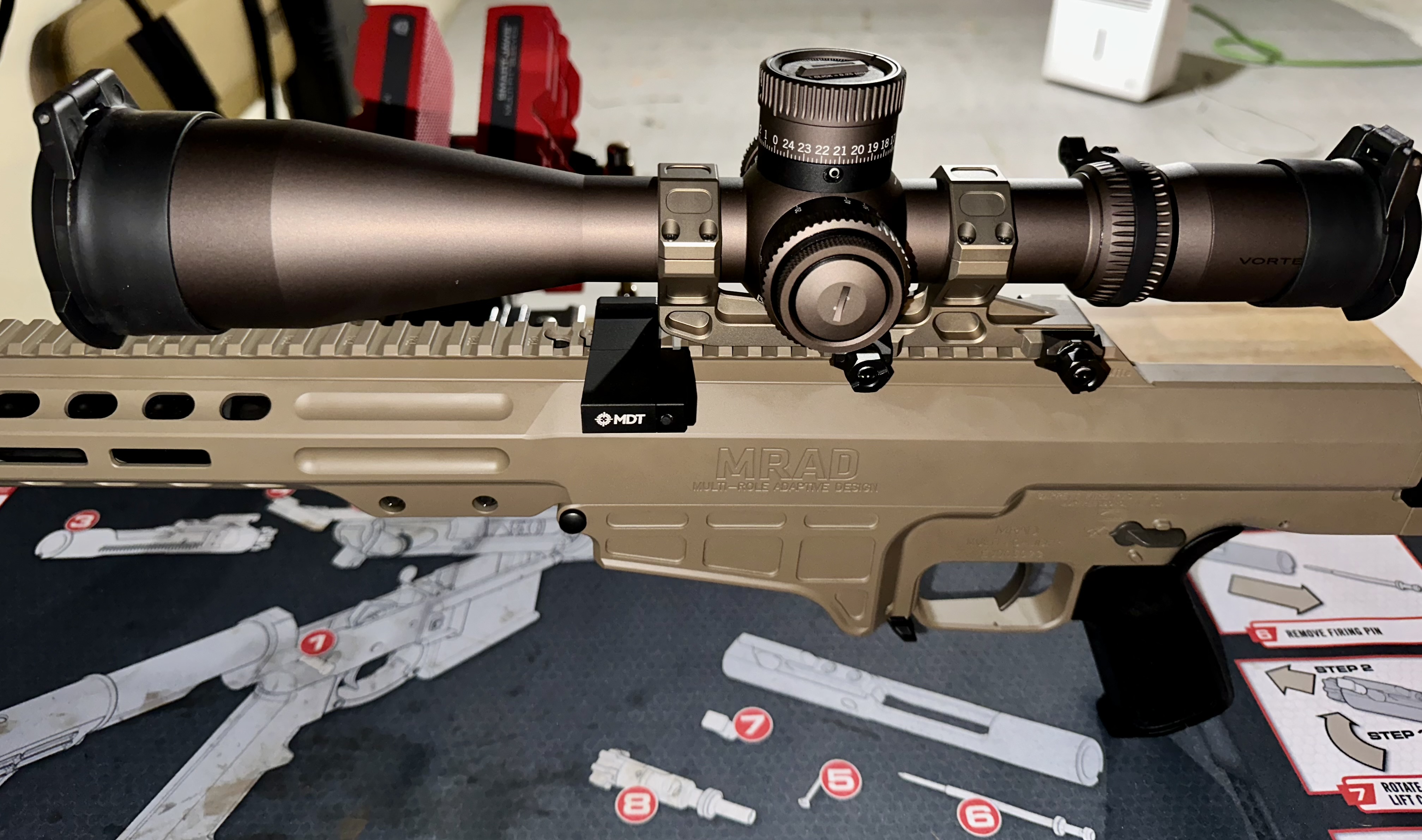

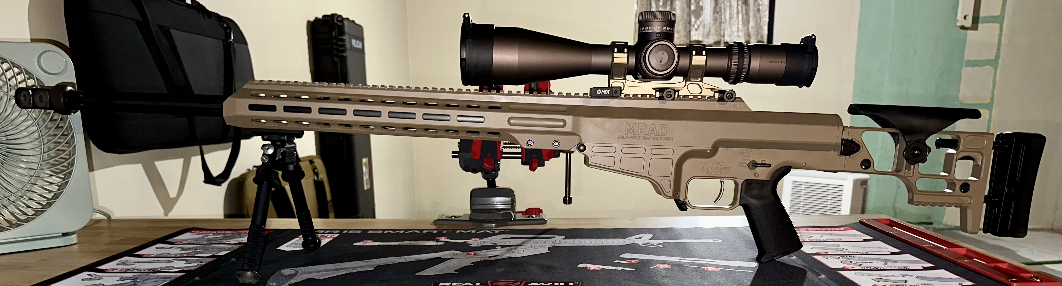

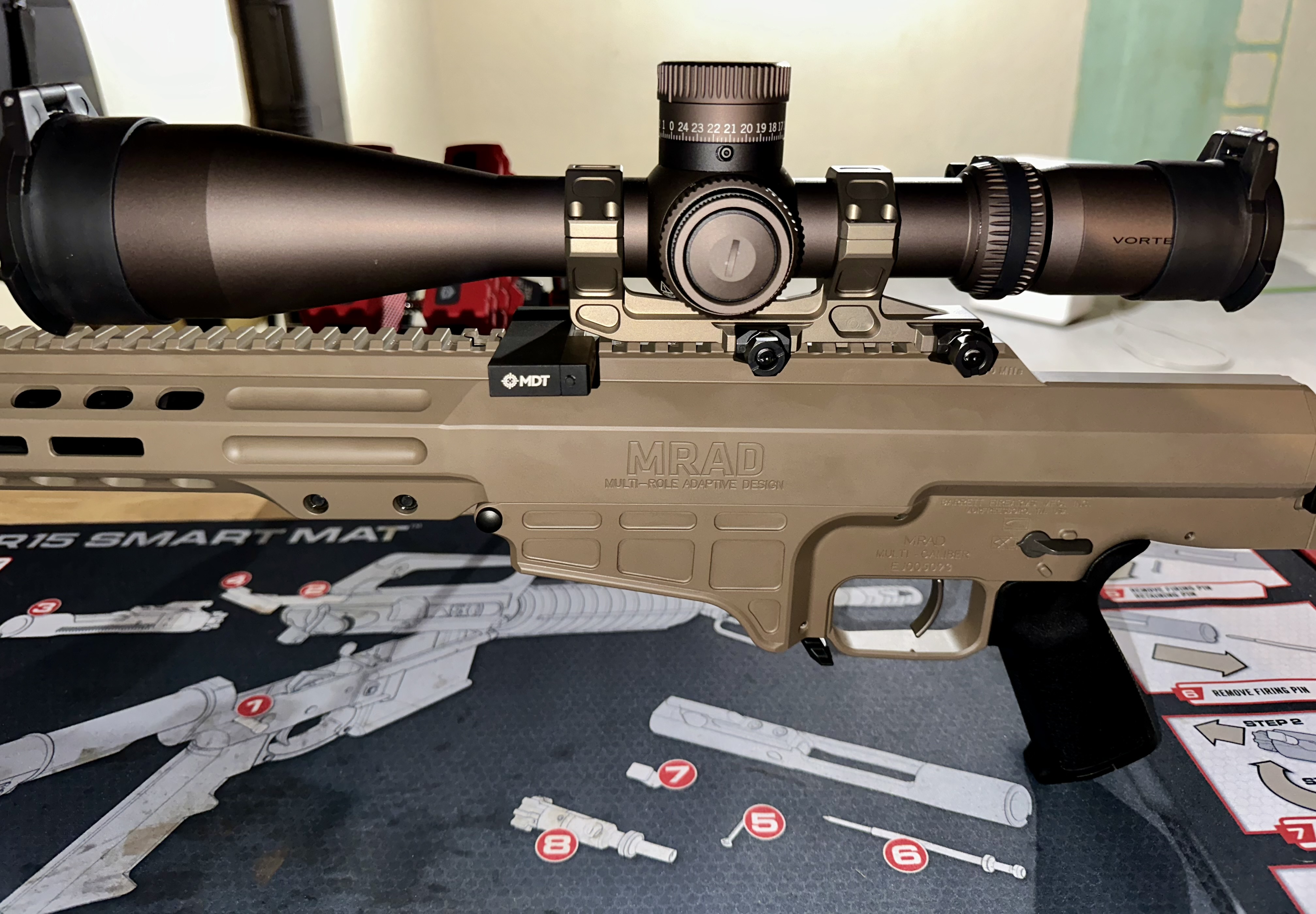

Purchased a Vortex Razor HD Gen III 6-36 from EuroOptic that I mounted on my MRAD. Ran my new 6.5 Creed barrel over two trips to the range. My groups are wild. I'm not an expert marksman by any means, but I'm also not new to shooting (or this bad at 200 yards). Likewise, I've mounted a lot of scopes over the years; I'm fairly certain I didn't fuck anything up, like crush my tube.
