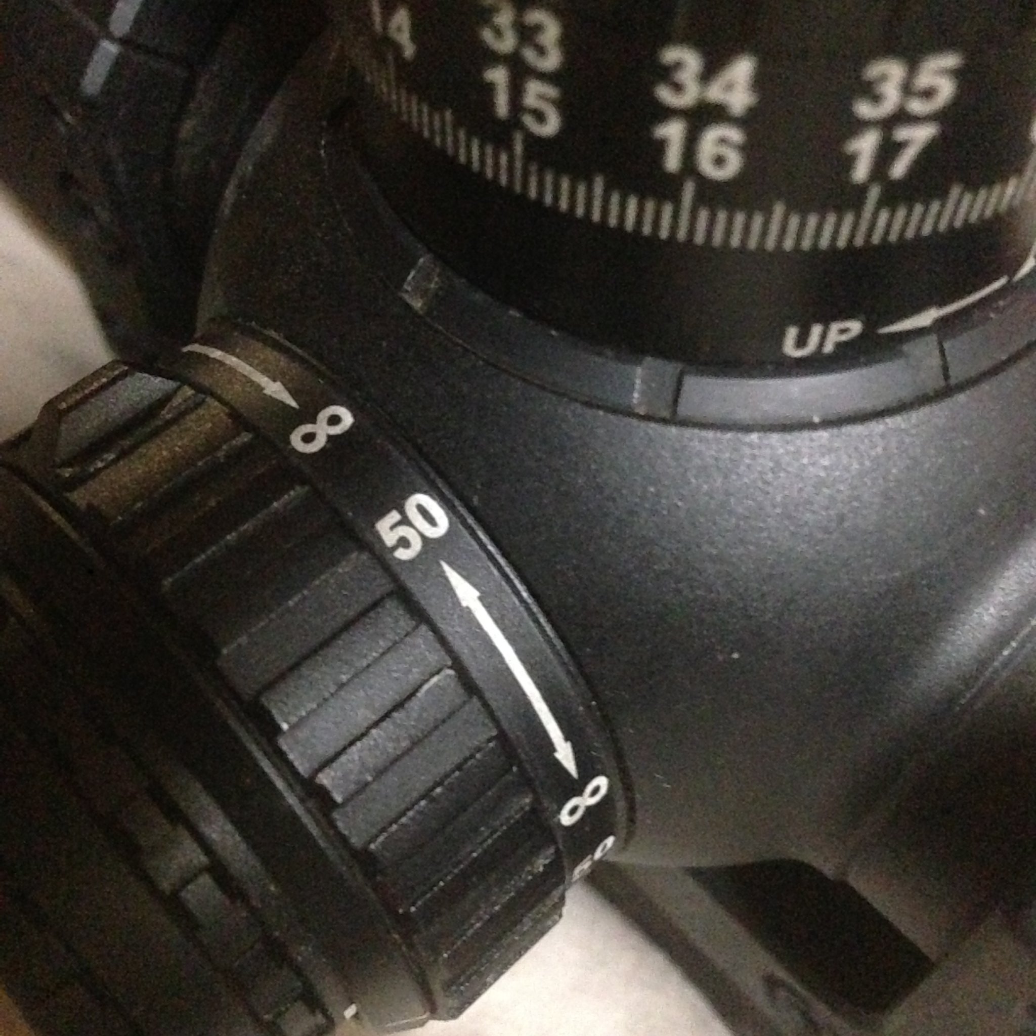

I noticed with my Vortex Razor that the parallax adjustment is possibly not true to the markings on it. When I was at the 100 yard range yesterday I set it to 100 and it was perfectly in focus, but at my house I point at a hill that I know for a fact from a topo map is over 600 yards away yet when its in best focus the marking reads about 250 yards. What does this mean?

Everyone’s eyes are different. Like others have said, don’t worry about the markings. Those are just a general guideline.
You really shouldn't even be worried about the focus. The parralax needs to be adjusted so that at a given distance the object you are looking at does not move if you move your head/eye a bit. The numbers may not match up and that is fine.
Did you ever set the focus for you? (This is not done with the parralax.)
Reactions: shoot4fun
Do you wear contacts?
Thank you, that's helpful about the diopter acceptable range of adjustment but now I'm confused about something else he wrote.
"Next time out at the range, I setup on the 640 yard silhouette and adjusted the focus for zero parallax. It only took a slight diopter adjustment to pull the target into focus, and the reticle was still nice 'n sharp."
I thought focusing the target and turning the parallax turret was the same thing, that when the target is in focus the parallax is done. That the "focus" knob is the same thing as the "parallax" turret. But this guy is saying he adjusted the focus for zero parallax and then used the DIOPTER to "pull the target into focus". How did he know the parallax was zero if the target wasn't in focus? I thought that's the only way of knowing the parallax is zero.
As said above focus ≠ parallax. Parallax is tested by moving your head around making sure the crosshair does not move. That is what the parallax knob adjusts.

Oh, okay, now I see what he meant. I will have to play with that tomorrow because I remember the window of diopter range he was talking about and I set mine in the middle, too. Thanks a million!!
I forgot where I read it, but as you adjust the diopter away from "0" either +/- it also affects the focus in relation to parallax so the numbers (and focus) are no longer totally "in sync".

Parallax is where the images, the reticle and target, are not on the same focal plane so when the rifle is perfectly still and you move your head left the cross hair will drift left across the target, when you move right it drifts right. So you adjust the parallax so that the cross hair no longer drifts and you have dialed out any parallax no matter the turret markings. Weather, changes in light, the scopes adjustment and your individual eye can all affect the perceived parallax of the scope so it's tough to have all markings all right all of the time for all people at all magnifications and adjustment ranges. Some are a more forgiving design, some are more challenging. (If you head is perfectly centered behind the optic there is always zero parallax because your are not off any direction)
Once you are no longer drifting adjusting the eyepiece diopter focus you may be able to get a more focused image.

I have heard that some manufacturers no longer wish to put numerical values on their parallax adjustment because of criticism that "they are off" (meaning "in error") in relationship to actual distance. As a result, they have gone to what I would refer to as the "Nike swoosh" graphic, I can't imagine a more useless item than the swoosh. At least, with numerical reference, you can dial parallax in to "some number/value". Personally I don't care if that number is "100", or "9", or ".1". Doesn't matter to me, at least I have a solid reference point to return to. No dice with the swoosh. And, do I care that 100 actual yards shows up as "113" yards (arbitrary numbers, pulled out of the sky) on the adjustment based on proper parallax setting ? Not at all.
Numbers lol,
Parallax is Parallax not focus nor other bs.
As mentioned the numbers are there for a quick reference but are not hard set numbers and this is for any scope. I think I had one scope over the years that was almost on to the numbers on the knob but I never look at the numbers as hard set rules. Just to get me in the area.
Reactions: Threadcutter308
If i am shooting groups on paper or confirming dope at distance I take the time to adjust parralax. I do like the numbers on the dial though. During a match I set it to about 600 using the numbers on the dial. Most shots are inside that. I don't bother adjusting unless I am shooting a KYL rack where the targets are likely to get small.
I like having a basic idea on the know for the same reason as you don't have time on the clock to set parallax. I just put it close on the knob for the stage. I let the stage dictate where I will set it. Not just a general 600 though.
Another factor in parallax is the temperature. Parallax changes with the distance between the lenses, so if the scope itself is hot or cold enough, the metal will expand or contract and change the distance between the lenses. Bad parallax is also more noticeable on higher power.

nightforce doesnt even put numbers on the new NX8 scopes
That’s how my NXS is. They probably got smart and went back to that style just to cut down on CS tickets from customers yelling about their parallax knob being broken lol. My ATACRs have the numbers (obviously) but I have yet to concern myself with them in terms of matching...because it doesn’t matter.
Not sure if this is true, but I heard they started putting them on for mil contract bids. Either way, the numbers don’t matter. This comes up all the time and I feel bad for CS reps that probably have to explain parallax to customers on the phone...just for them to still say there’s something wrong with their optic, due to their inability to grasp a simple concept.
When manufacturers remove the distance numbers, I sorta wish they’d replace them with single digit numbers, 1,2,3,4 etc. sometimes I want to go back to a setting and can’t remember what weird shape referenced on the dial o_O.
Reactions: Lawless
paint pens my friend
I've noticed the parallax setting changes when you adjust the ocular lens to correct for different prescriptions.
I assume its calibrated for 20-20 vision.
Never the less, the slightest movement is all it takes to be on or off perfect. I don't put much value in the parallax numbers for precision shooting like F Class, but for PRS you simply don't have time to chicken neck the parallax in perfectly. So for that I just go with the distances as marked.
But... If you set your head back just until that dark ring forms around the outer edges of the field of view, you can use that to center up your eye position, so even when parallax is not set perfectly, you can still be parallax free.
Focus is at the ocular lens and corrects for variations in the shooters eye prescription to bring the reticle into focus... not the target image.
Parallax setting brings the target into focus, but the target is not necessarily parallax free when it is in best focus. Sometimes you have to set the parallax slightly out of focus to be parallax free.

My challenge with parallax is this... At my local range, you can't touch the rifle until they go "hot." And, as soon as they go "hot," folks start shooting. Moving my head with ear pro on often bumps the stock of the rifle. So, it's hard to move my head to determine whether the reticle is moving or steady on the target without bumping the rifle with the ear pro.
But, I can't take off my ear pro, because everyone around me is firing.
So, it's delicate dance trying to do the head bob thing and not bump the rifle causing an "artificial" movement of the reticle over the target.
As for the numbers... yeah.. they don't match up. So, what I did recently is use a metallic (silver or bronze) sharpie marker to mark a "dot" on the parallax dial for future reference.

I own four Razor GenII scopes and the focus and parallax are perfect on them all. If the target is at, say 200 yards, all I have to do it set parallax turret to that and go. Focus is sharp and no movement of target/reticle if I move my head.
My NF ATACR, on the other hand, is the most difficult optic I've ever owned for getting both focus and parallax to do what they are designed to do. There are no number markings on the ATACR parallax turret. I find it damn near impossible to have both focus and proper parallax correct on either one of them. The older NXS scopes, which I have the most of, are much easier to use than the ATACR.Plus, those old NXS scopes are built like tanks.

Thanks, that's a helpful recap. Now, I see what you're saying if I go to low mag and really incorrect parallax for the distance to the target. Then I can see the target moving all around the reticle as I move my head. But at max power on my Vortex, 27X, I can't have the parallax too far off or I can't see the target. So since the parallax dial is not as drastically off and I'm zoomed in I can't be certain of whether I'm seeing parallax because the "eye box", I think they call it, is so sensitive I don't get to move my eye far enough to be sure I'm seeing parallax before I'm seeing black crescenting. Does this sound right, that at high mag its a lot harder to determine parallax?
(I'm assuming the eye box is the imaginary volume that your pupil must be within in order to view through the scope correctly, although if that's right I don't know why its not called an "eye cylinder", but we won't go there. :))
Sounds like you are getting there. You only need a slight wiggle to see if you are dialed in. If you get to the point of “black crescenting“ without seeing crosshairs movement you are dialed in pretty good.
Now as to the original question, I think you will see that your numbers are much closer to the target yardage, but prob will never be exact.
I see your point about the relationship between the diopter and the parallax but I need to wait for morning light to be sure of what I'm seeing. Right now my hill is backlit and its too hazy. Plus I'm aiming through a slightly dirty window. Windows get dirty fast in San Francisco I don't know why. I pay a few hundred dollars to have the exterior of my windows cleaned and two weeks later they're not sparkly clear anymore.
