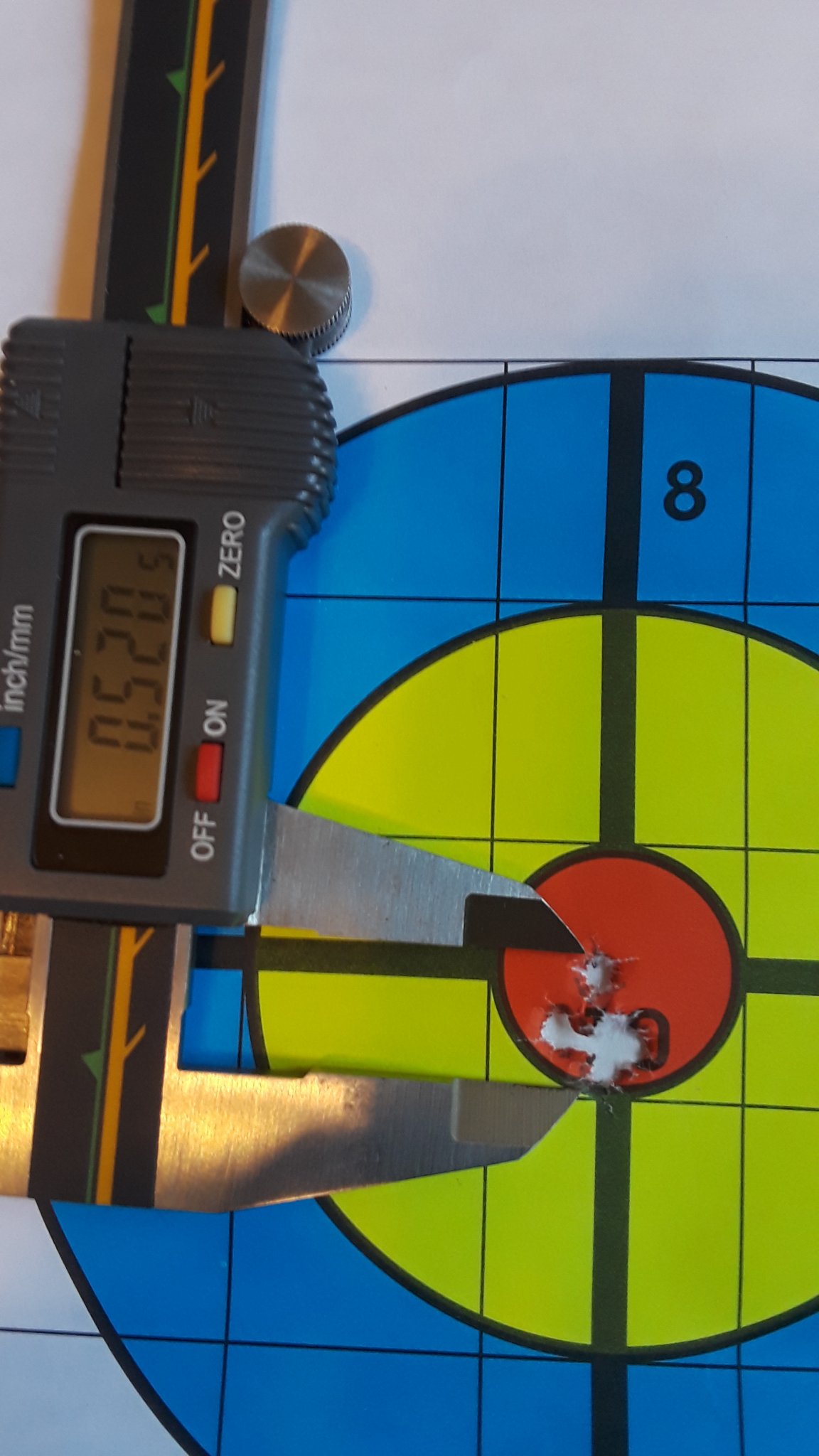

Cci sv in a 10/22 with a shaw barrel. This is just the first random pix I found.
The chamber shaw uses works without fail and when properly fouled in from clean will produce average 1 moa no problem.
That special chamber works with any ammo but doesn't produce super tight groops as with a match setup.
But 2 moa, not at all.

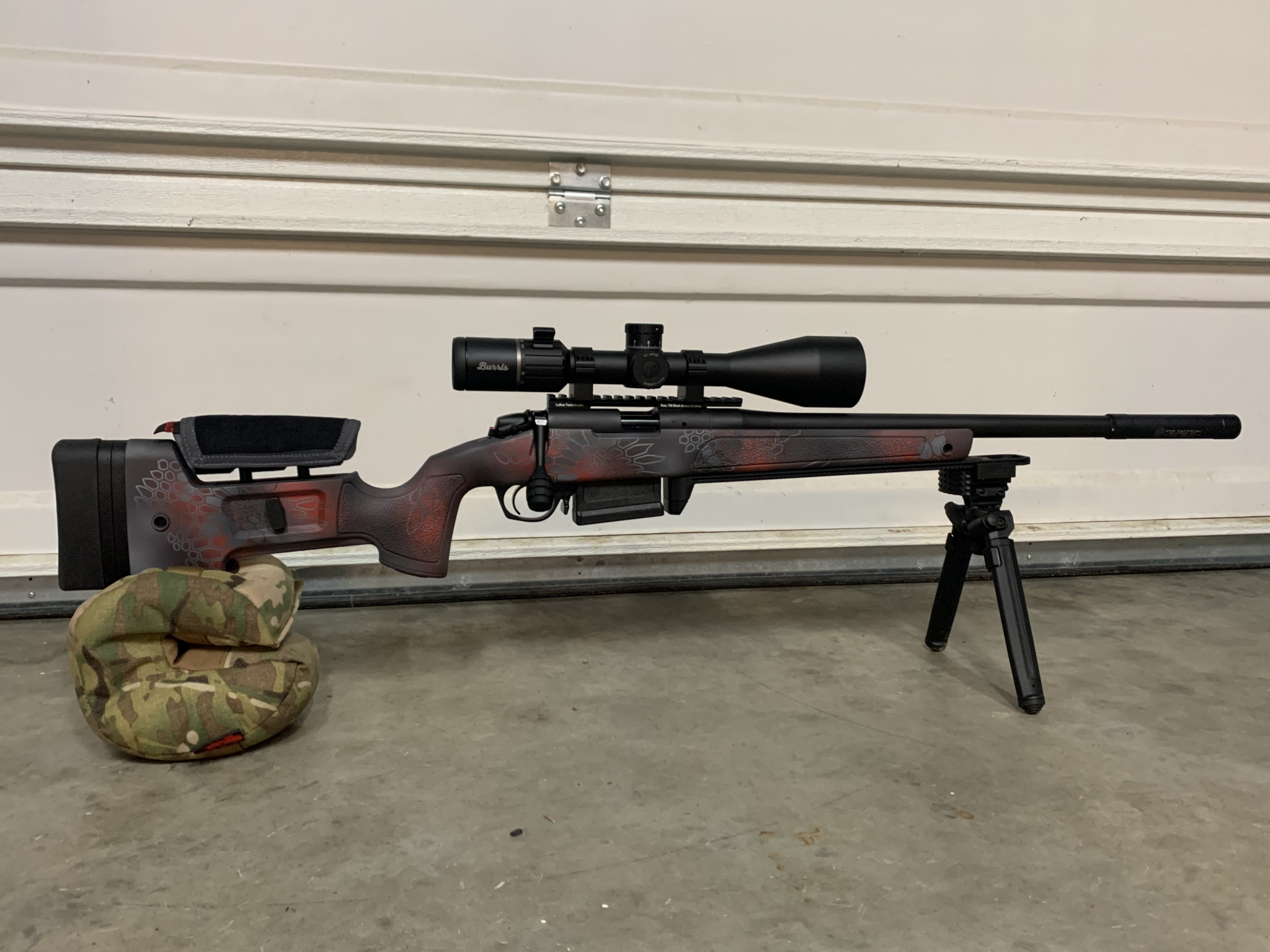

You won't be disappointed in the Bergara. I sure am not in mine. I just ordered a Vudoo as I want a Vudoo as well. That being said I out shot 2 Vudoo's at this past weekends NRL22 Match. Those same guys will be there on the 21st and we will see again how well I can do. In match conditions the shooter causes his misses. I had a BAD Match for January.
Awesome looking rifle -- And I really like the Arca rail.
Using an Arca rail is the main reason I was considering the KRG Bravo.
Which rail are you using?

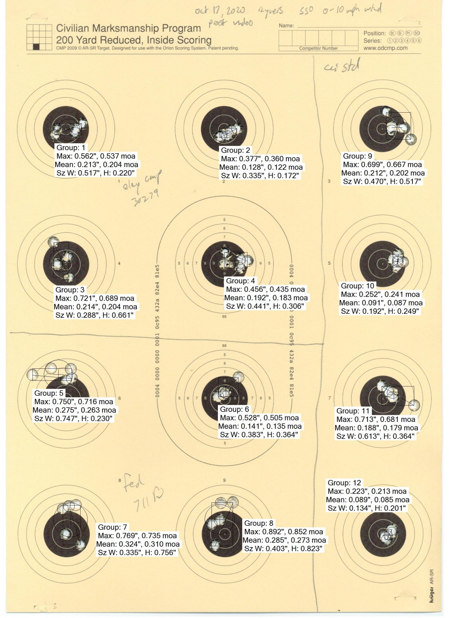

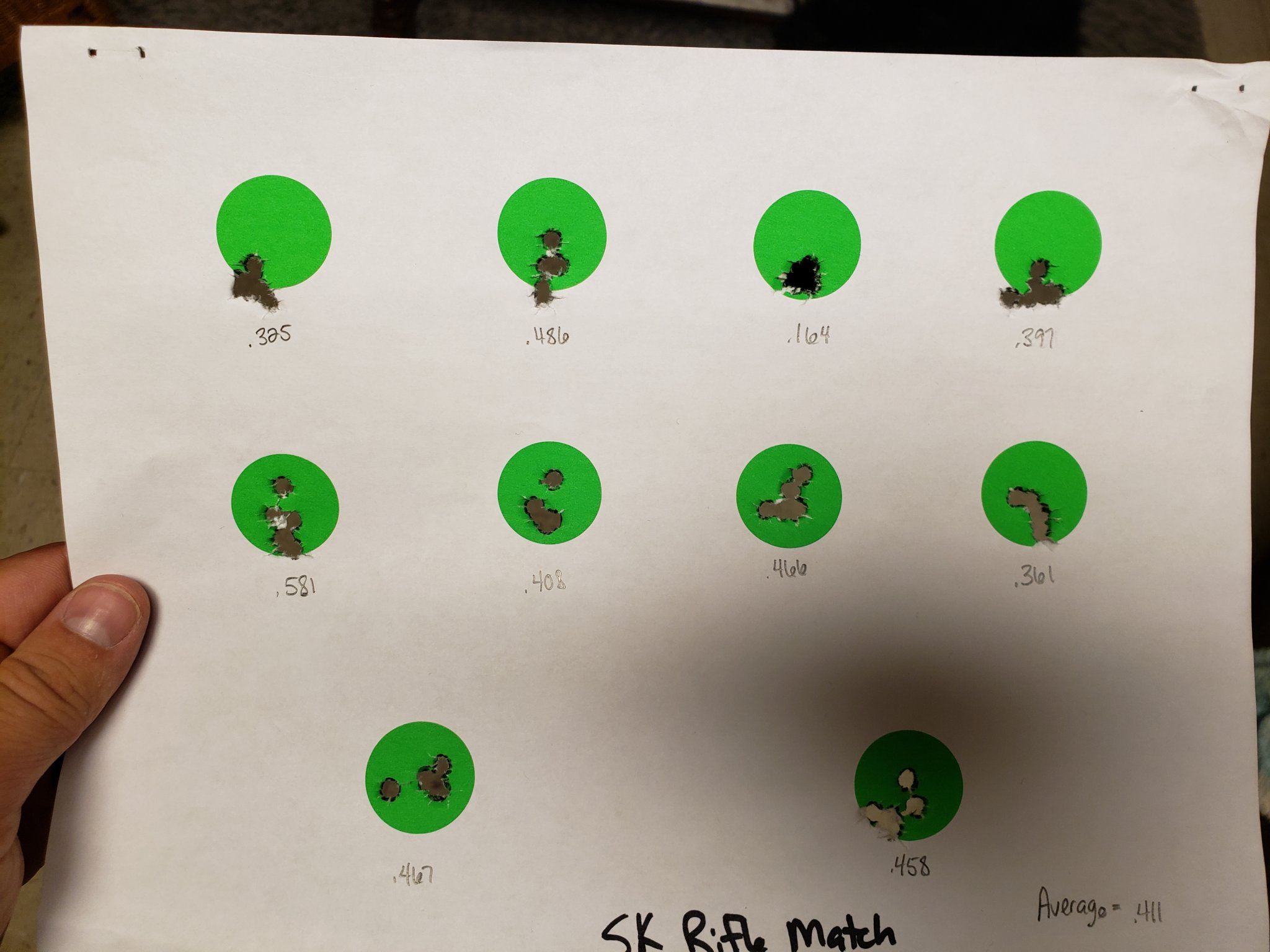

Here are my results.
I will say that at 100 and beyond the CCI doesn't hang in there with the match ammo from my experience, I try to use it for up close or plinking steel only.

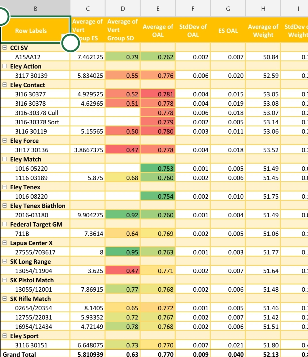

What a lot of folks don't know about Vudoo is that they are not really a production rifle shop. I talk about this some in the review I did of the v-22 this year. They have "models" but most rifles are made to specific customer specs and not built as standard models to be sold later. As such, they can build with whatever chamber, barrel, stock, trigger, etc. that you want. They also have the knowledge to help you choose. If you want to optimize for CCI std, you can do so. Vudoo's house chamber, the Ravage, is optimized for the Lapua Center-X family but many customers order with chambers optimized for other stuff such as the Eley EPS. For what it is worth, the CCI std lots I have shoot fine out of the Ravage chambered Vudoo I have with only a few harder bolt closes. I suspect different lots of CCI are the reason some have an easier time than others feeding it into a Ravage chambered Vudoo as I really doubt there is much difference in the Vudoo's and CCI varies a lot from lot to lot. For my part, I shoot a lot of CCI Std and Eley CMP out of my Vudoo for practice and playing around while using lot selected Center-X in matches.
Anyhow, you can get a chamber optimized for whatever you want in a Vudoo so it is not about whether a Vudoo will do the ammo you want but rather about choosing a chamber optimized for what you want.
Here is what the CCI looks like at 50yds. As many have mentioned, it does not have good velocity consistency (ES's of 50+fps) and falls apart after that.

Perhaps one of the peculiarities of CCI SV ammo is the average bullet diameter. About 15 years ago, Steve Boelter published The Rifleman's Guide to Rimfire Ammunition. Although it is now outdated in many respects, including the discontinuation of many of the ammos he compared, his data included bullet diameter measurements. While his methodolgy may not have been the most rigorous (Boelter selected ten random rounds from two boxes of each type of ammo compared and measured various aspects of the ammo), his data indicate that CCI SV bullet diameter is on average greater than most other ammos, even the no-longer-available Lapua Midas L and Master L ammos which were made to a larger diameter than Lapua Midas M and Master M varieties.
I haven't measured any CCI SV ammo as I don't use it very often. Below is the measurement data for CCI SV from page 72 of Boelter's book. A wider than average bullet would add to chambering difficulty.
So 3 different chambers that I am aware of, I think one more type out there but not familiar with it.
