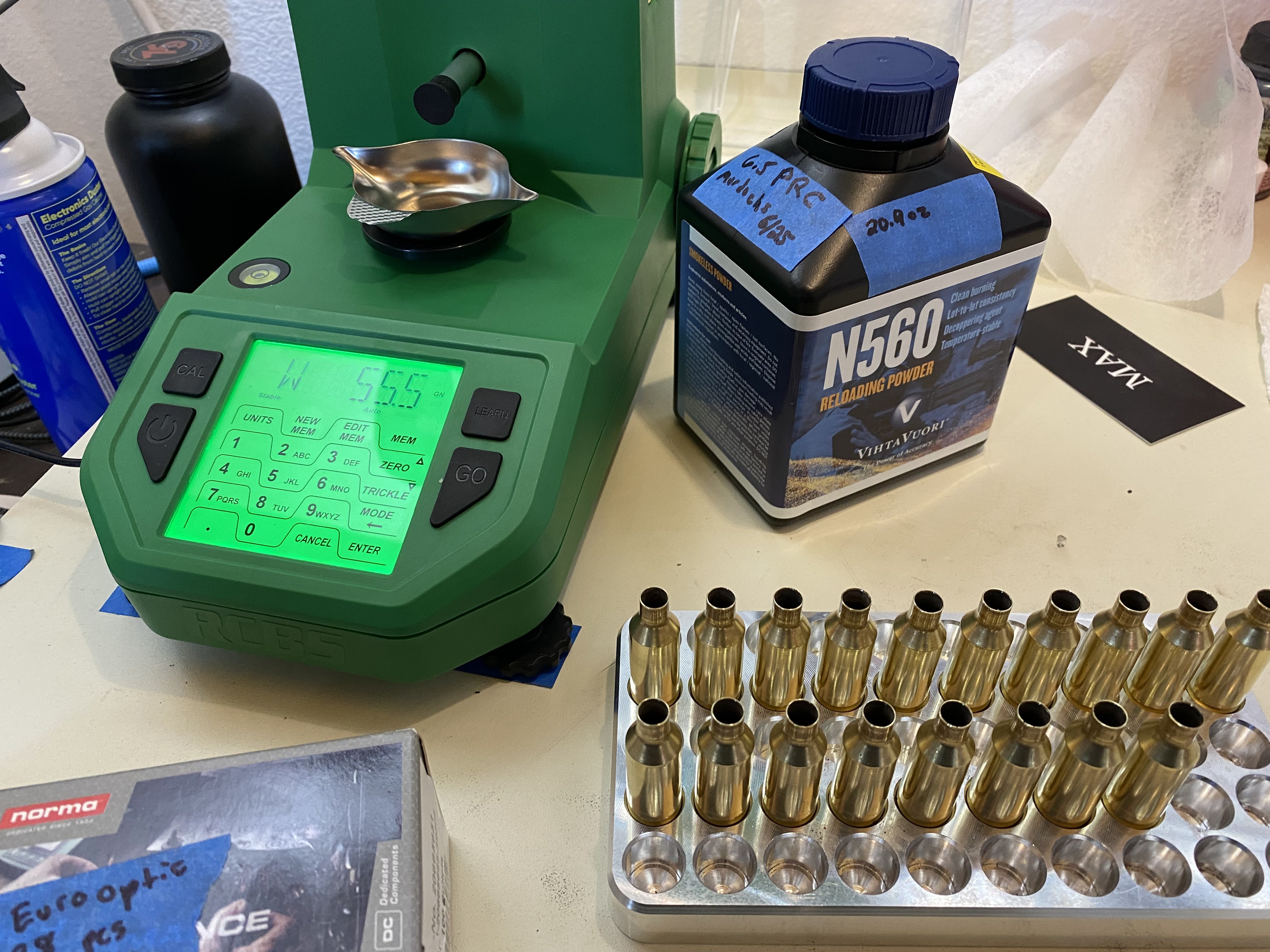

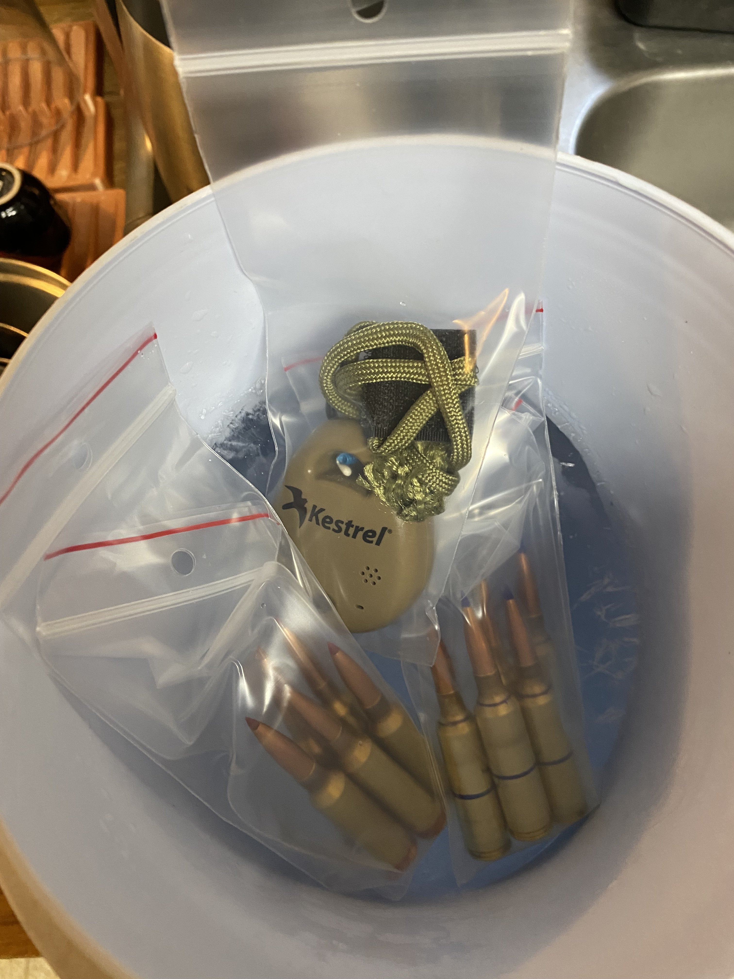

    I just ran a side by side controlled test with N560.
    Rifle: Seekins 6.5 PRC
    Chrono Garmin
    Ammo temp soaked over night.
    38° f 2962 fps 5 shot average
    75° f 2992 fps 12 shot average
    Difference: 37° f - 30 fps
    A cursory google search confirms my results are commonplace.

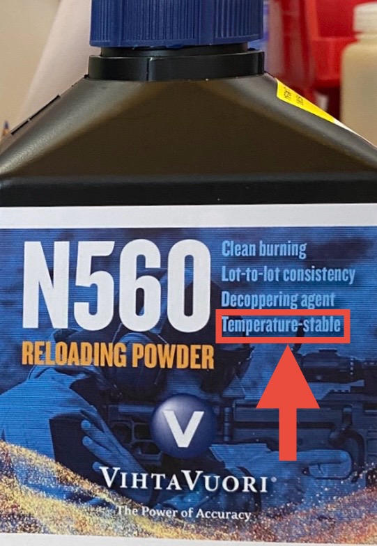

    Putting “temperature stable” on new N560 bottles confirms that Vihtavuori thinks that breathing and lying through their face, are the same thing.
    That said, in terms of accuracy, speed, lot to lot consistency and SDs, I am exceedingly happy with this powder in my 6.5 prc. Since this is a hunting rifle shooting big game animals up to and beyond 600 yards in temps from 85°f to below 20°f, it is important to acknowledge and account for these fps variations. Denial is not a river in Egypt.
    Oh and I find this powder tends to jam in the area 419 funnel unlike H4350 and others.
    Chrono Garmin
