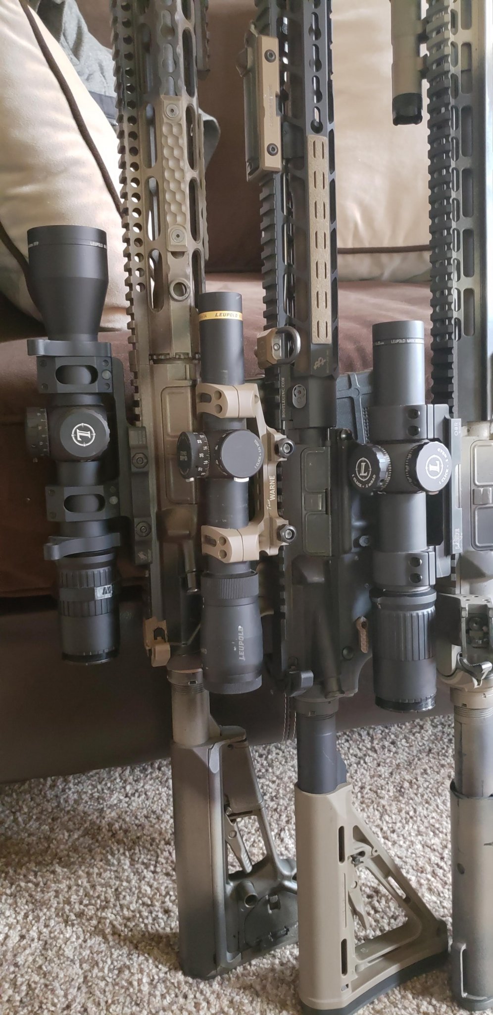

    Truth be told I wasn't a big fan of the RZR 1-6. The two that I had weren't as "flat" as I'd expected. Looking through the glass, there was a very noticeable distortion around the outer edges. This was my first leap into quality optics and honestly it left me wanting. And After some experimenting with the trijicon 1-8, which I wasn't real impressed with either as far as cosmetically, I went back to the Rzr due to its track record of being bomb proof.
    Shortly after that, I ended up picking up the VX6HD 1-6 multigun for my wife due to its weight and fell in love with it. IMO the glass is much better than the RZR; it it has a flatter picture, bigger eye box and much more forgiving eye relief. Although the Illumination is far less than spectacular, the weight and glass definitely outweigh the cons. I took it into my local shop and they all had to get a peek through it and all seemed pretty impressed with it.
    I have since sold the RZR and while looking for a deal on another VX6HD I pretty much stole a MK6 1-6 and have been wowed! I'd take either Leupold over the RZR any day.
    The gist of it all is I can't say enough nice things about the VX6HD 1-6. The only down side is the Illumination and the Illumination buttom. With $200, Leupold said they could convert the button over to a dial. Making the $1300 price tag turn into a $1500 price tag. If you can find one on sale you won't regret it.
