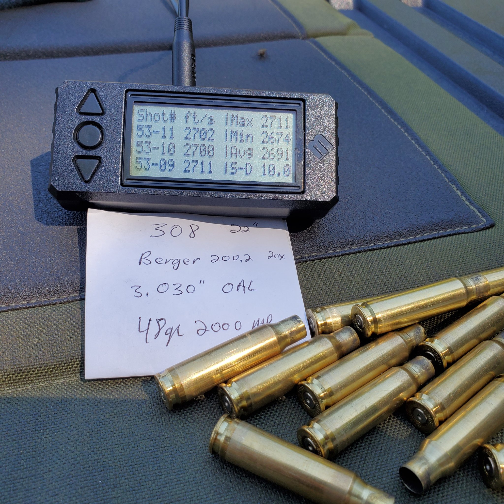

Loading some Berger 215 gr and 208 gr.

22" barrel 308 Win 200.2 gr Berger 2700 fps, 2740 fpswith SMK 2940 fps 168 gr Berger, 2576 fps with 225 gr eldm. 2550 230 gr SMK. 250 gr Atip 2319 fps, 155 gr 3100 fps...all from 22" 308 barrel.
