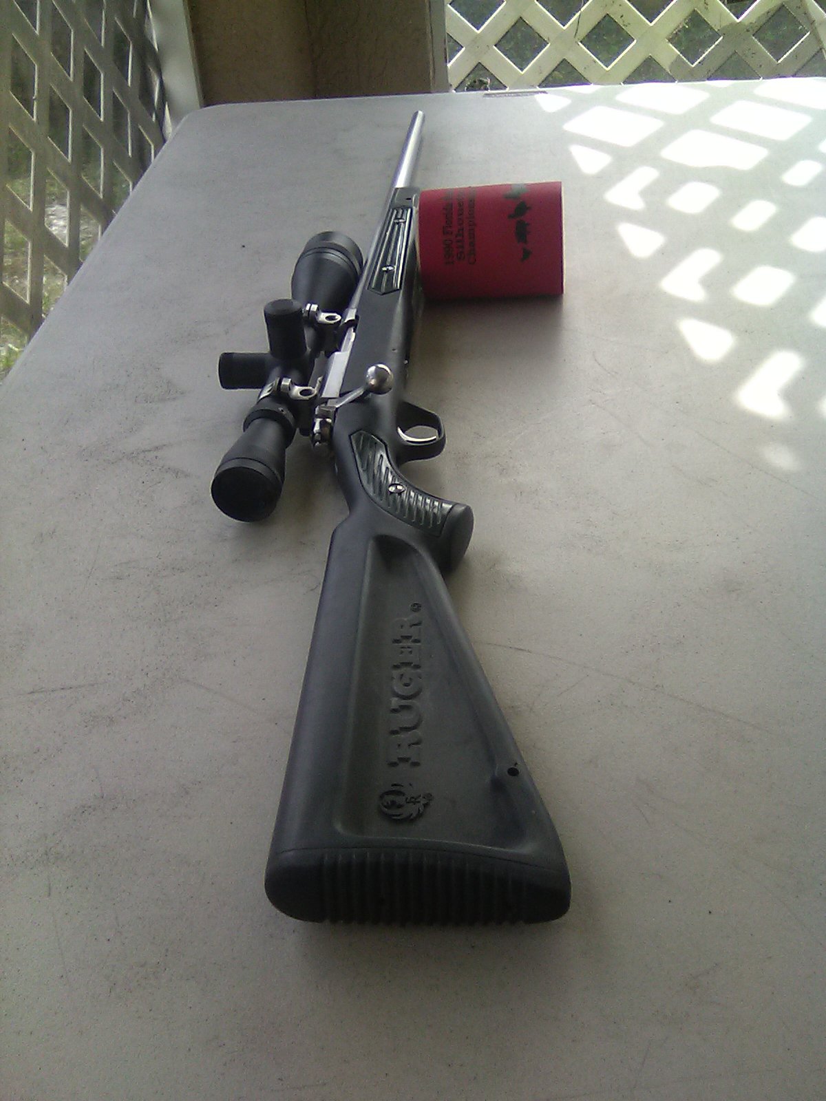

My rifle i a Ruger 77/22 all weather that the stock has ribs that you can't bed the barrel
The receiver on the all weather has no trigger guard so a different stock would cost to much
thinking about a different way to use the POD

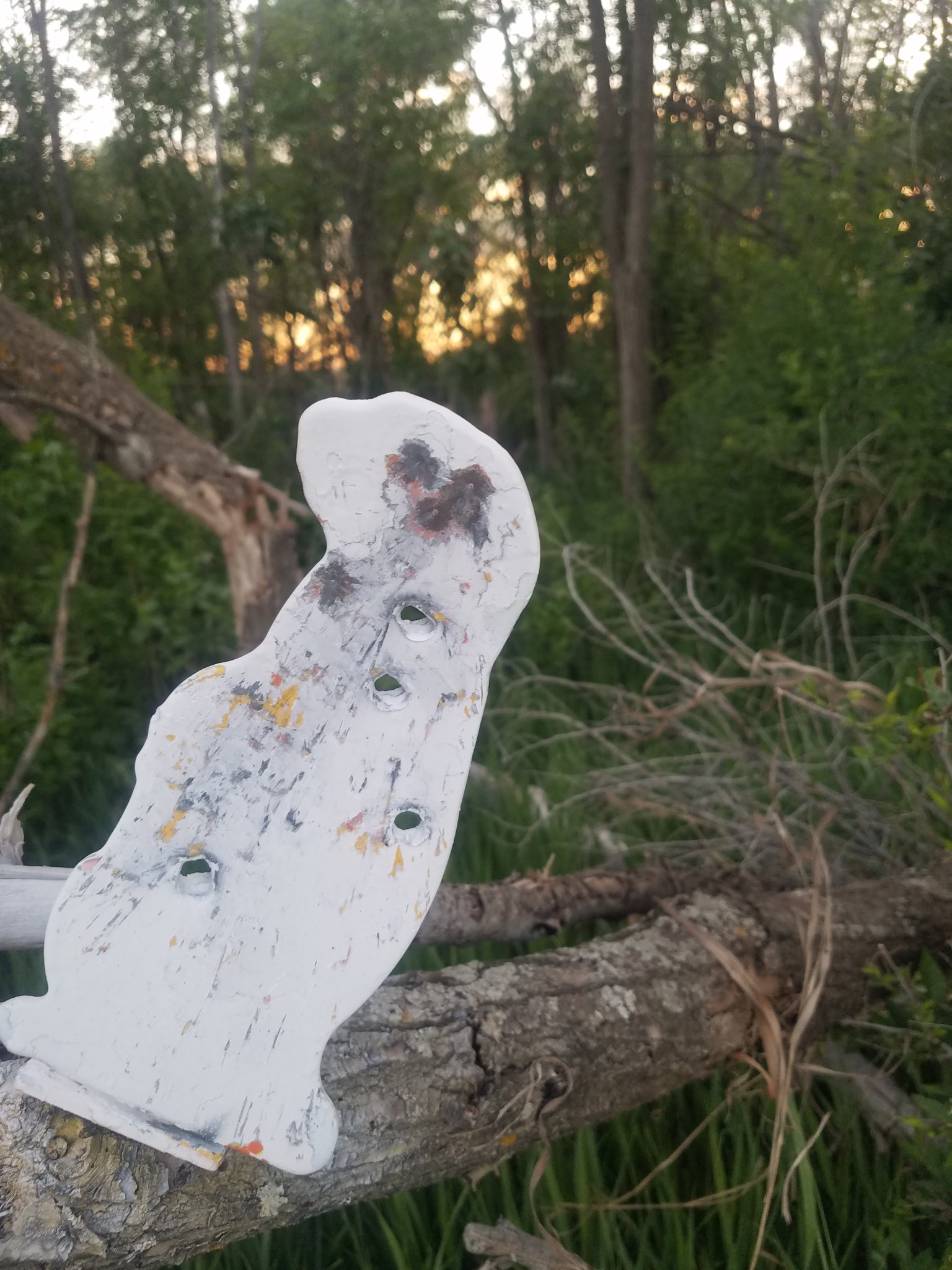

My all weather is one of the best rimfire rifles I've ever owned....period. To include $1-3K customs.
This is what my truck gun does at 94yds off a pack and no rear bag. 1 low...corrected...then 5 in the head. Only mod is a timney trigger kit.
I've seen plenty of meh ones for sure. But mine is awesome.

Looks like my setup leopold 6x18 target scope .
I have a weigetenny pick rail to mount scopes and red dot .
