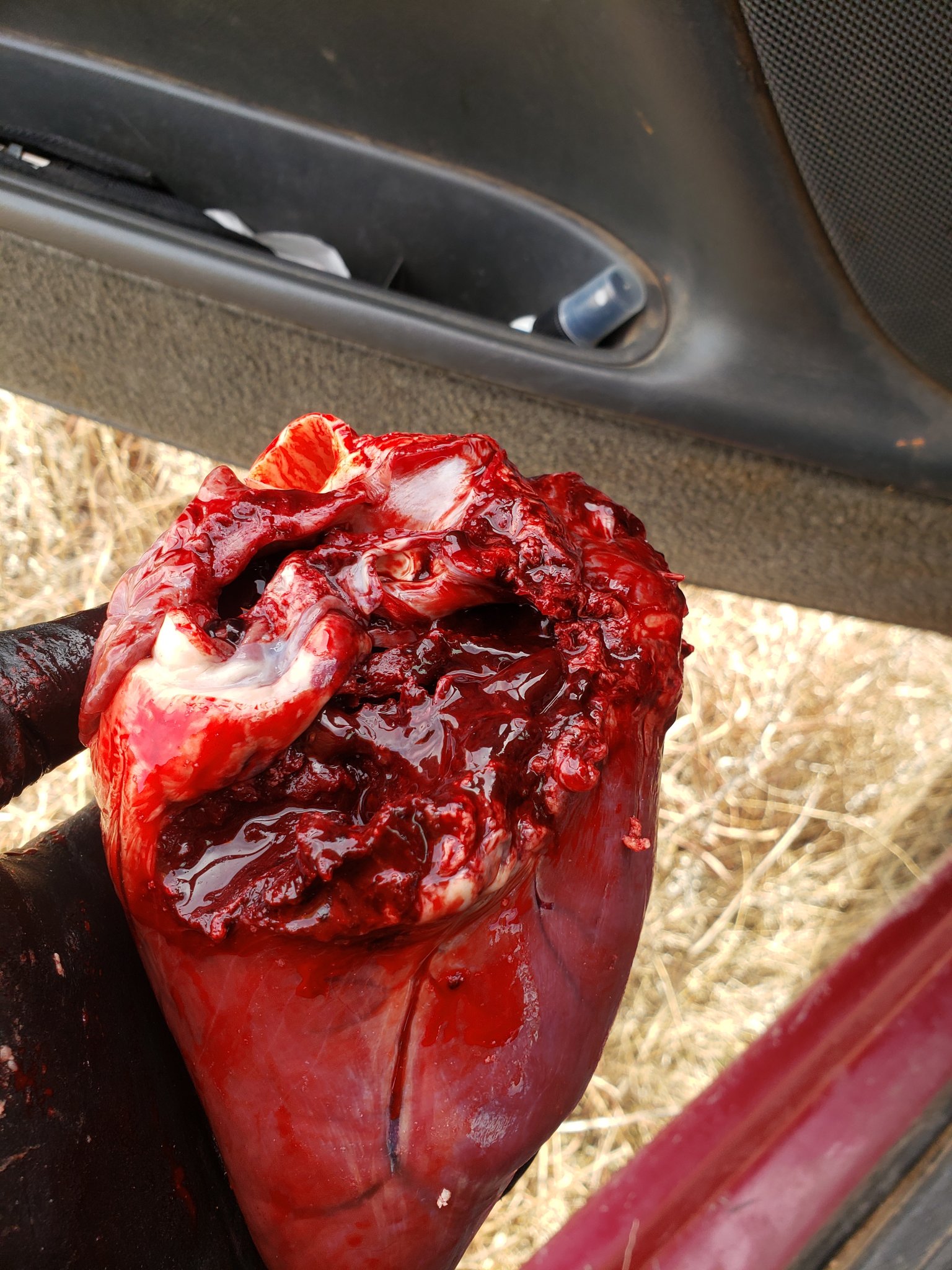

    140gr and 147gr eldm perform well on game. I kill several hogs and 5-6 deer every year. Last year I used 140gr eldm and 147gr eldm the three years before that. These bullets expand like soft points to as far as the 365yds that I used them at. Even close up they hold together fairly well. This is my goto bullet. The hornady 129gr interlock does the trick as well. My son has killed several deer with these.
    This is the exit wound on a doe shot at about 150 yards with a 140gr eldm factory load. Perfect expansion. Shoot all your animals in this spot and they will never take a step.

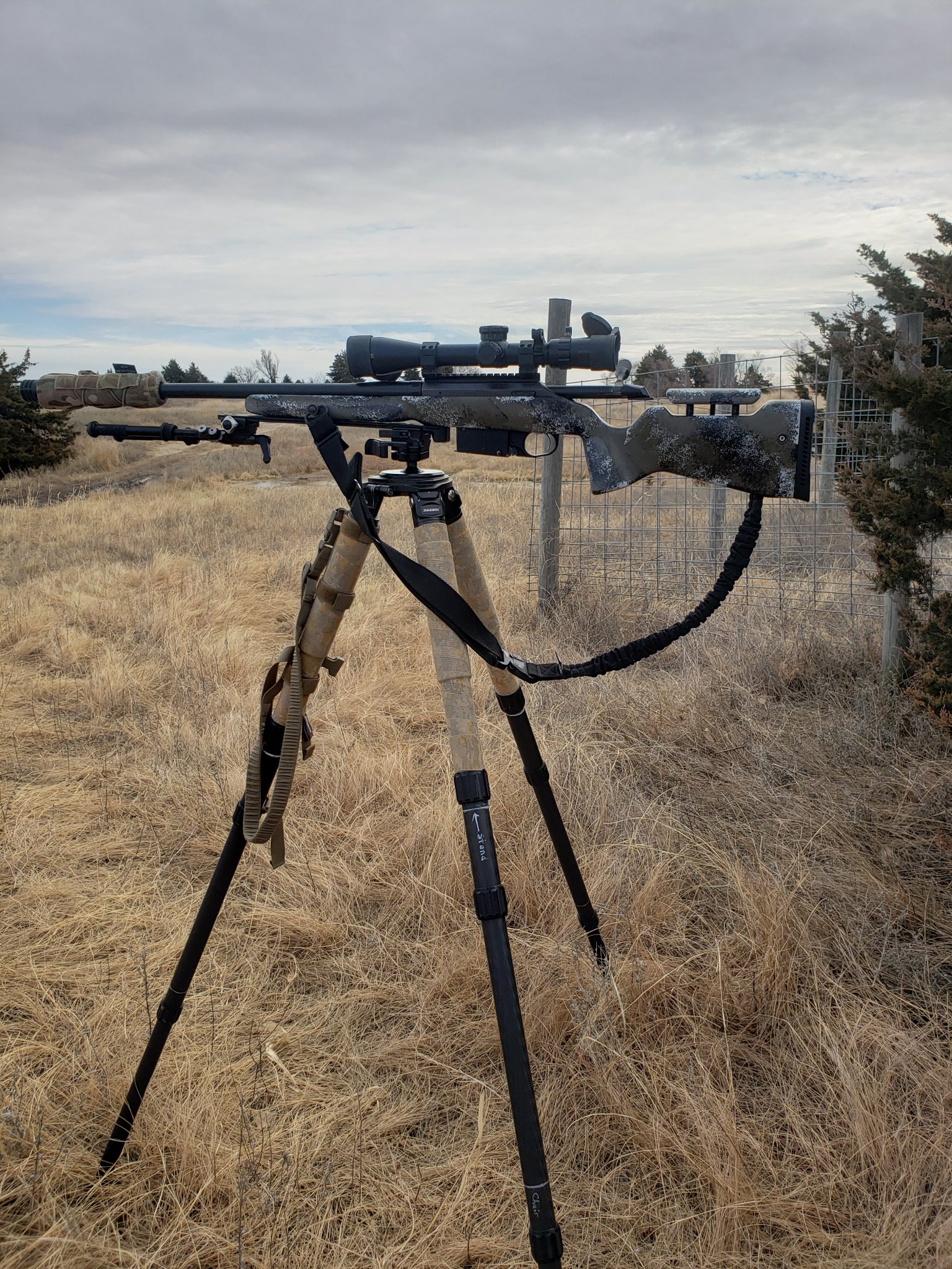

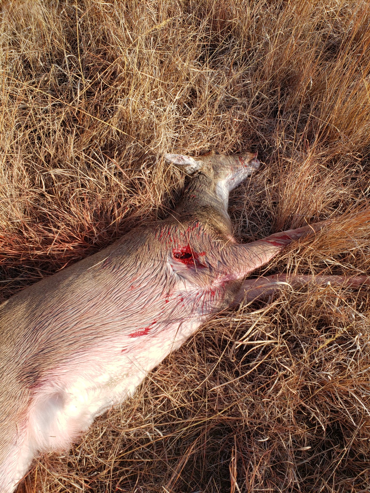

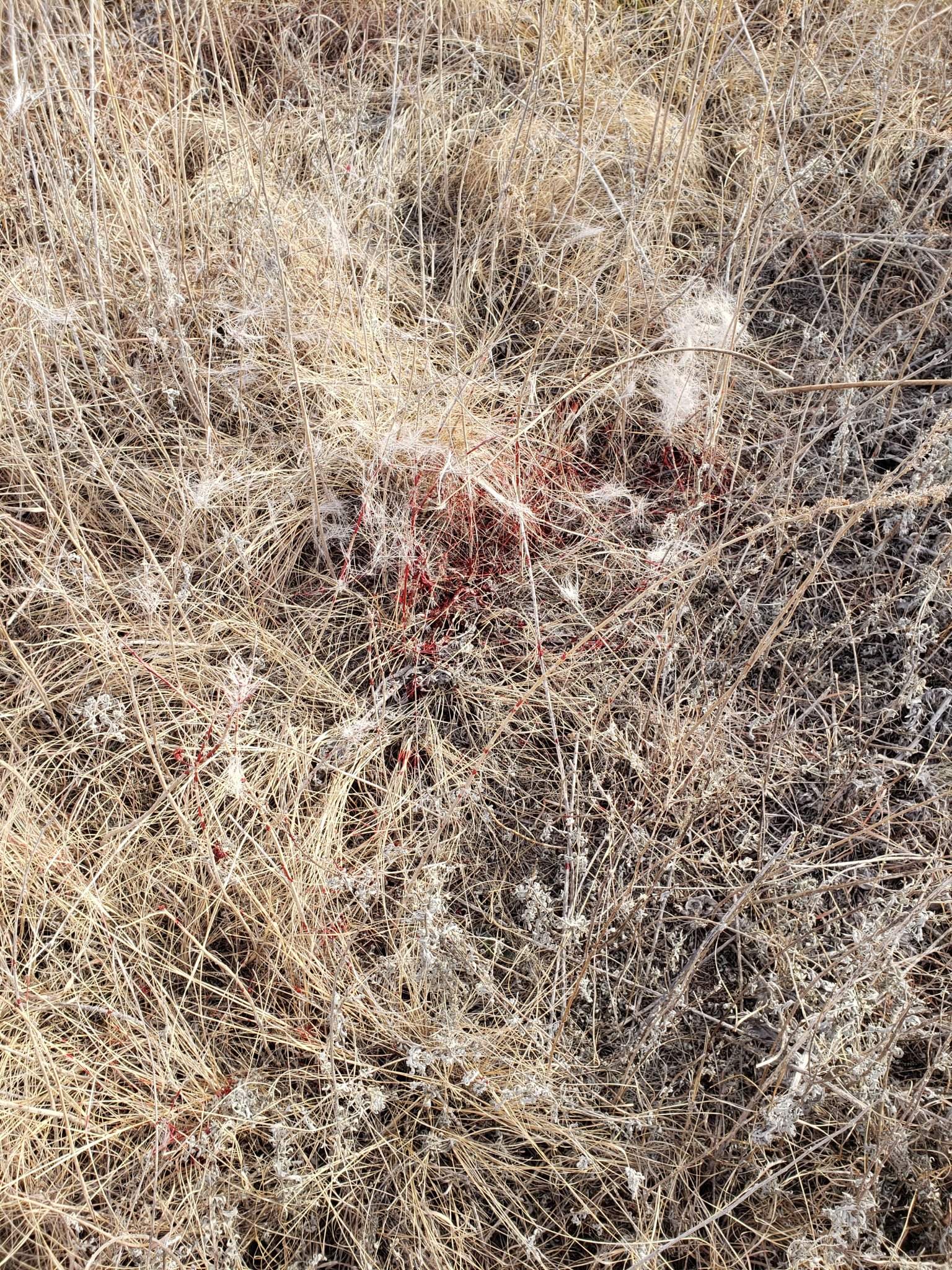

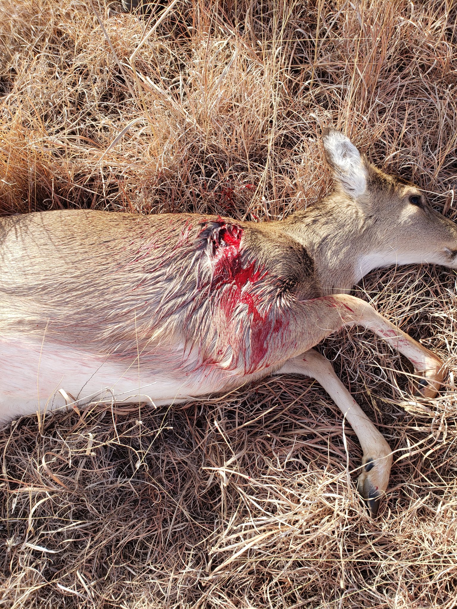

    Here are pictures of 3 of the 4 deer I shot during our anterless season with the 130gr Norma Golden Target that Prime used to use in their 6.5 Creedmoor ammo. I load them and get 2764 fps out of an 18" Bartlein with Rl16 and Peterson brass. These were all shot at 200-225 yards. My sons have used then out of a Ruger American, a RPR and my 20" CTR barrel at 2715 fps to 2835. Always the same results, good exits, good blood trails, shots out to 400 yards.
    Had a 140 ELDM not expand on a 200+ lb buck's neck at 100 yards and had one grenade on a doe at 240 yards. Killed both deer, but wasn't impressed. A friend uses the factory 147 ELDM out of a 24" Tikka and they seem to work like the 130 Norma.
    I killed 4 deer 3 years ago with the 143 ELDX and they all came apart pretty fast. Had them moving a little over 2800 and the shots were 165, 225, 240, and 320. Had exits on all but the 165 yard shot.
