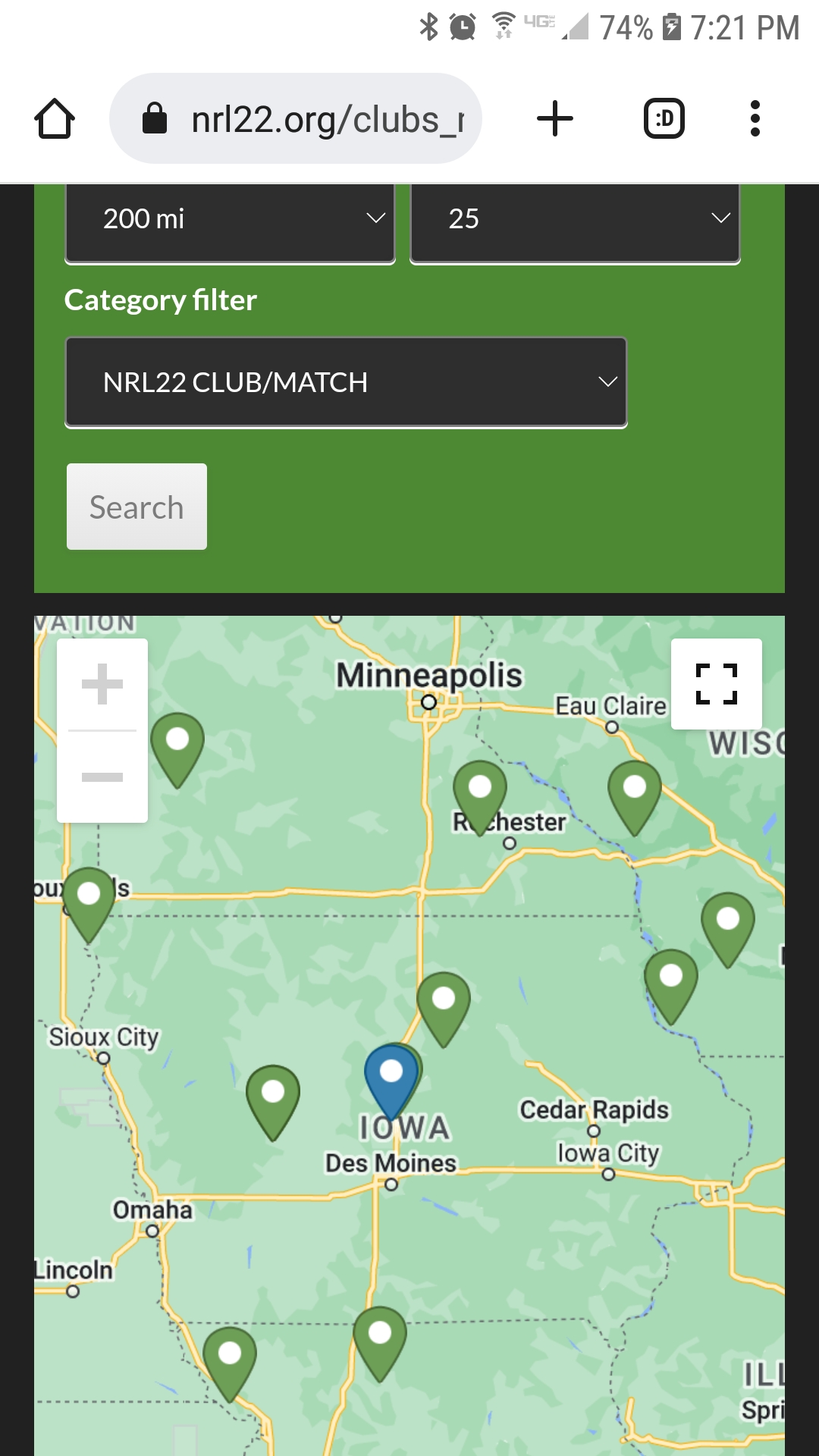

The NRL has a club locator. Just type in your location and a search radius.
Addresses are supplied along the bottom.
The NRL22 has like 3 facebook groups that cover general info and match info. And there is usually local level facebook page/group for every club. 👍
Iowa clubs👇

Do they have a regular NRL schedule? I'll have to look at a map and figure out where Nevada, Iowa is.
Thanks for the info!(y)
Nevada is approximately 1.5 hrs due west of Cedar Rapids on Hwy 30.
