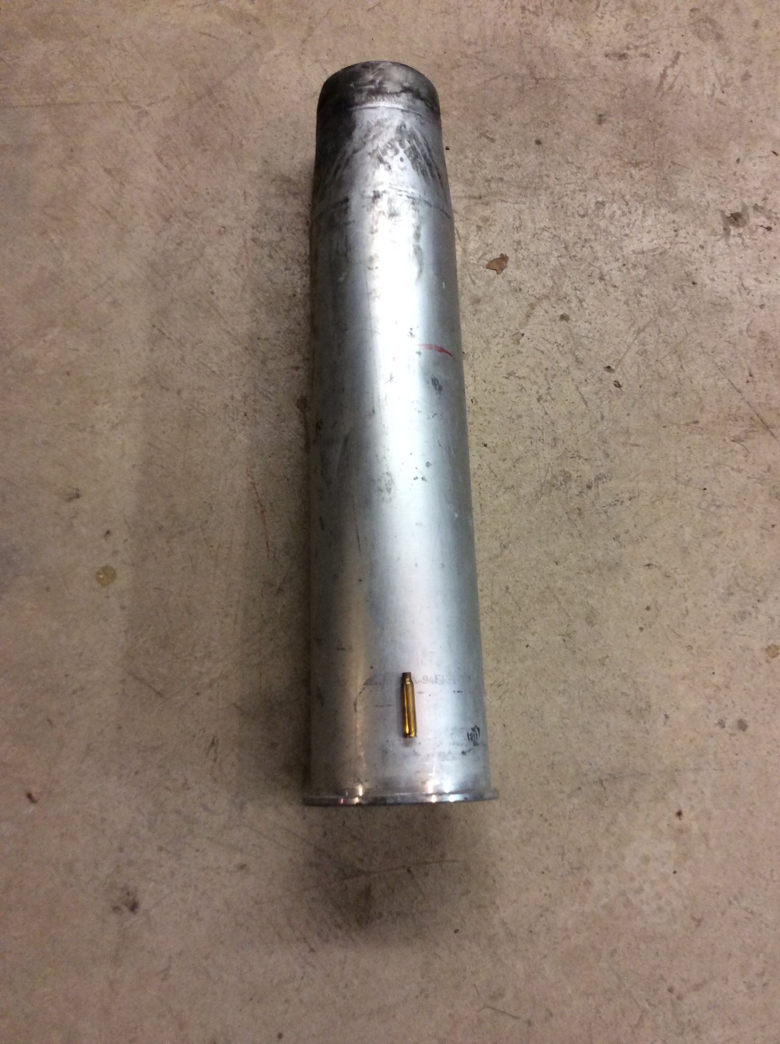

There is a old saying “ No replacement for displacement “
