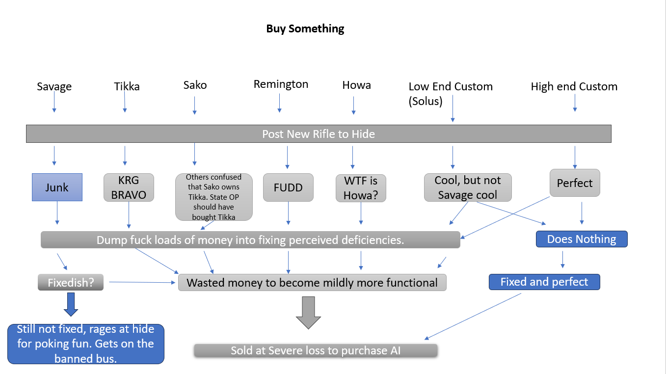

Buy what you really want from the rip
I played with one too many factory rifles, then went to customs.
Guess what happened?
They all found new homes because what I really wanted was an AI.
Now I have the AI and then made the mistake of fingerfucking an Impact action, and now have one of those to.
Life’s to short to not get what you want.

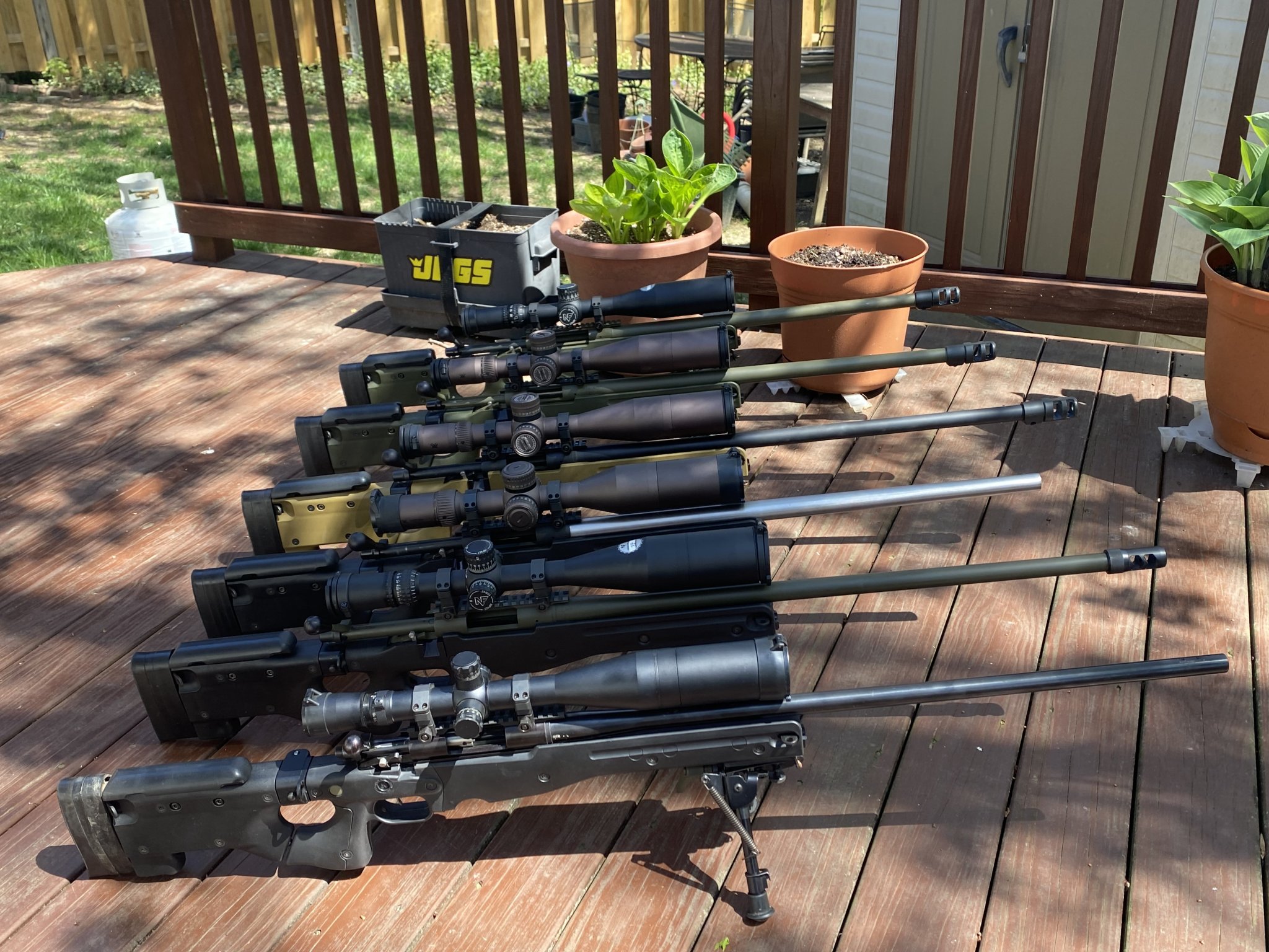

I have every cartridge I'm remotely interested in. But I have 8 308s from 16" to 30" barrels twists from 12,11.25, 10, 9, & 8 twists autos and bolts.
But only 2, 6.5 CMs. I have a pretty good idea of what a 308 case can accomplish...with my modifications, why I prefer it, for my use.

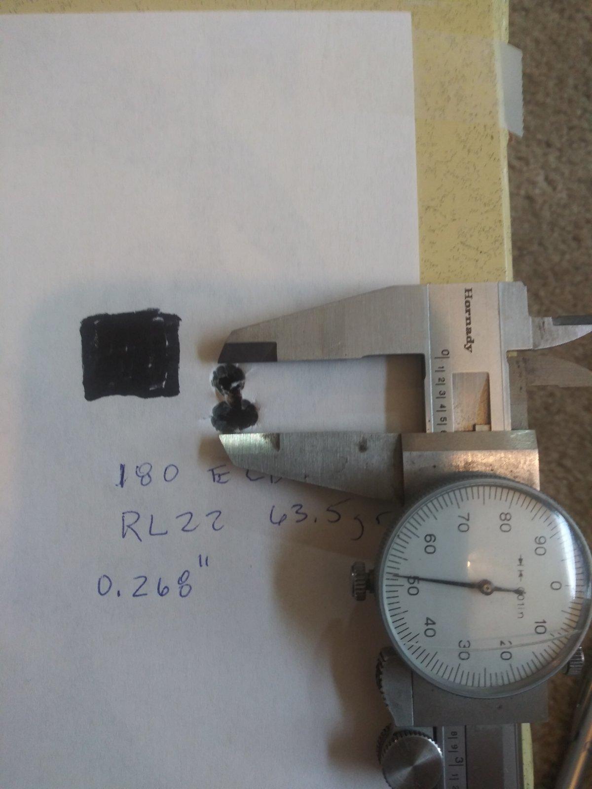

Just bought a new Rem 700 in 300 win Mag for the action. The complete cost was $540 for the whole rifle on sale...cheaper than just getting an action.
Decided to shoot it first to see how accurate it was...didn't like the factory stock so I bought an alum chasis for around $400 on sale, I'll use anyway, along with a modified 700 .590" bolt face bolt.
Threaded the barrel for a muzzle brake I already had, free cause I do all the machining. So for $940 what kind of rifle do I have?
Shot it with some old deterated imr 7828 with 200 gr SMK, I can seat the bullets out to 3.7" in the detachable mag making it more competitive to the 300 PRC.
It shot 5 into 1/2". I was out of that powder and none available anywhere...typical.
And shootin 230 grs SMK to 2964 fps .
Tried some max QL suggested powders and ran 200 gr SMK to 3280 fps at it was too hot sticky extraction primer still intact. but 3200 seemed reasonable.
I would not recommend the 300 Win Mag as a beginner tool, especially for 400 meters, as it uses alot of powder and recoil ya don't need for short distances...
But it shows todays factory rifles can be accurate enough to easily get ya started.
