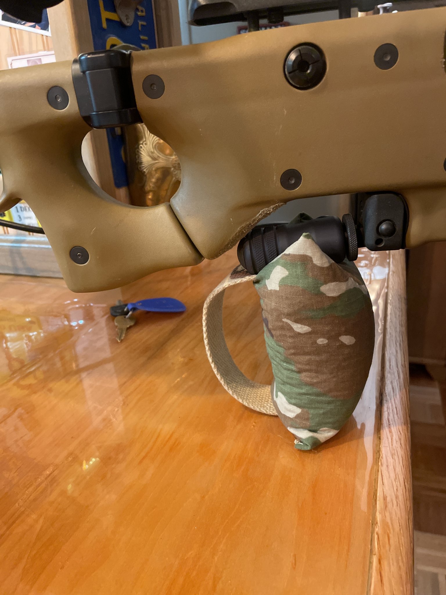

I mostly lay in the grass or gravel and the rear needs to squeeze cleanly for height adjustment. Beans and poly fill work great for this. I only have beans in the old-sock bags so I remember they should never, ever, ever be wet. I have had my dried bean bags for 20+ years, no problems. I think airsoft pellets (and I do airsoft for FOF and training, so have plenty) are a bit TOO slippery, didn't like them as much as I expected.
A friend in the past had a walnut media bag, and it was right in between by my recollection. Which doesn't fit my needs (not stiff enough for benches, tiring to sqeeze) so I don't have one now. YMMV, based on bag material, bag shape, needs, how meaty your hands are, etc.
