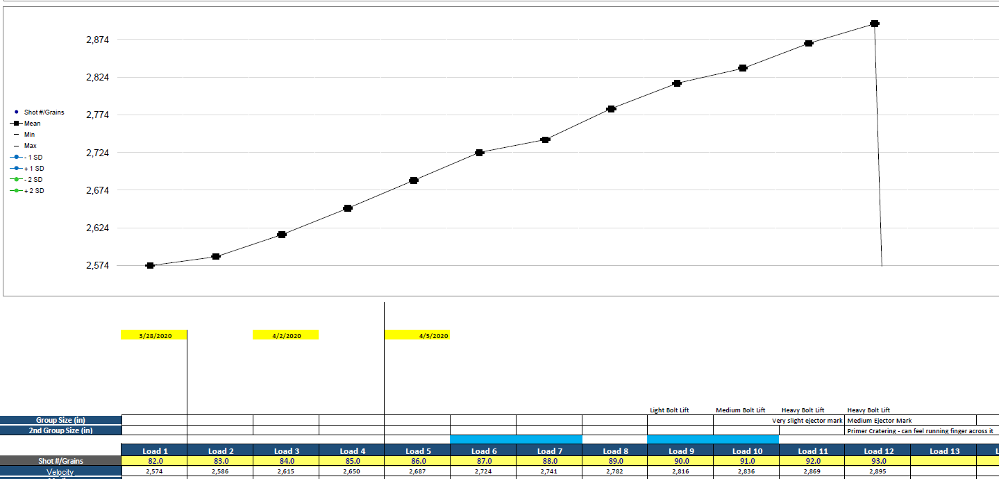

Here is a velocity workup I did using H1000 with the 300 OTMs in Lapua brass: 30" barrel. Loaded 10 tho off the lands. Roughly 60 deg. F. 1000' above sea level.
