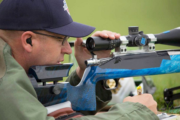

Water might be an issue.
Derek Rodgers is shown in the photo below. He put tape over the bedding to keep water out in case of rain.
I've never thought of it as a possible issue, but perhaps it could be. The next question is what type of bedding compound would be subject to this.
Read for yourself: https://bulletin.accurateshooter.co...crowned-at-f-class-worlds-in-canada/#comments
My guess for the issue above is that once he has it all bedded and secured he doesn't like to remove the action much, or at all. Getting water in there means he'd have to take it apart to dry it all out.
