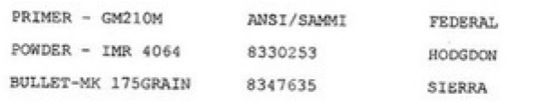

There is sheet that was around about that time from that listed IMR 4064 with powder charge and the Sierra 175 SMK.

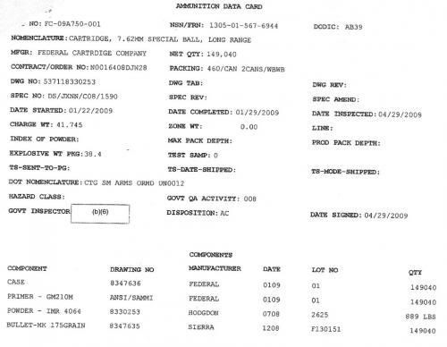

That’s not m118LR, but the mk316, DODIC ab39, aka Federal Gold Medal Match 7.62x51 (not the 308). M118lr’s DODIC is AA11. Those two are constantly confused with each other here.
OP, powder from that timeframe was Reloder 15.
Mk 316 is a version of M118 LR. I will note that somewhere in the teens Federal did apparently switch the FGMM to AR-Comp or something in that range as some deconstructions found a powder different that 4064 with weight in the 39-40 grains as I recall.
Nope. While they use the same projectile, they are two different ammunition products. Easiest proof is two DODICs. Brass, primer, and powder have always been different from each other, and AB39 came into supply existence to alleviate some issues with AA11 (temperature).
FGMM (308) and the mil load product (7.62x51) have always been different as well. Different powder, charge weight, and performance in the shorter barrels - with a significant higher speed with the AB39.
OK folks...lets put 2+2 together :ROFLMAO:
The Federal Cartridge Company was awarded the contract and the ammunition was designated the M118 Special Ball Long Range Mk316 Mod 0. Like with the M118LR, the name was just modified to keep from having to go through full classification for the new ammunition.

Two different ammunition products. Go to an ASP with a request for AB39 and see if they bring you anything with AA11 on the box, or vice versa.
It is 2023 now, and I am not sure the current status of it, as my time around both of these products consistently concluded a few years back. That said, I have held in my hand BOTH, separate products up to circa 2018... Lake City 18 case for the 118LR, and FC 18 for the AB39...out of two separate boxed products marked with two different DODICs.
OP’s question was in regards to LC10 118lr. At that time, AA11 was loaded with 43.0-43.1gr of Reloder 15, Lake City case, unknown manufacture brass colored primer, and the projectile was seated and sealed with the tar sealant. AB39 was different in every way except the Sierra 175.

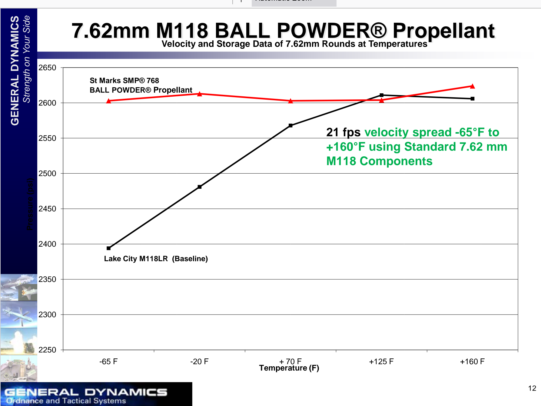

Actually M118LR, the one using Lake City brass, was loaded with St. Marks ball powder, SMP768.

Could you clarify as to what you mean?
PDF seems to show that SMP(r) 768 was a comparison for a proposal or incremental change (red line), but was absolutely not the Lake City Baseline (black line).
Nothing in this deck states this powder was actually being used by Lake City in production. You may be absolutely correct, but the slides just aren't thing the same way you are.
You’re right. And St. Marks pretends this powder doesn’t exist when you call them.
