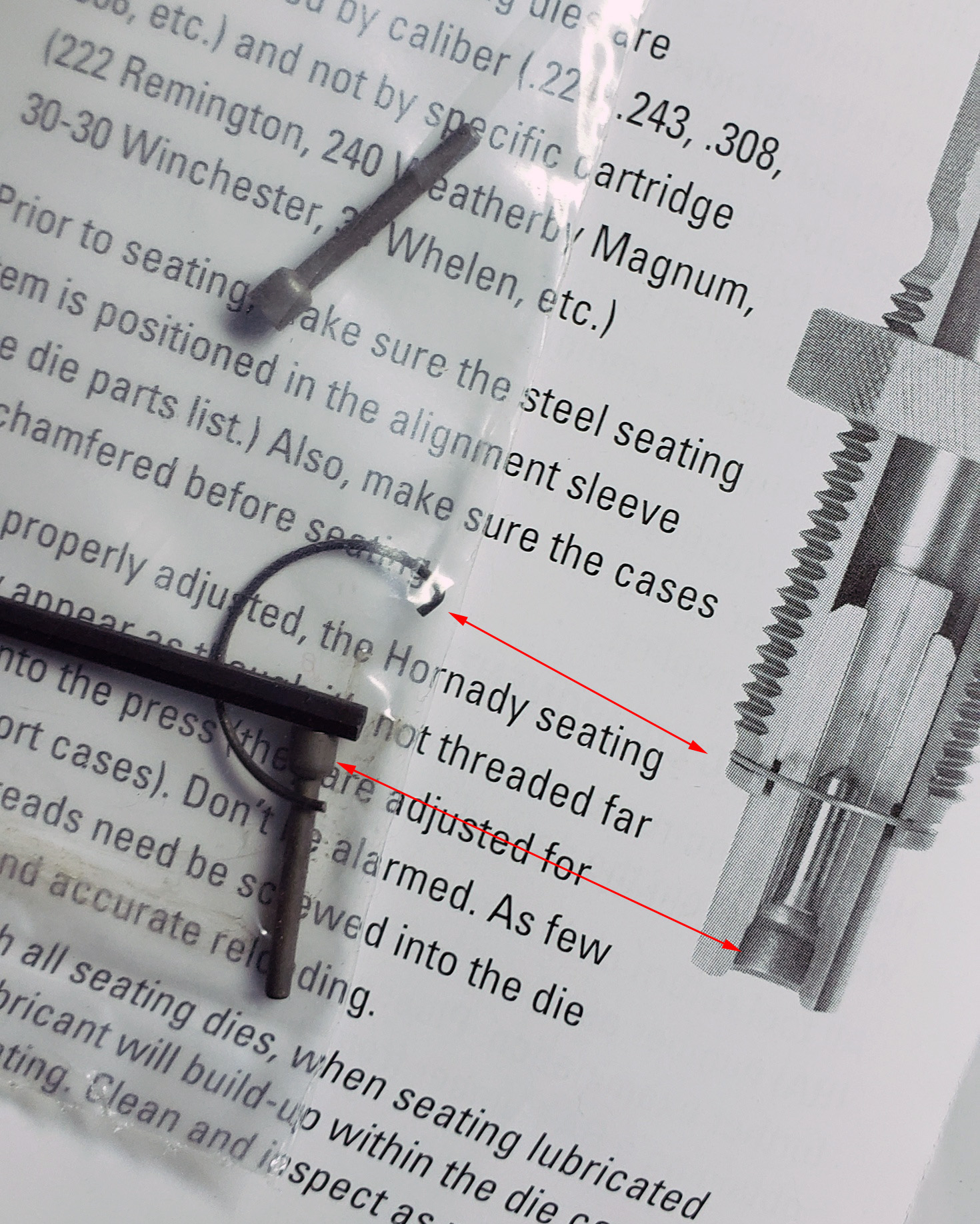

    Can someon please tell me....
    The literature does not do a good job of explaining this.. but what are these things?
    Never had them in my RCBS dies.
    The C-clip is a spare retainer for the sliding sleeve in the seater. The others are spare de-capping pins, usually they come with the full die set.

    So a tip for you. That C clip that you were asking about. Later on down the road when you get a seating depth you like you can remove that clip and remove the sleeve and stem that way and not mess up your seating depth by unscrewing the top end.

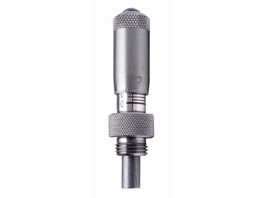

    PS You mean a micrometer seating die for the hornady 300 prc like this?

    Yeah man A-Tips for a new reloader are like a Ferrari for a four year old. It will be a little while before you are able to get much out of them.
    And yes that micrometer seating stem is pretty handy. Otherwise you kind of end up dicking with your die when you go to change seating depths. The microjust saves alot of time and annoyance.
