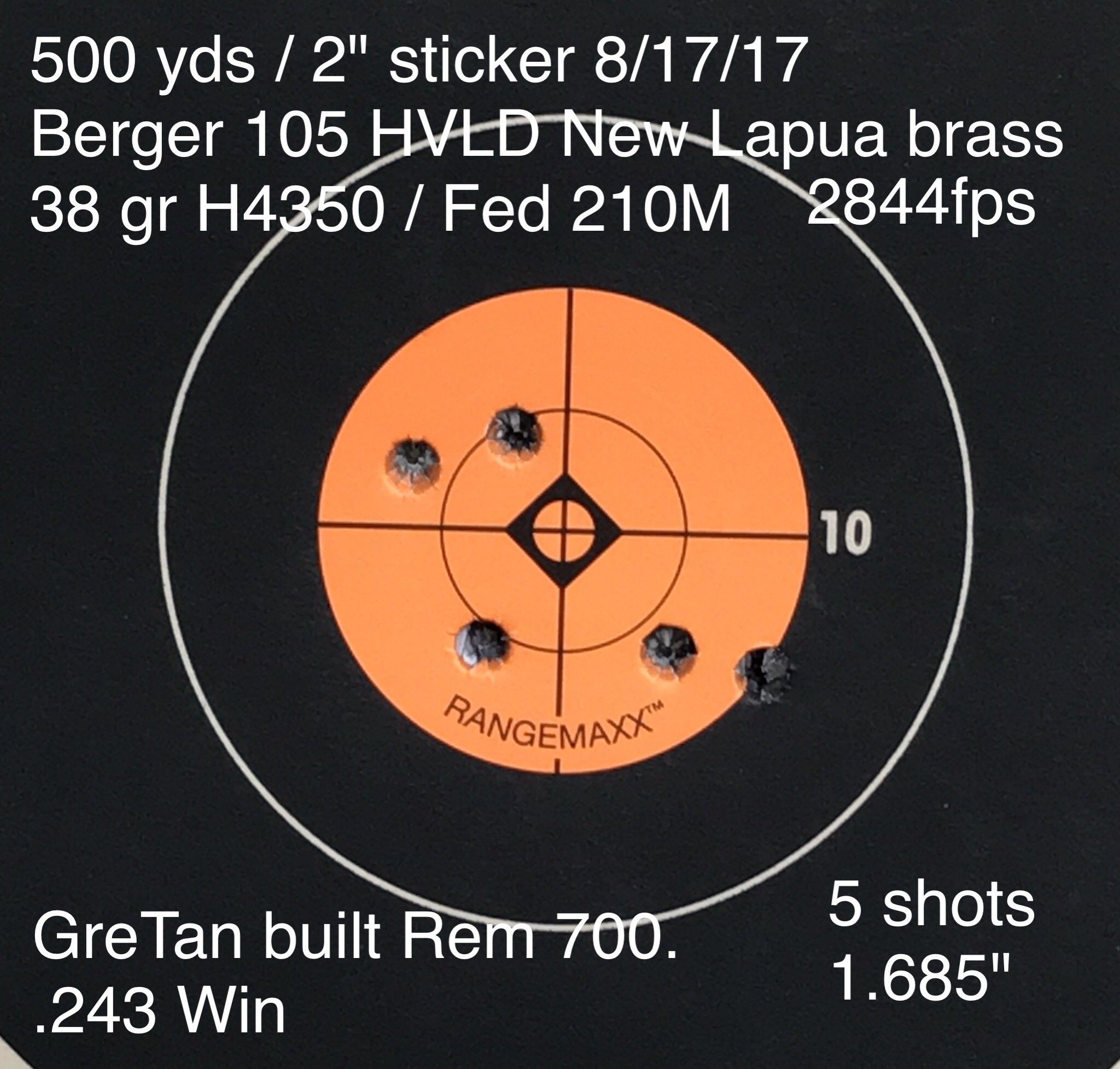

I went 2992 rounds on a 24" 8 twist, 243ai. Nosler 105rdf @ 2820fps. Yes it's a low node, but it shot awesome. I was able to run it at 3150fps but the normal brass didn't like it. Eventually went 308 Palma small primer, necked to 243 and inside / outside neck turned. Worked great.
I've since rebarreled to a 26" 7 twist, same brass. Only just done, and so far 108eld-m work well. Once I hit 150/200 rounds I'll be able to report how well the velo / node works
