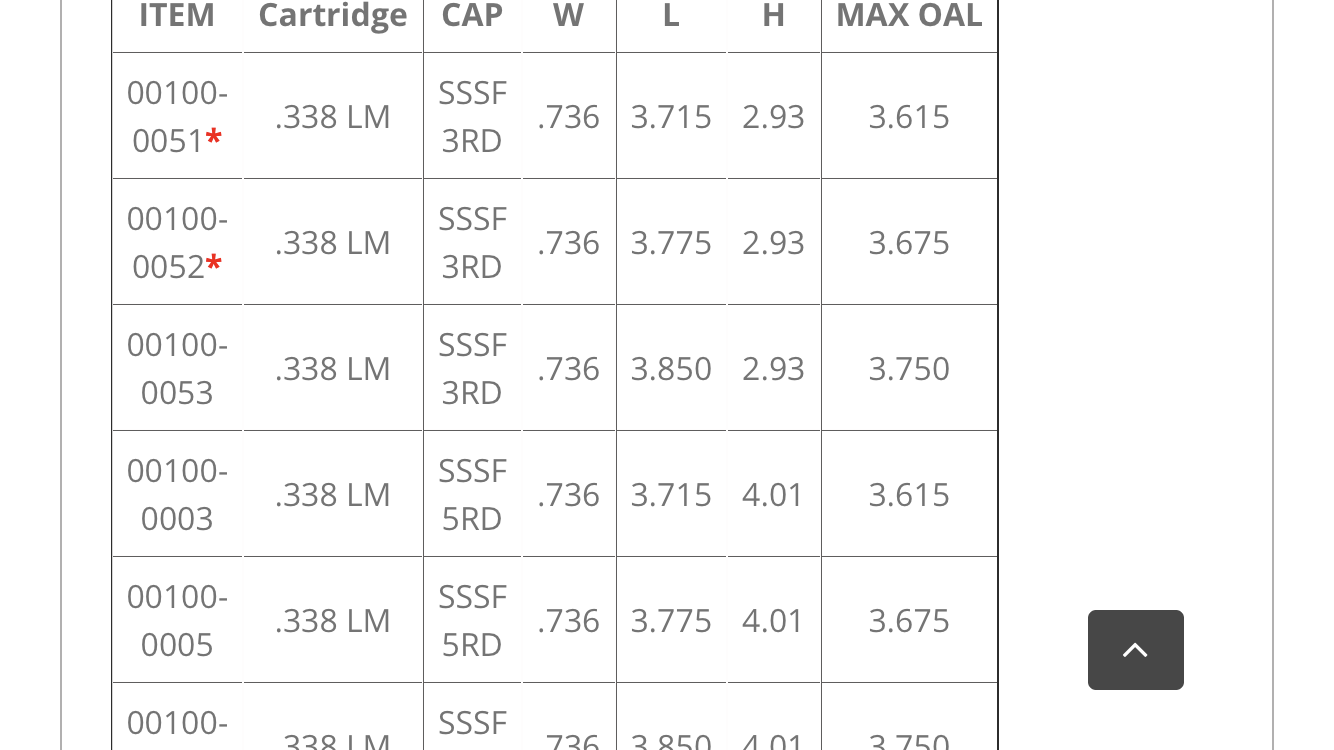

    I'm getting into a 338 Norma soon . I have a Manners and Defiance bottom metal that accepts standard 300 WM magazine. Is my bottom metal going to work with the appropriate mag or do i need different bottom metal ?Seems like the only mags I've found are CIP or AW .
    If your mags are the 3.775” length such as a standard (not CIP) 300WM Badger Ord M5 The accurate mags Lapua magazine in that length only gives you 3.675 COAL so likely to work
    Only Defiance bottom metal I’ve seen is a BDL for Rigby that will load out to 3.850” COAL so if that’s what you have you’ll be good to go.
    Edit to the above The Badger uses the 3.650 COAL mag, your defiance may as well in which case you would be ok just not optimal. Are your mags 3.775” long?
    Edit: you would still need to get the appropriate sized magazine
