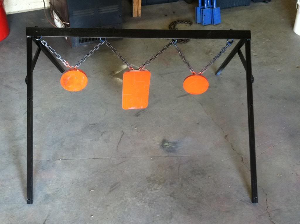

    The last target we made was made from 2 pieces of 3/4" plate and one piece of 1" plate welded to separate pieces of round tubing. That tubing is slid over a slightly smaller tube mounted to the frame of the stand. The targets are free to swing, with none of the flopping around like they do hanging from chain.

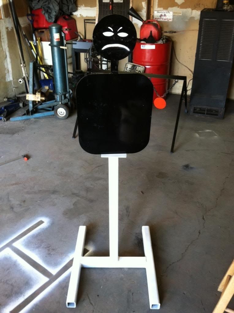

    Wow! $500 for something I made for free! So mine doesn't have a "trap door"...give me 5 minutes with my plasma and welder and it will
    Just some inspiration for some of the more creative shooters out there:
