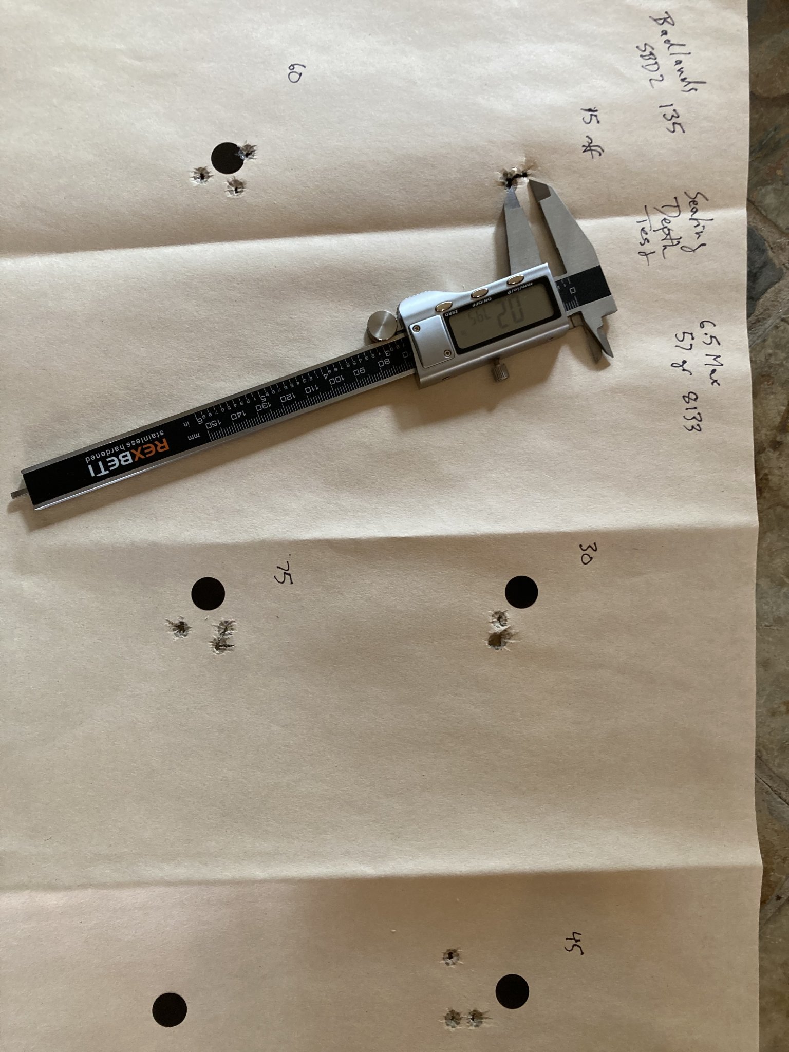

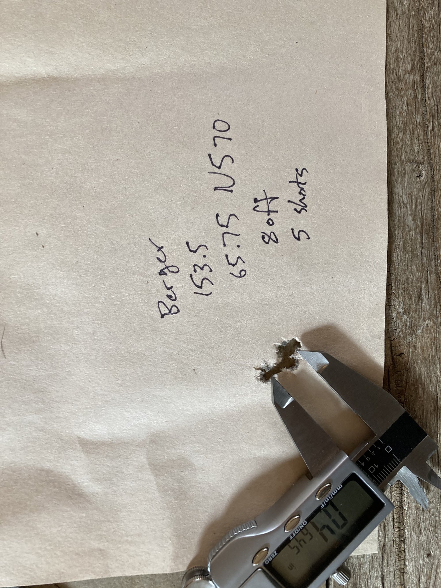

I've just finished some seating depth testing on the 135's out of a 6.5 max, and they shoot. Will be trying the 205's in my RUM soon.
Control group with Berger 153.5's and then the 135's...
