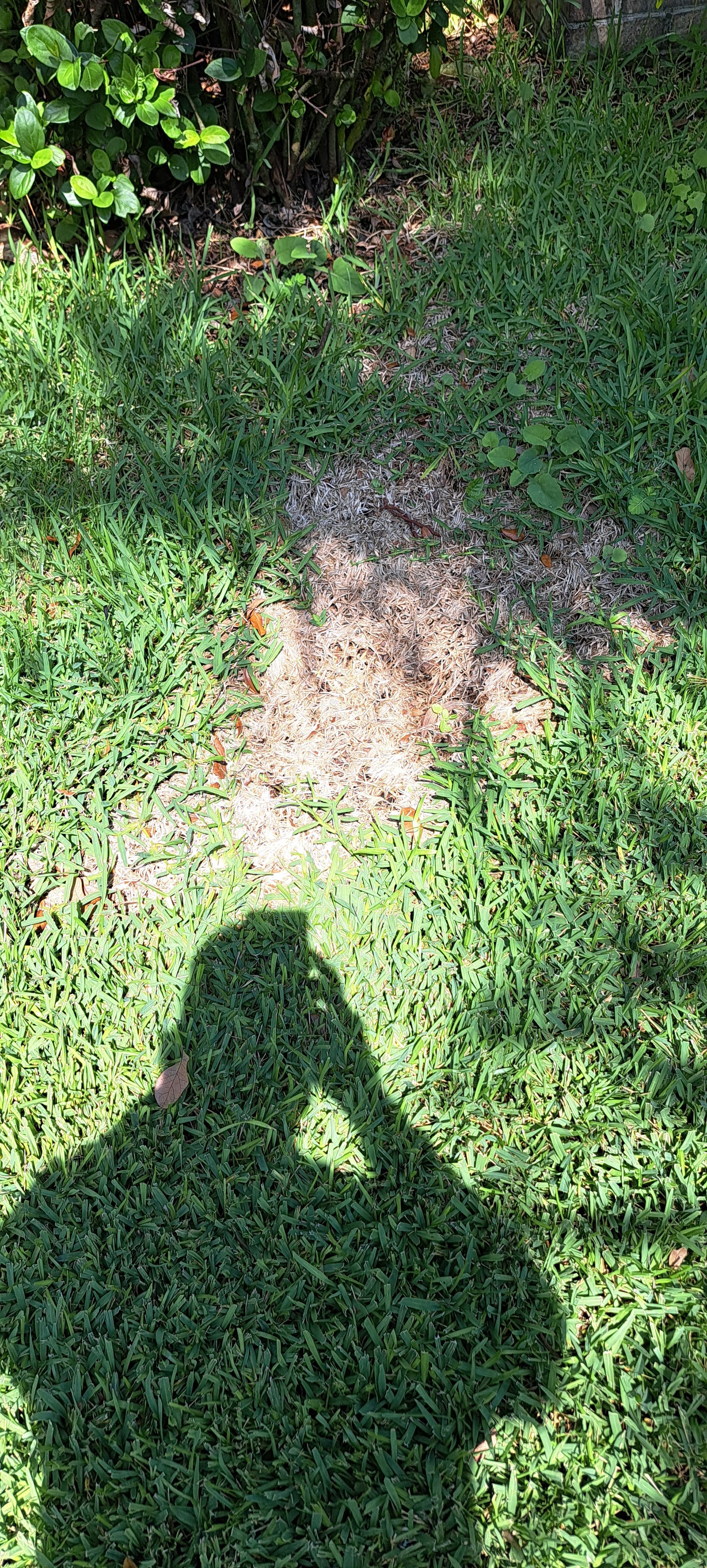

The smell never really goes away.
Here's some spilled water softener salt water from 4 months ago.

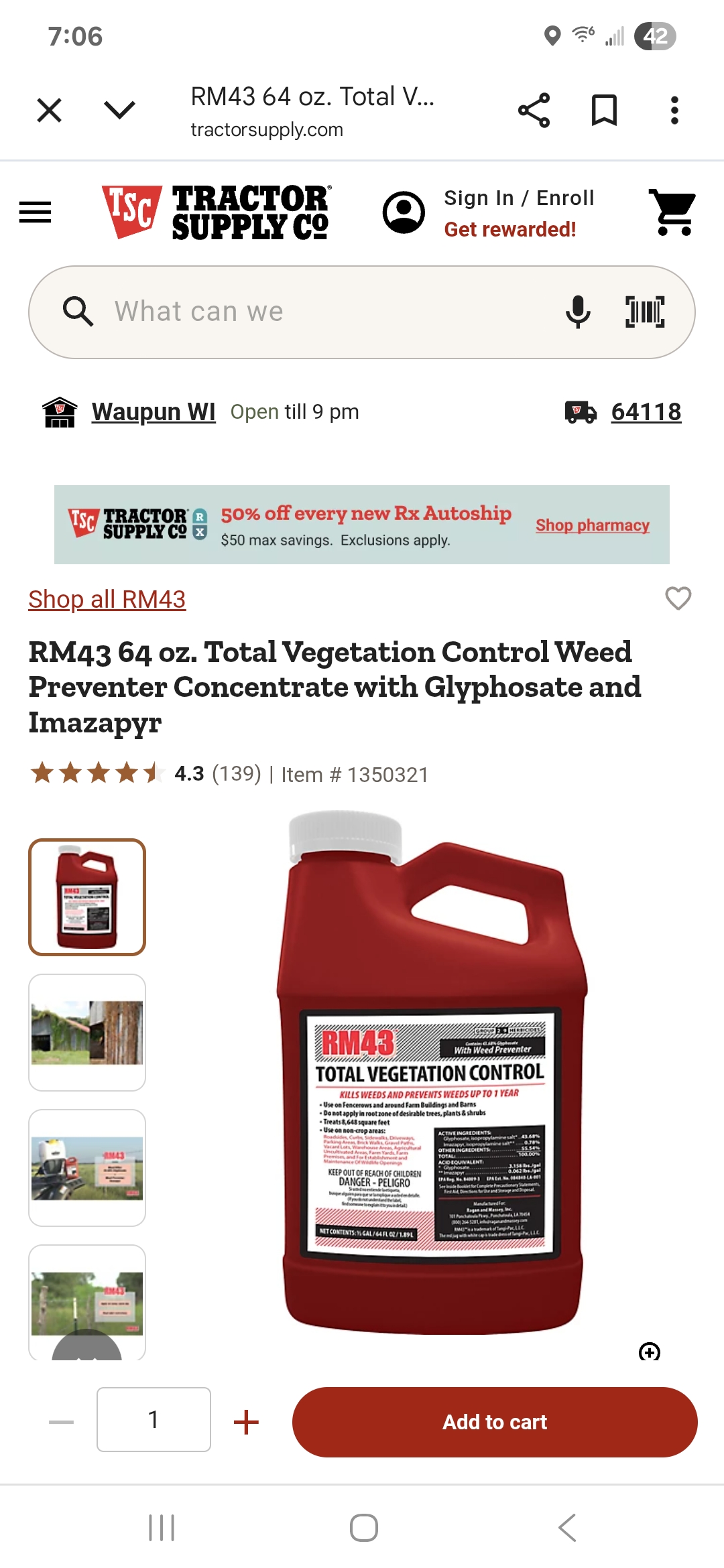

RM43 kills everything for about 4-6 months. I spray my hotwire fence rows with this.
