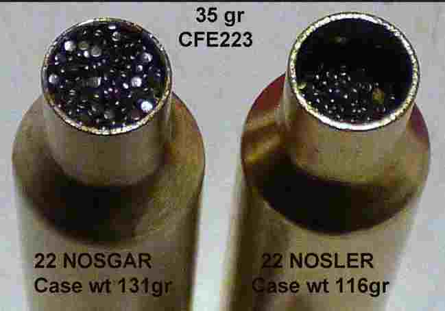

I had a similar situation with 22 Nosler brass and 6mm Hagar brass converted to 22 Nosgar.
The Nosler is the stuff with the rebated rim and the Hagar has a 6.8 sized rim and is much heavier, both in the case head and body.
I started 1 grain less than my 'Special' load and lost 75 fps. A whole grain (about -3%) for this case was too much.
Load was NOT 35 grains.

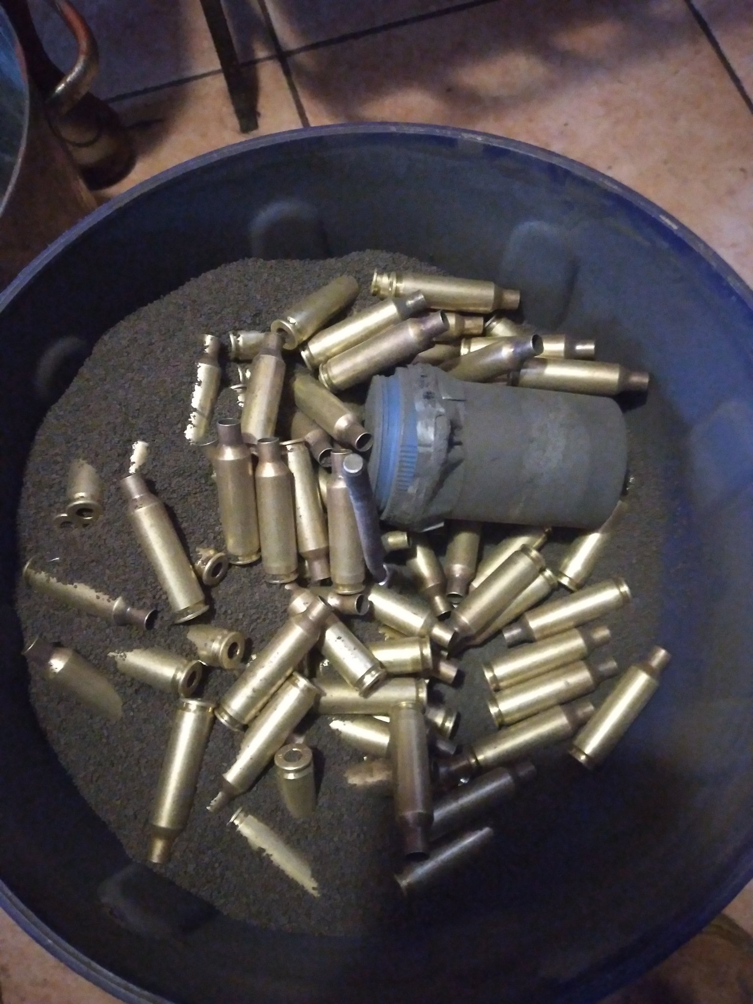

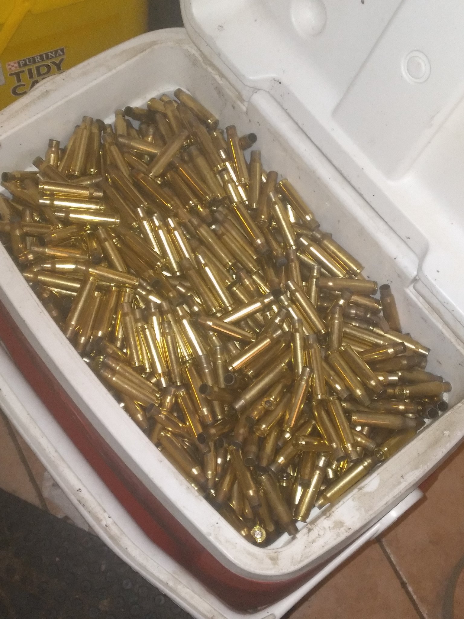

I'm doing 308 brass down to 243 by annealing and resizing to 6.5 first brass is thicker!

Necking it down is just the same for any wildcat cartridge the hat trick is trimming case to length in the case the metal thickness in the neck is a few thousands larger say .004 ,trimming to length first is the best strategy as to ease forming and lessen resistance to drawing the die down on the brass not forgetting annealing and much case lube! Being cautious with the forming as you get the feel! I'm a machinist not a terminology guy
George! Did and came out far above my highest capacity loads 47 gr with clear neck just off a sample of varget so I'm not that concerned with limitation capacity of brass but yes need ladder redone considering the new material!
