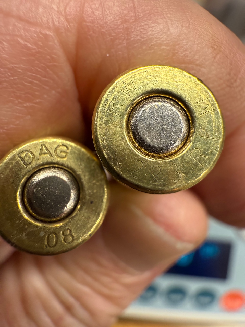

In my RWS brass, I get a lot of DAG marked head stamps. Not sure if they are the same thing or not.
Came from the same bag. Maybe 10 per bag of hundred of the RWS brass.

Anyone know if RUAG and RWS are related?
  • RUAG International:
    Is a Swiss multinational defense company that was the parent company of RUAG Ammotec.
  • RUAG Ammotec:
    Was the ammunition and components manufacturing arm of RUAG International, with brands like RWS, Rottweil, GECO, and Norma.
  • Beretta Holding:
    In August 2022, Beretta Holding acquired RUAG Ammotec, meaning that RUAG Ammotec is no longer part of RUAG International.
  • RWS:
    Is a brand of ammunition and components, formerly part of RUAG Ammotec, and now under the ownership of Beretta Holding.
