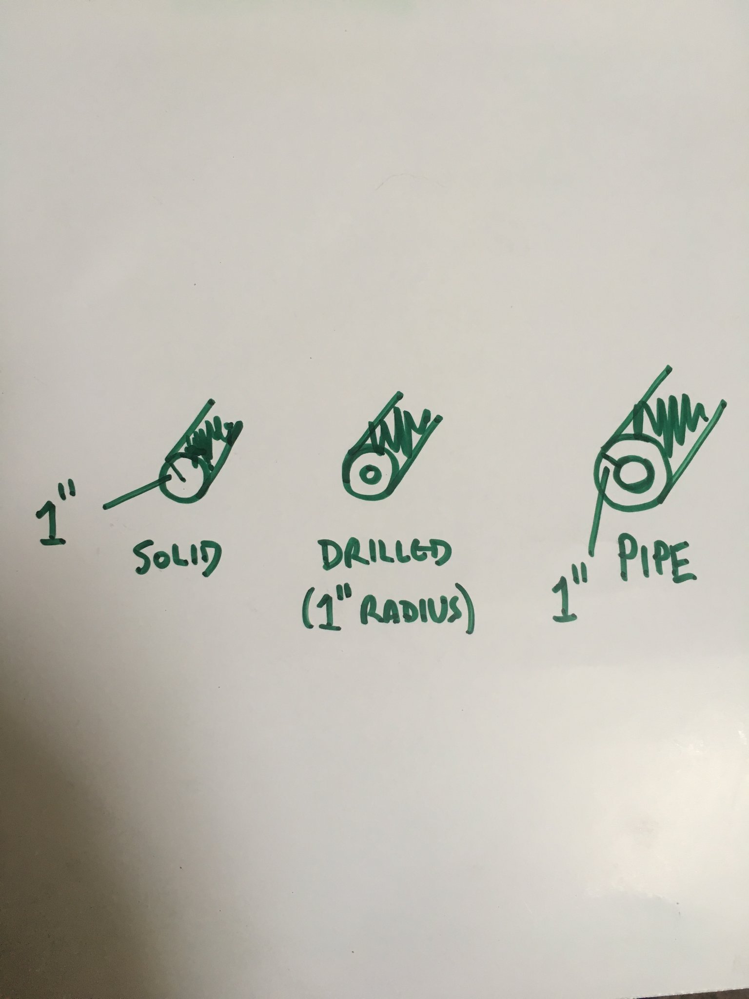

1. I-beams are only most effective in one directional bending stress. Any compression or tension (as you mentioned) is handled far better in a solid beam. The same is true for torsional stress, and any bending stresses in any direction other than the I-beam is oriented. I will agree that I-beams have a higher strength to weight ratio, but not stronger as a whole. Perhaps it is easier to visualize with with a wooden I-beam, versus and 8x8, or whatever similarly sized post.
2. I believe you have agreed with me here? I'm not exactly sure. To be clear, I'm saying that by being more efficient they use less material to have good strength, not more strength.
3. I somewhat agree with this. Yes you can do that and with proper patterns can retain strength, but I don't think you can retain all the strength. With the main key being "in the directions you need it."
4.
The strength to weight ratio is important because a solid beam has to hold up it's own weight. An I-beam holds less weight. This is how it applies to a barrel. Think of a bunch of I-beams configured in a circle. The strength is 360 degrees yet lighter than a full weight barrel. Which in this case does not (usually) reach a span where it's own weight becomes a detriment.

Solid is stronger than a drilled bar with same exact diameter. However, if you reconstruct that solid bar by expanding it into a pipe and maintaining some of the radius as the wall, the pipe will be much stronger than the solid. I realize it is impossible to maintain the 1” wall of the pipe with the same material from the solid bar, but just use this as a guide
I know what is supposed to happen, I just want to put the 2 diff pcs in a press and test, and until I do, no one will ever change my mind, lol

I agree with what you're saying when it comes to comparing a fluted barrel with an unfluted one of equal mass and cross-sectional area, but with the unfluted barrel having smaller diameter. With two barrels of equal diameter, one with flutes and one without, the one without flutes is always stronger. I can understand what you mean with the idea of 360 degree I-beams, and how it seems theoretically it would be stronger, but both mathematically and in practice, the opposite is true.
No its not. A fluted barrel is stiffer than a thinner barrel of the same weight. It is not stiffer than heavier barrel of the same diameter. That is basic physics. Flutes do not make a barrel stiffer. You even posted a link a couple posts up that said the opposite of what you said.
Conclusion: the fluted barrel is much lighter, much less rigid, and has much more surface area than a solid barrel of the same diameter.
Conclusion: the fluted barrel is significantly more rigid, and has much more surface area than a solid barrel of the same weight.

People don't think about it that way, because they usually choose a contour and then decide fluted or unfluted. They don't pick their barrels by weight. That's where the confusion comes from. Definitely not among the stupidest things I've heard. I think some confusion there is understandable.
Perhaps my post is not written clearly enough. The way I read them, my post and your post agree with each other. I believe where the confusion lies is in my last sentence, where what I meant is that, mathematically and in practice, flutes do not make a barrel stronger (when compared to an identical non-fluted barrel).
The first sentence of my post that you quoted corresponds to your second conclusion, and the second sentence of mine to your first conclusion.
Unless I'm missing something major, our posts say the same thing, albeit yours is written more eloquently.
Nope, I just completed misread it actually. I even went back and read it several times, each time thinking it said "the one with flutes will always be stronger." Then i scrolled up more and found your link and thought, "how did he read that and still get it backwards. God damn, reading comprehension is dead." LOL. It sure is! LOL at me.:ROFLMAO::ROFLMAO:
Ahh, I see lol. I was sitting here reading your post and thinking, "Man, I really feel like that's what I said." But I was starting to second guess myself and I read your post about 15 times trying to make sure I wasn't missing anything. Glad we got that cleared up! Lol

And in all that time you've learned nothing about beam mechanics.
As in "Beam me up Scotty" kind of mechanics? I've worked on a multitude of aircraft all the way from single seat dope and fabric up to the 777-200 and 747-400. I have a pretty good idea about beam strength and it's applications.
All I'm saying to that subject is two barrels of the same weight and material, the one with the larger diameter due to the fluting will be stronger. The solid barrel will be stronger overall.

I had to read that about about ten times, to get it. Yea, Two barrels same weight and material, the fluted one will be stiffer because of its larger diameter. A non fluted barrel ,of the same diameter, would be stiffer but heavier than a lighter fluted barrel of the same diameter.

I get it. Every mechanic in the world thinks they don't need engineers. Call me when you get hired to design structures that peoples lives depend on.
I didn't design the shit. I just work on it and see it. And believe me, if there is one industry that always trying to get lighter, it's aviation. Per your prior post, I would think you would know that.
BTW, I'm here in the land of engineers...MTU. Yah, we need engineers, cuz a lot of people around the world think stuff just invents itself.
The funny thing here is that once your barrel is strong enough (very thin pencil profile), strength doesn't matter. Barrel whip is what you're trying to control and that's determined by stiffness, weight and the speed of your bullet.
If I had to guess on tensile and shear strength, a fluted barrel would be weaker than a cylindrical barrel of equal weight because fluting has more surface area and crack propogation always starts at the surface. Compression strength might be better for fluted because skinnier beams are easier to buckle.
The design of high performance structures is not terribly complicated but it's not immediately obvious to most people who are trying to do it...
