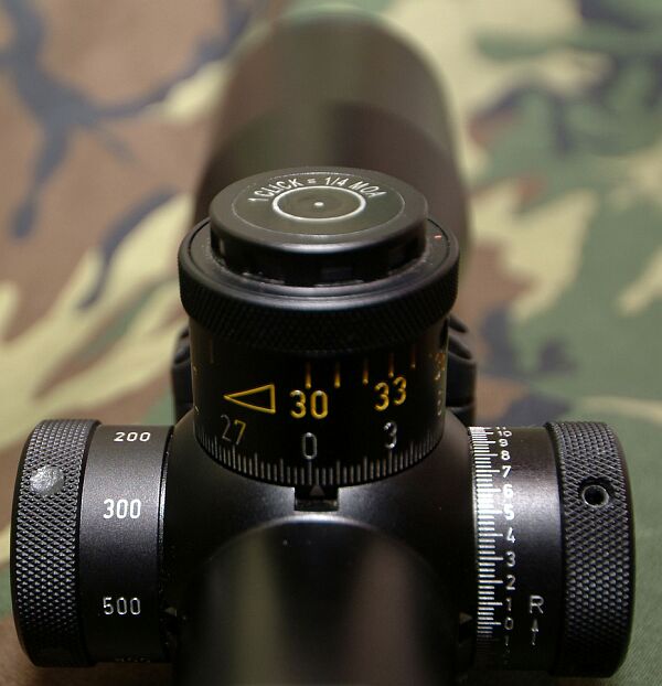

S&B dual turn knobs have 30 MOA per turn in 1/4 MOA.
